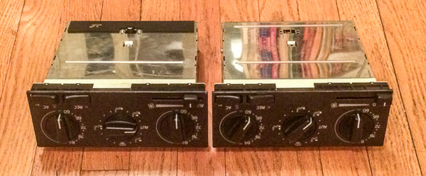

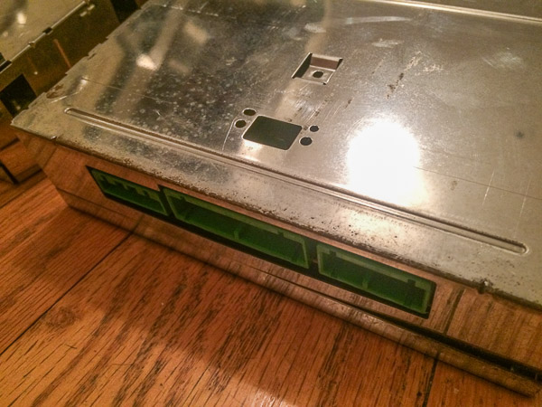

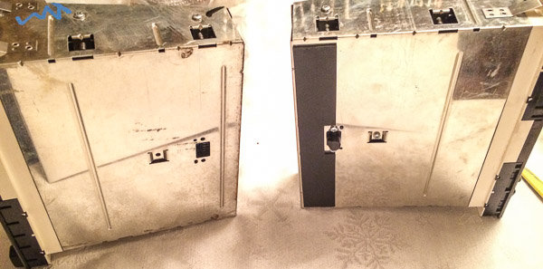

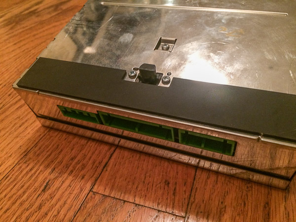

One curious thing is that I thought there were only two types of climate control units, ECC or manual (with 4 fan positions etc). The one for my 850 is the ECC, but I noticed on the replacement ECC that wouldn't work, it had a small button on the bottom that my original one didn't have and a strip of black plastic. The button is just a small plastic piece that could push in to the ECC base (see photos). The second replacement I got didn't have this either (and that one worked in the car.)
Does anyone know what the button is far? Is this unit not compatible with the 850 ('95) model?

- ECC on left has black button

- close up of button on base of ECC

- ECC that was originally in my 850

- 20160602_ecc_005.jpg (89.13 KiB) Viewed 1018 times

Probably a support to stop from touching the stereo head unit, perhaps ground loop prevention?
It doesn't look terribly important
