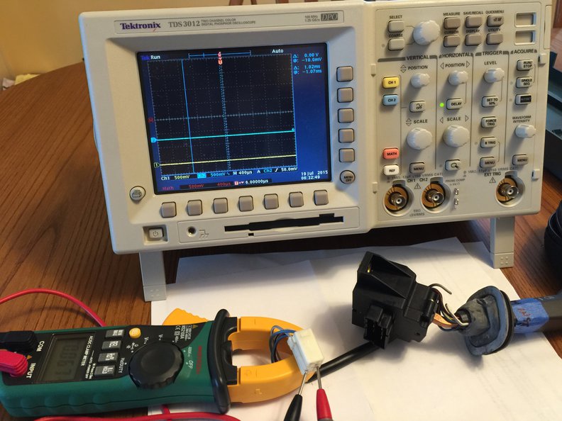

Analysis of the cruise is beyond the scope of the novice mechanic. I needed sophisticated equipment to troubleshoot minezhenya wrote:I presume you verified this somehow in your testing, but just throwing out there that the wiring in the signal switch often breaks clean in these cars. I checked a bunch of other stuff in my '98 before peeling back the rubber boot at the stalk near the steering wheel where the broken wire was as obvious as could be.

Show off with the fancy equipment!!
What I need to get is a variable voltage supply to test parts out of the car.
