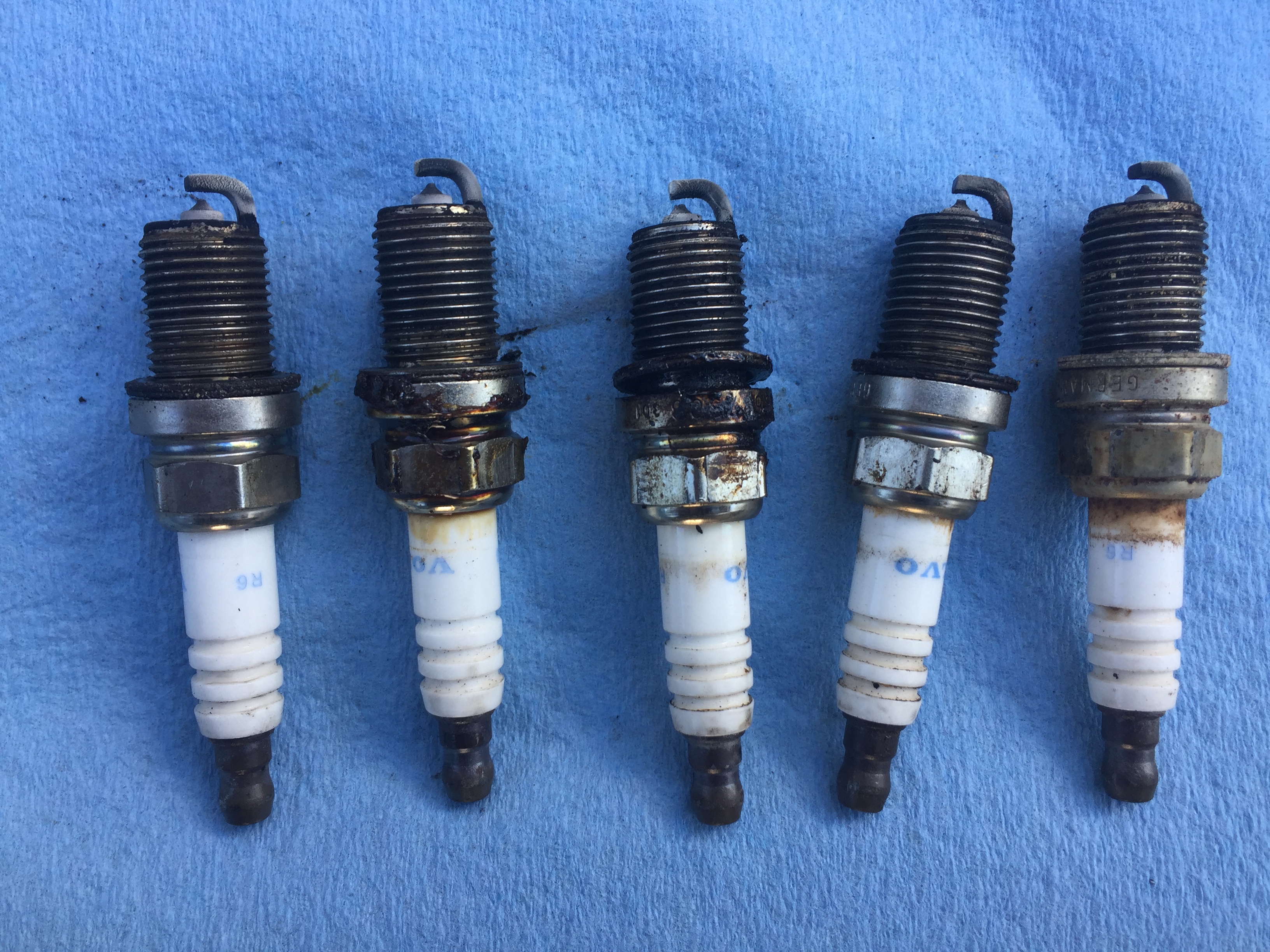

Thanks for all the help and advice, folks. I put new plugs in this morning but I still have the same problem: misfire on cylinder 4 at idle only, runs beautifully smooth above 1000 rpm's. Even though the injector sounded normal, I have a hunch it might be the culprit. I'm heading to harbor freight now to pick up a cheap compression tester so I can check that as well. Here's a pic of what 16 year old plugs look like, by the way...

You can swap injectors around too, that's what I'd do after the compression test. Be careful with the rubber seals so they don't tear, they are also 20 years old.
Plug #4 isn't wet with gas or washed clean from lack of firing, or washed clean from a coolant leak, still at this point you gotta just hope compression is OK.
