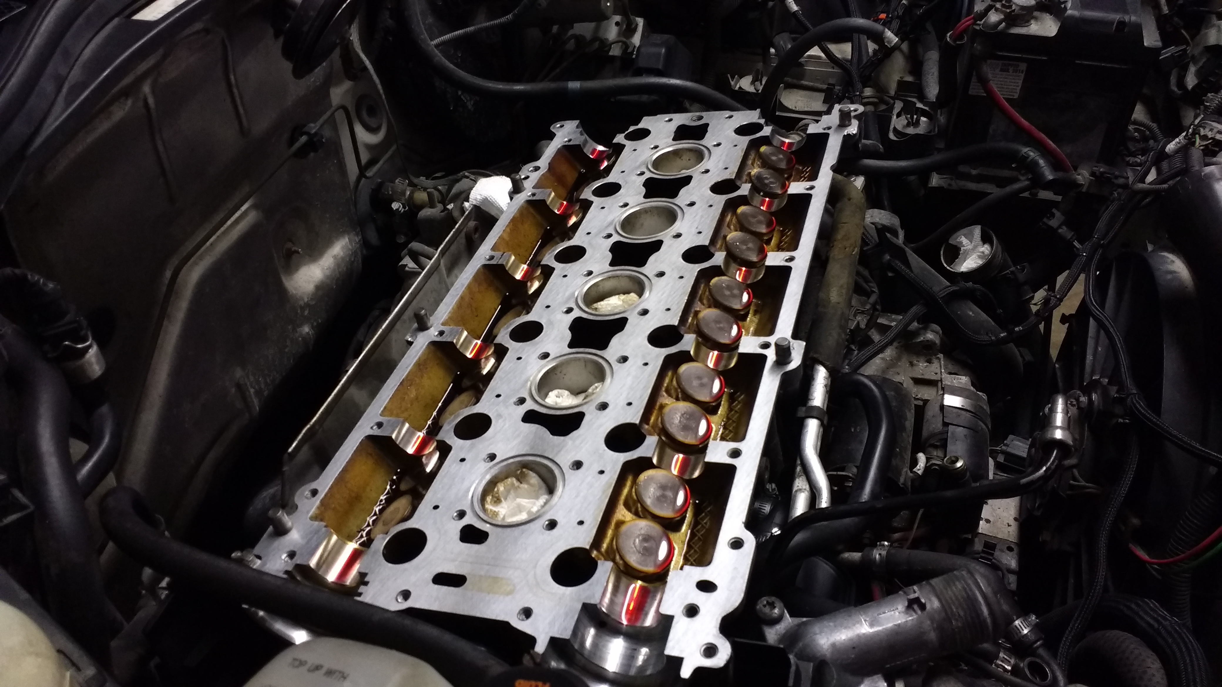

My NOV 1998 build T5 has hydraulics...I think. I definitely get tap-tap-tap ...silent on startup - is that a good diagnostic??j-dawg wrote:Lifters change from hydraulic to solid, and valve stems from 7mm to 6mm, at engine 1817653 for T5s. I think that's pretty far into the run - my Dec '98 T5 has engine s/n 15xxxxx.

My cousin's T5 must have hydraulic lifters if yours is a 12/98. I think his is 7/98, but I'm not certain on that. It's 100% for sure a 1999 MY. His lifters are INCREDIBLY noisy. It never goes away. Luckily you can't hear that bad now unless the hood is up, his little muffler bypass is pretty loud.

Dang, really? All these 99s with noisy hydraulic lifters? I've never heard my lifters, except a few times during the polar vortex in early 2014, when it was absurdly cold out and I still had summer oil in the car. Otherwise my injectors are much louder.
