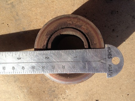

So, 96 GLT sedan n/a bought after some kid put a clutch in wrong and it wouldn't release all the way. Thought I would find a bent clutch fork but instead the throwout bearing was punching past the ends of the spring fingers. It looks like the wrong one maybe because it seems to be just barely bigger than the hole in the springs. Ordered the FCP bearing, plate and disc as a set.
On the pilot bushing, there is no way the input shaft is going in the hole in the bushing as the hole is too small and there is no protruding nose sticking out past the splines like I am used to seeing on others. The flywheel shows signs of hot spots. In my goat the bolts could be re-used and it would be an automatic resurface or replace but for the small amount of torque this thing sees plus the cost of new bolts (plus the RMS is dry as a bone) I'm thinking of leaving it alone.
