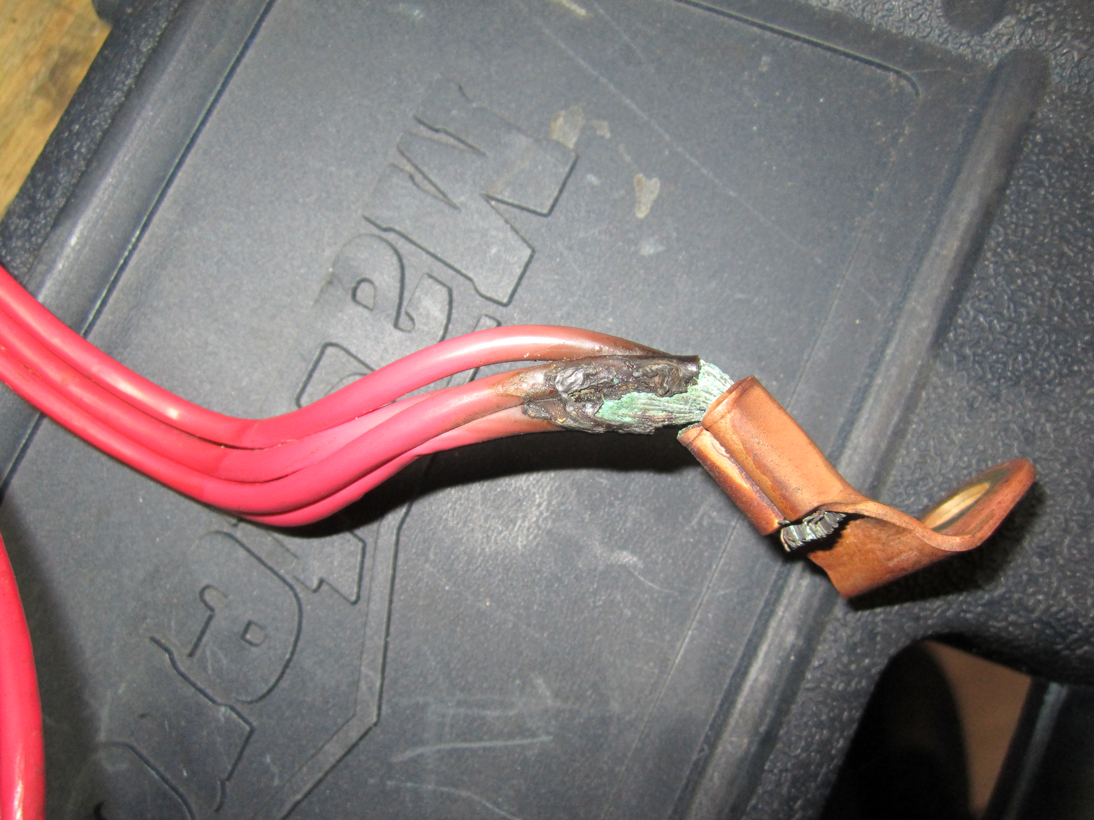

- Posts: 36137
- Been thanked: 4064 times
That's still a lot of voltage drop, 0.5 volts?

- Posts: 15482
- Has thanked: 2197 times
- Been thanked: 1850 times
Take the cover off the main kidney shaped fuse box in front of the brake booster. Look at the brass colored nut at the front of that attached to the 'B+" cable. If it is not bright and shiny then it is failing. This issues affects 99/00 models most. When I removed mine it had totally melted and could easily have shorted to ground. When that happens the worst case is the car will light up!
After replacing the car started more easily and didn't crank as hard.
