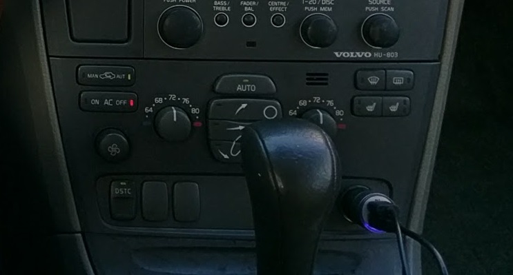

I am looking to Borrow or Buy a ECC for my 2003 V70 T5. I have a CCM-000C error code that I have confirmed is in the Module (motor works on another plug). I've also confirmed via VIDA that the knob does tell the computer to change... there is simply no output on the blue line to the pass damper motor.
Does anyone know something I might be missing?
Here is what I'm looking for...
CCM Module - DSTC - Heated Seats
I know it's in multiple cars but I couldn't tell you exactly which ones. Hoping someone has a spare or a pull that they'd be willing to part with or part with for a short term to help me confirm the issue (I'll cover shipping).
Thanks in advance!

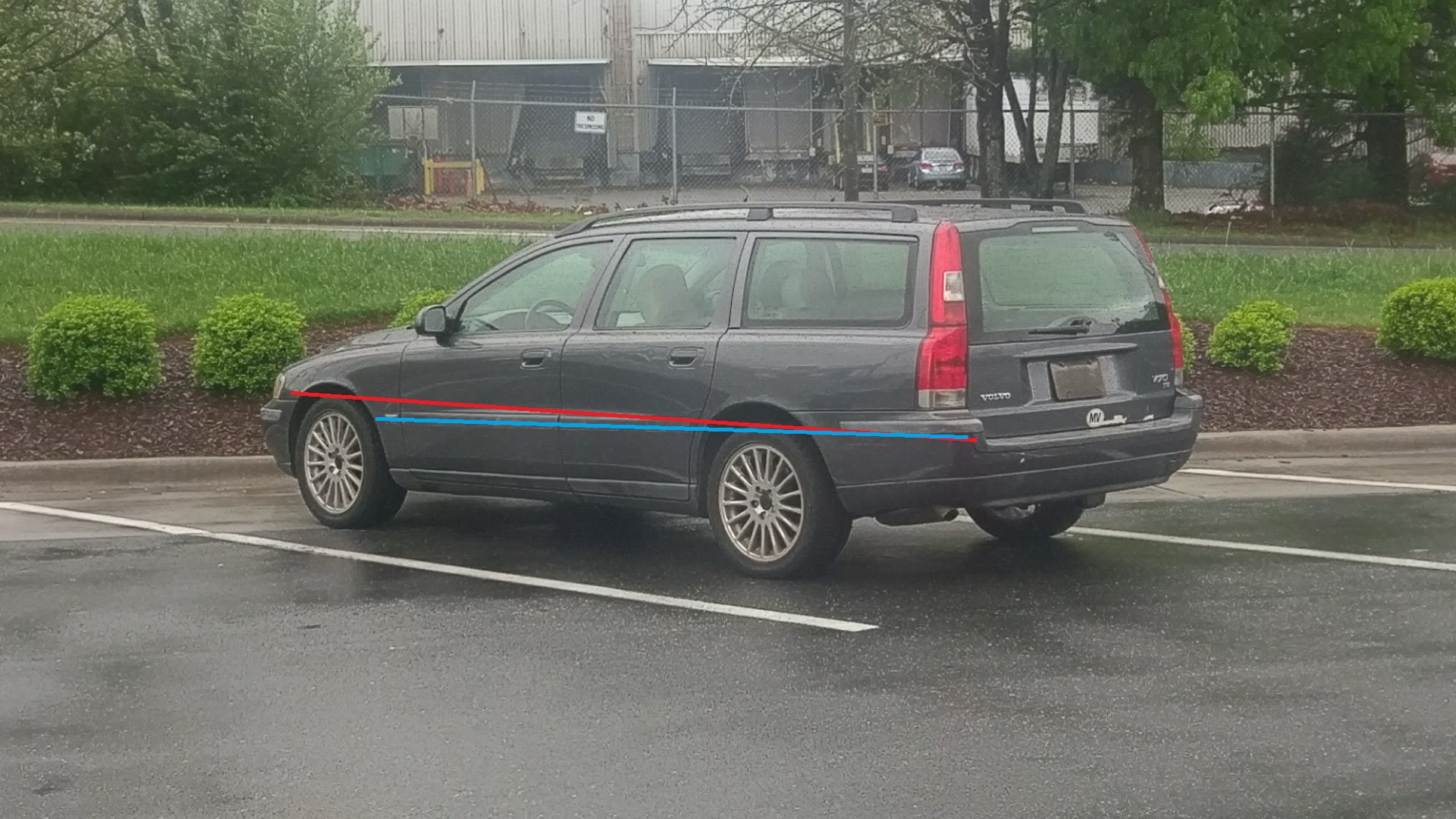

Now that some of the bigger problems I was facing (Trans... ABS... DSTC...) are a fading memory, I am turning my focus onto more aesthetic issues.
I was walking up to Sven (GF named him) the other day and noticed that he looks like a throwback to 70s muscle cars with a severe nose down rake.
I realize that the perspective in that pic is a little skewed, but you can see that the rear is a whole lot higher than the front. It is not this way on my 98 v70, but I do not know if it has been molested. I have looked at user photos but it's hard to gauge with the context of the cars condition. There are not too many OEM photos to look at either.
So is this rake normal? H&R (an most other suppliers of sport springs) state a 1.2" drop FRONT & REAR. If I do that, my front will rub and the back will look about normal?
Is there something going on with this car that I need to correct 1st or is this just a 03 V70 dilemma? Nothing looks out of place in the rear, but I've only just had the tires off... no detailed inspection.
