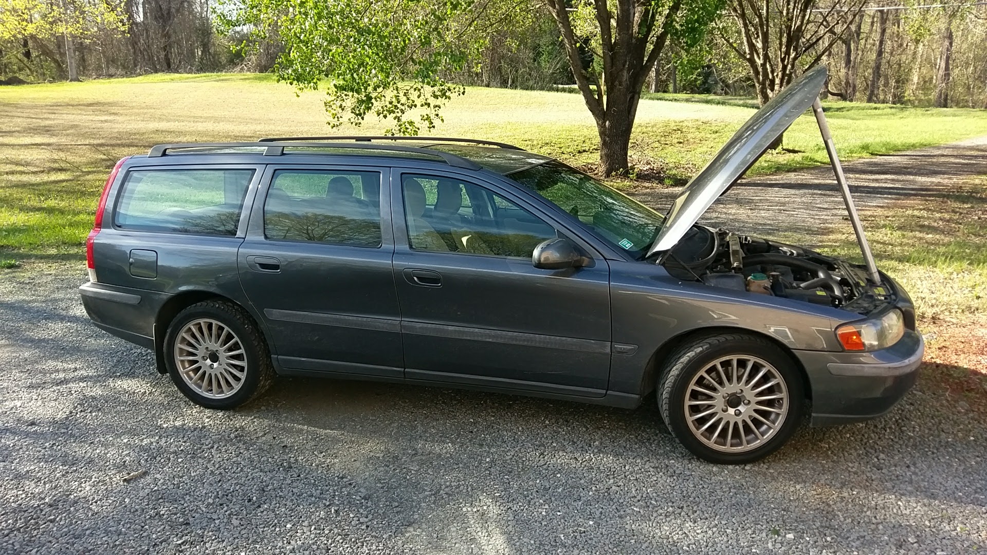

So one with the show.... Here is Sven (GF names all her cars and named mine before I could even say no!)..
Cheers!!
yes, new hood props were already on the way!

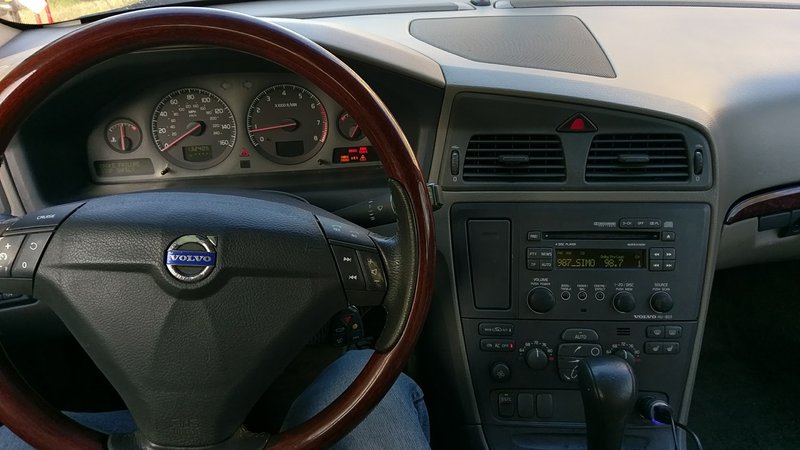

With cup holder...
With cup holder...

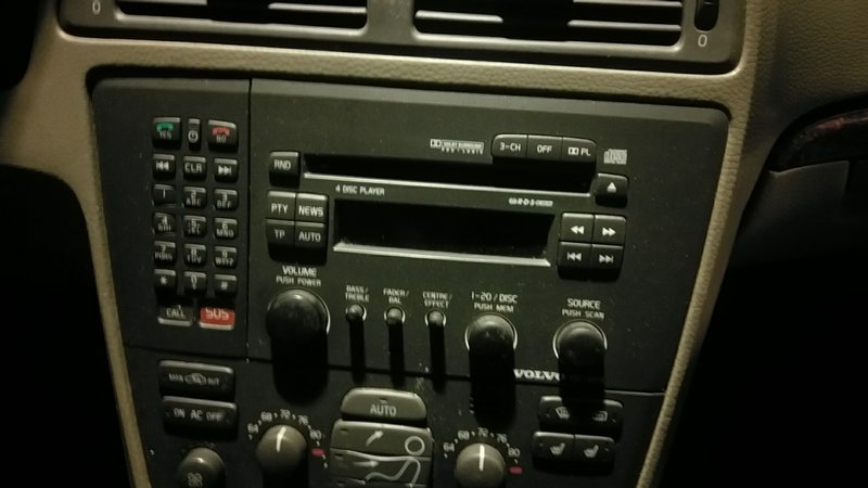

... without cup holder!! OEM Cell Phone!

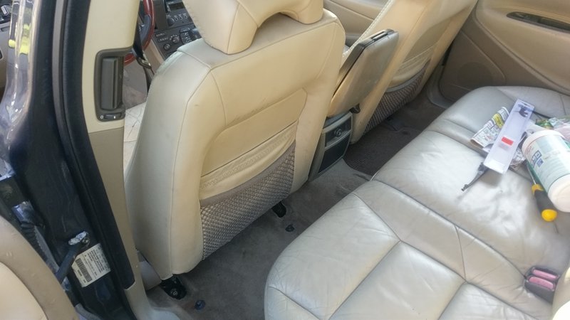

LOTS of pockets now!
