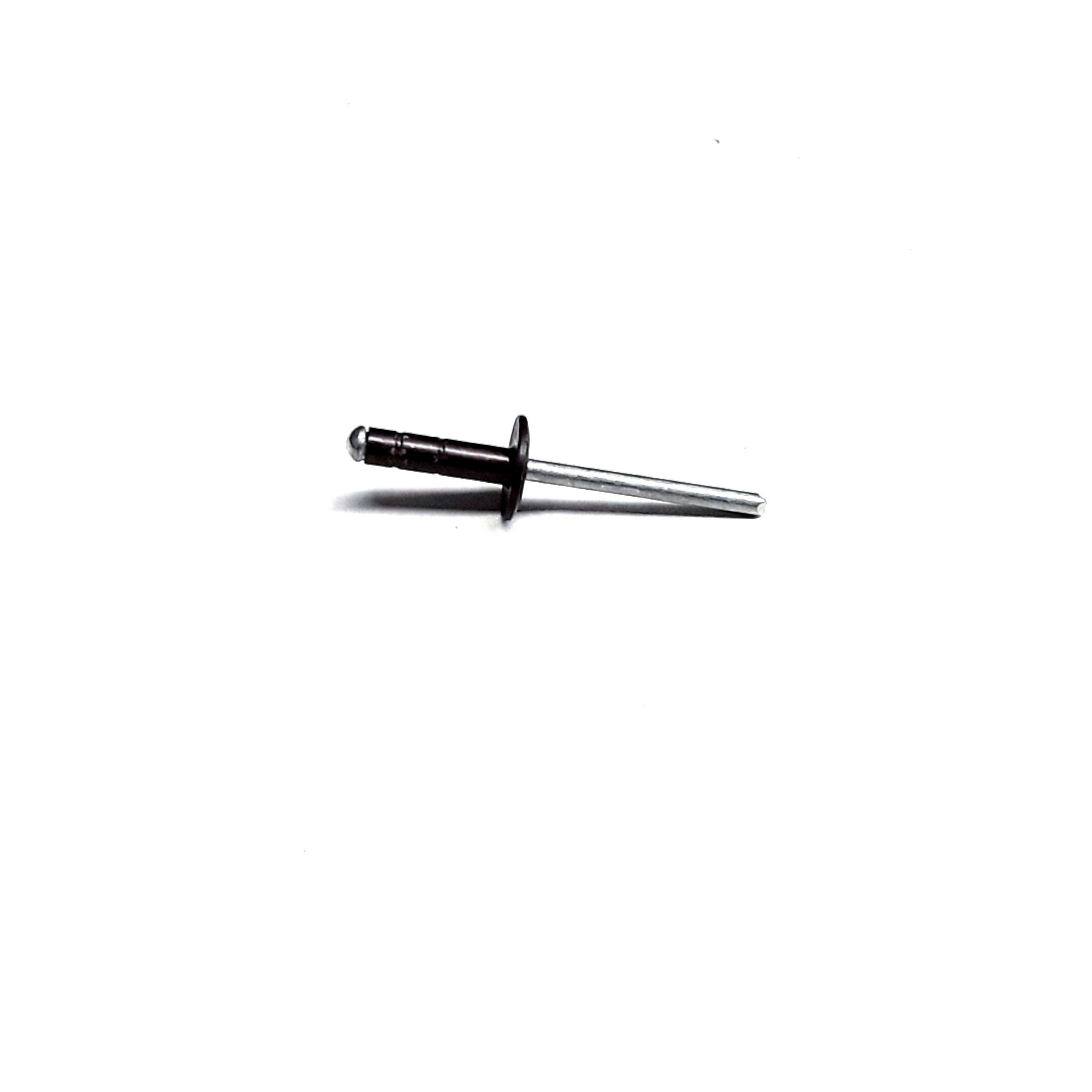

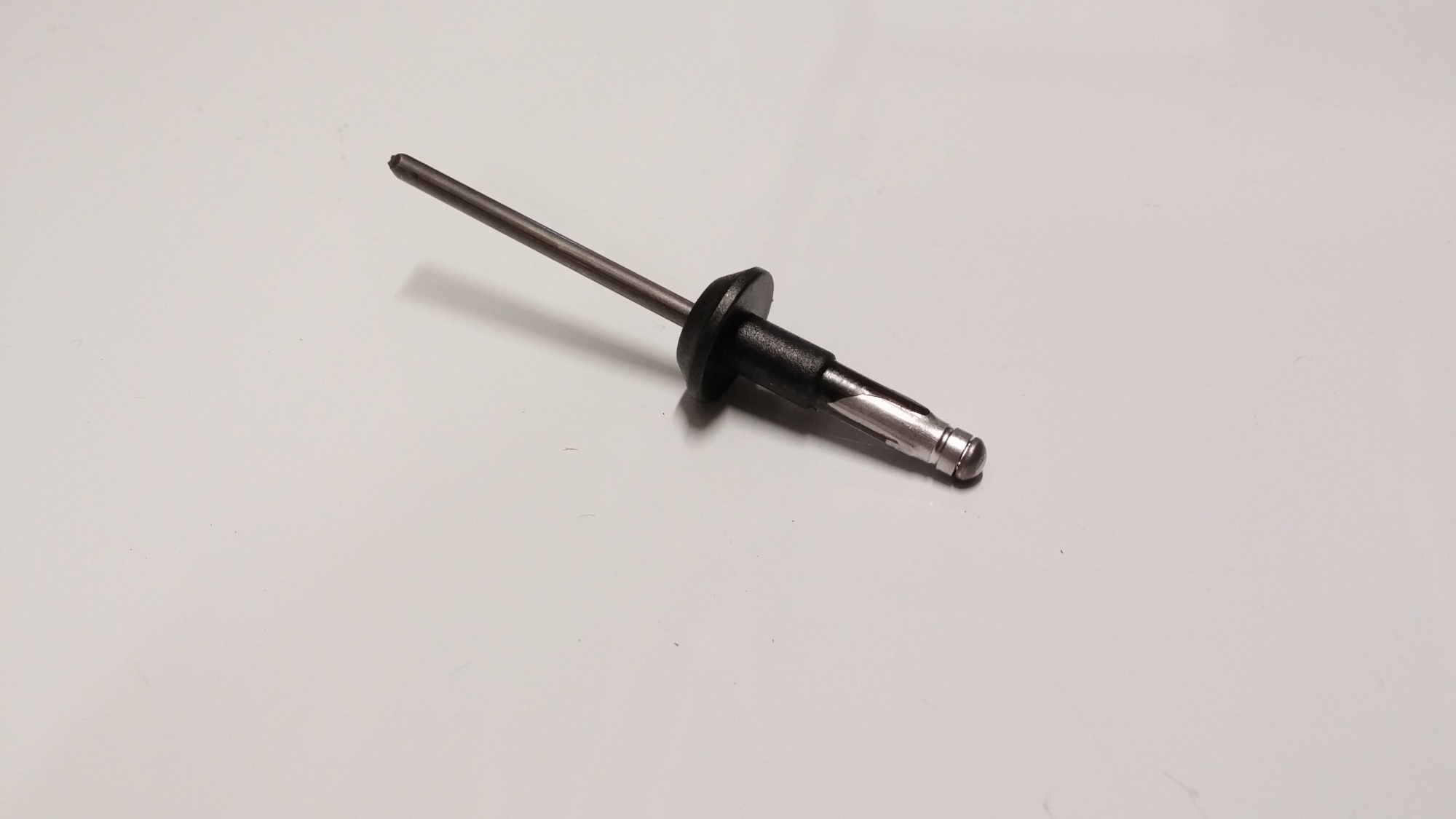

Okay, so I'm preparing to go after the secret EVAP valve and it's hose which is hidden behind the liner in the left fender. I looked at the parts diagram and realized that there are different part numbers for the fender and mudflap rivets. The top picture is a fender liner rivet(PN 979878), the bottom picture is a mudflap rivet (PN 975607). I've been unable to identify a non-Volvo equivalent for the 975607. I have a dozen or so of the 979878 style non-Volvo rivets, which worked quite well on the bumper bracket job I did a few weeks ago.
Apparently the 979878 have been used successfully for mudflaps? The picture of 975607 looks like a black painted all metal rivet which does a similar kind of jack nut style expansion like the 979878.

I only use the upper rivet for mud flaps and the fender liner. Never seen the lower one used on a P80, but that doesn't mean it hasn't.
As to how bad if you use regular rivets. Bad enough to bend the fender from the headlight to the rear edge. It is not easy to fix either as usually the fender lip gets kinked as well.
There are aftermarket suppliers of these rivets that work and look identical but not at the Volvo price!

I dug out my box of rivets to see if I had enough and noticed there was an URL on it:
https://www.auveco.com/
They have a huge selection of specialty clips and rivets. No online ordering, but once you have part numbers it's easy to track things down. These things they're selling as "GM wheelhouse liner nuts" look identical to the Volvo ones:
https://www.auveco.com/hni-2/gm-wheelho ... -nut-25221
This is the kind of stuff we may have to 3D print if/when we can't get it anymore.
