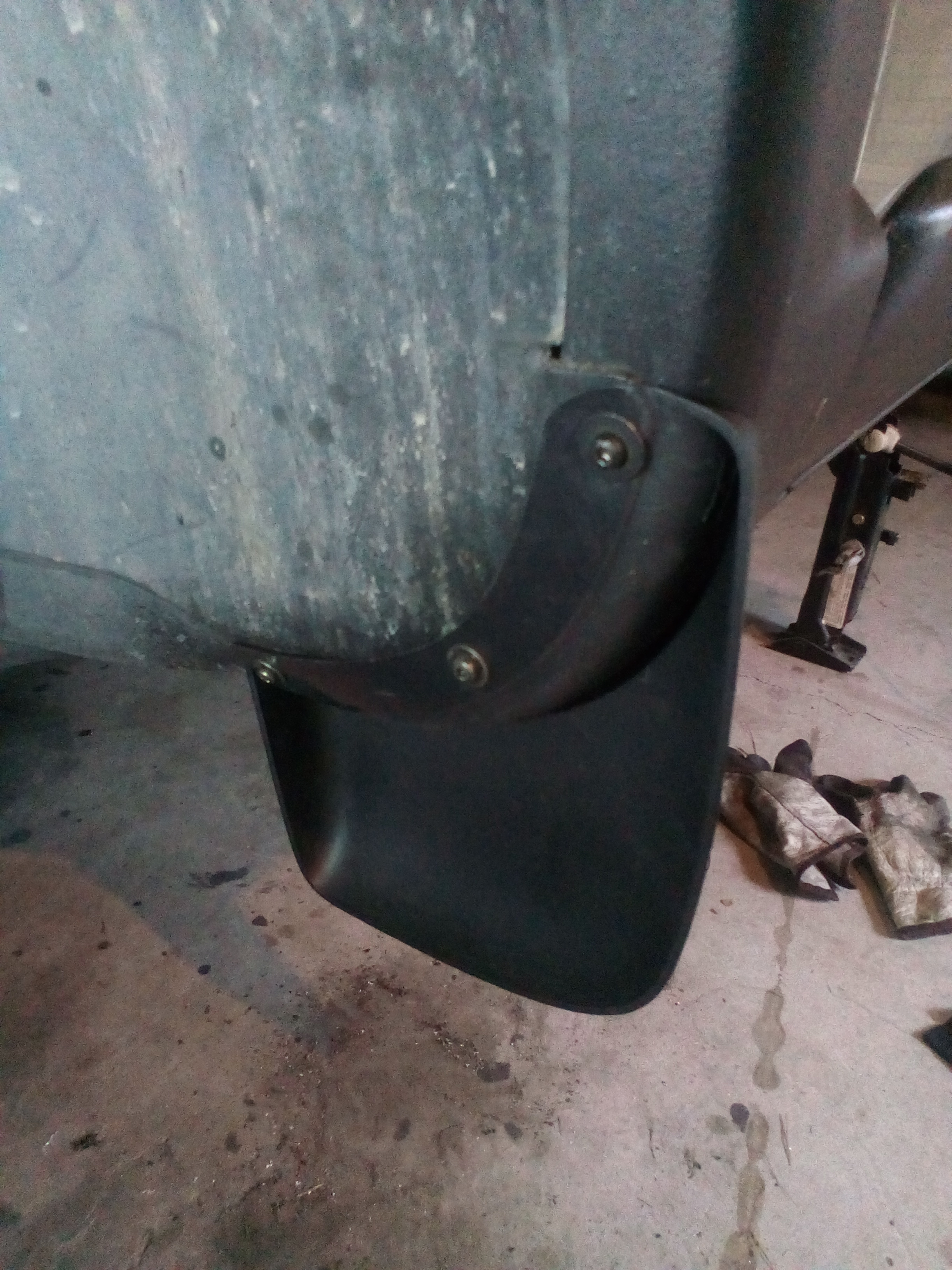

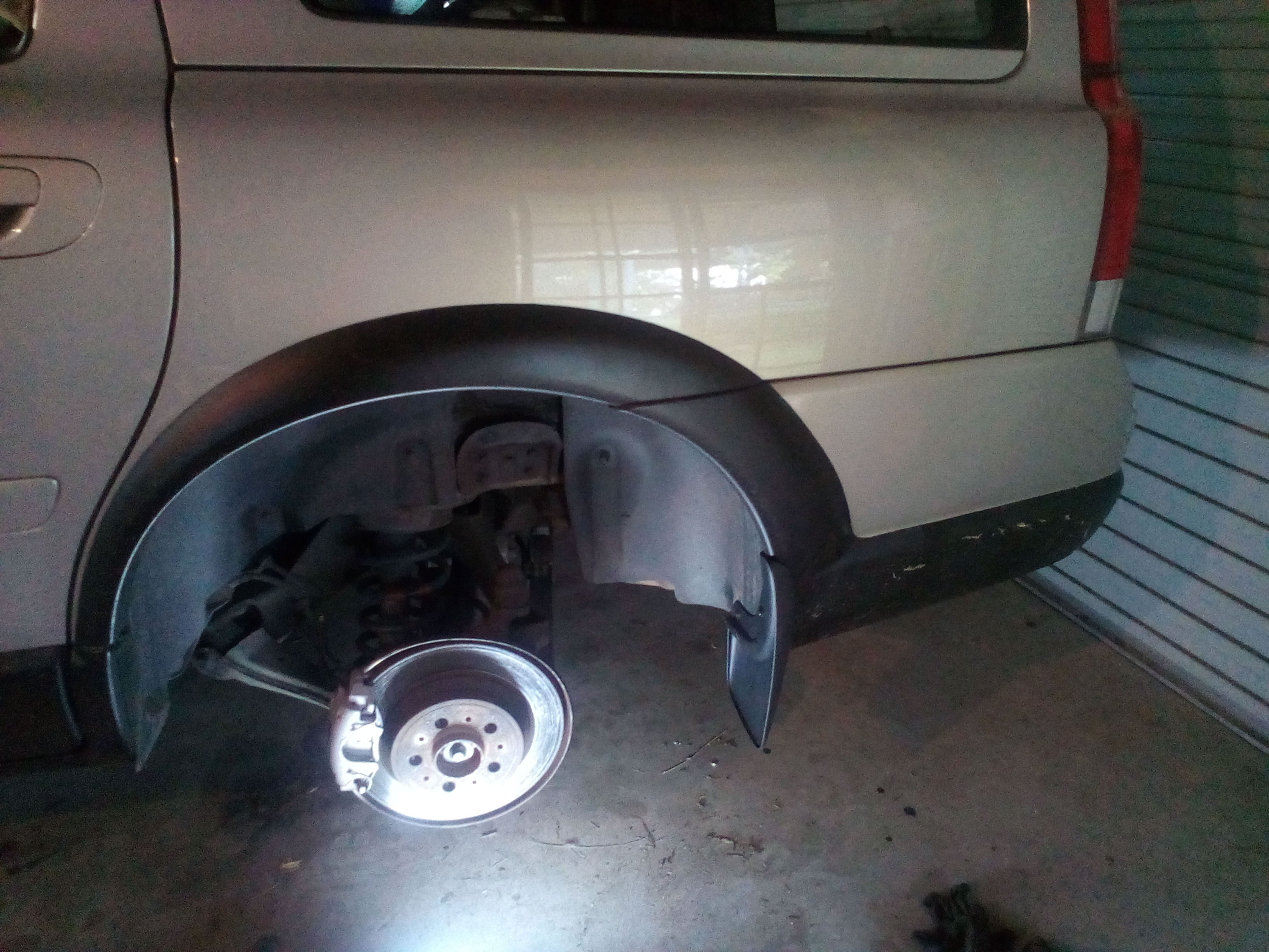

Mudflaps on my XC70. i think it came with the volvo rivets but i decided to use volvo self tapping screws with the metal clips because i can remove them easier. either way i recommend using washers.

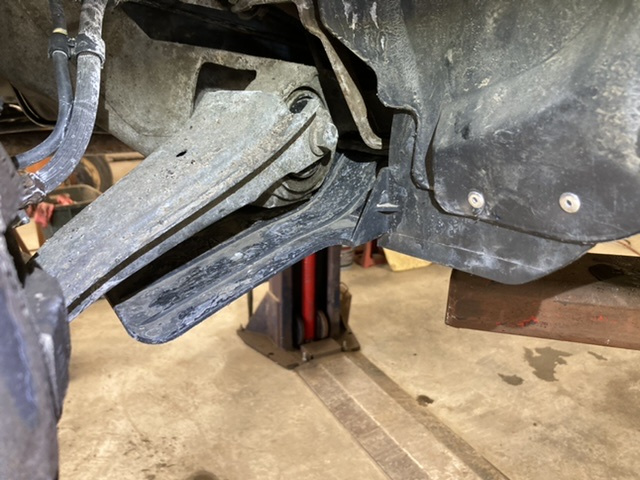

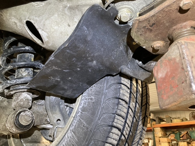

Recently, in an attempt to mitigate the accumulation of snow in the rear wheels I have been installing these “dirt deflectors”, as Volvo calls them. It’s super vexing to me to drive through snowy conditions (that part I love), park, then begin the next days drive & instantly be greeted with both rear wheels out of balance. For those who don’t live in a climate such as ours, snow accumulates in the rear wheels. When you park, heat coming off the car melts (somewhat) the snow. That slush then moves to the lowest point and invariably freezes. I keep rubber mallets in all the cars for this exact reason; so the driver can stop the car and “shock” the wheels with a couple blows. Usually between that, and fishing the handle around between the spokes, you can free the rears of their wobbly countenance.
Anyhow, I saw these in a microfiche a few weeks ago & figured they’d be worth a shot. For $10ish USD per deflector, couldn’t really go wrong. Install is very easy, but you do need to drill 1 hole per deflector.
Since installing them, we unfortunately haven’t had much of the frozen precipitation I was hoping to test the flaps with. We have had a few dusting a of a few inches, which I suppose is enough to count for something. I don’t think I’m making it up, but I haven’t seen much, if any, accumulation since installing them. I do believe they could be in harms way if you are avidly traversing rough terrain.
