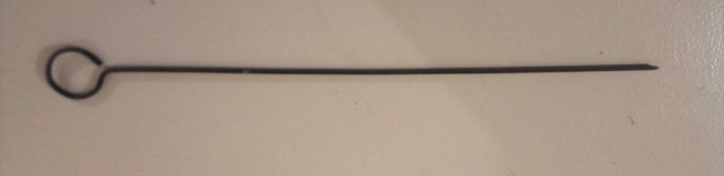

Drilling the transmission in the right spot is certainly an option. I would be using a small hole of around 12mm which would be big enough to allow a stiff wire to go up through the inlet of the filter and thrash around inside the filter to loosen anything that is set in clumps. In fact I have the perfect kebab skewer with a pointed end for this job in the kitchen draw.
I'm tempted to break apart the screen as best I can as this is undoubtedly where the most blockage is situated.
I am getting more and more excited at the prospect of trying this. I would drill the outer housing case that contains the bell housing instead of the inner one as it's more easily replaced if I botch it up. To get the aluminium filings from drilling and thread creation out I would use some trans fluid; most should come out of the drain hole which is close by.
A Magnefine filter upstream will catch any more pieces left behind.
All I then need to do is tap a thread and fit a bolt to seal it all up.

"genius and crazy" are very close. This idea is right between the two. I would use the white Thread sealer on the plug bolt which is for hot oil like transmissions. Not sure which housing part you mean but the main factor should be the you want as straight a shot as possible to the filter and hopefully it can drain out from that hole too versus having all the gunk circulate then drain or get to the magnifine. The gunk can ride on the skewer out the hole if it is in a good spot. Might need a medical degree for this type of surgery.

Precopster, keep in mind that no magnet is going to grab the aluminum shavings from drilling. The paper element in an inline filter will catch it, but at that point it has come through the filter pickup, and through a portion of the valve body.
It is possible you could drill and puncture the mesh enough (or use a hook and pull it out) to render it ineffective. At that point you rely on the inline filter, but at least that is external and easily replaced.
