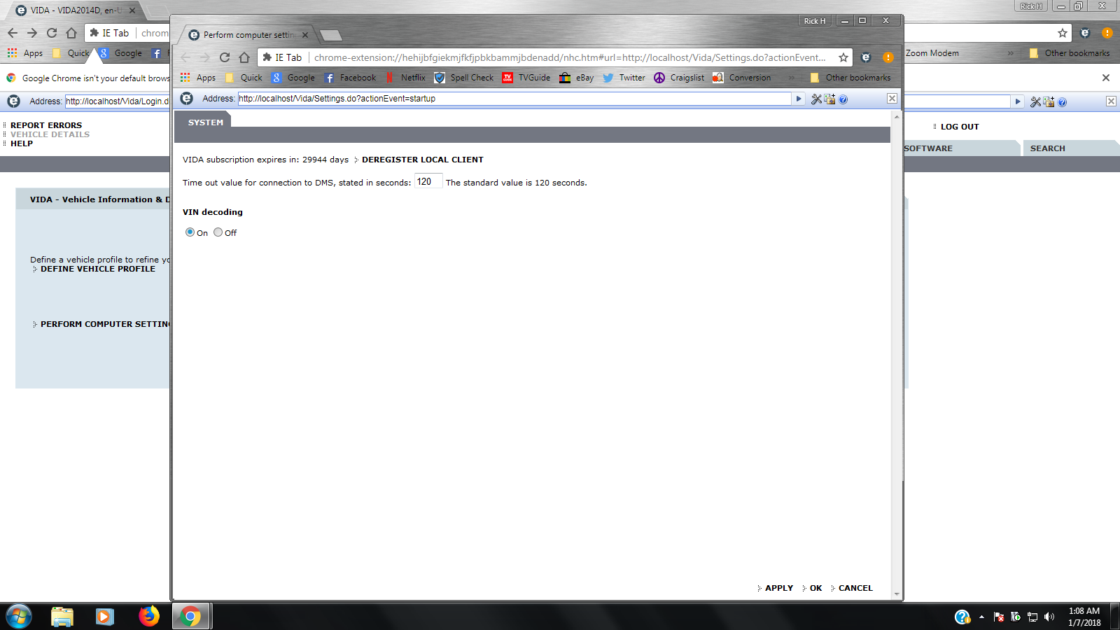

To check the subscription. Go to the Start tab, click Perform Computer Settings. Top line on page.
Yep, The image below is Vida 2014D in Google Chrome
The Machine has Windows 7 Pro 64bit, Athlon X2 64, 3GB Ram, IE11, .Net framework 3.5 and 4.7.
No conflicts.
