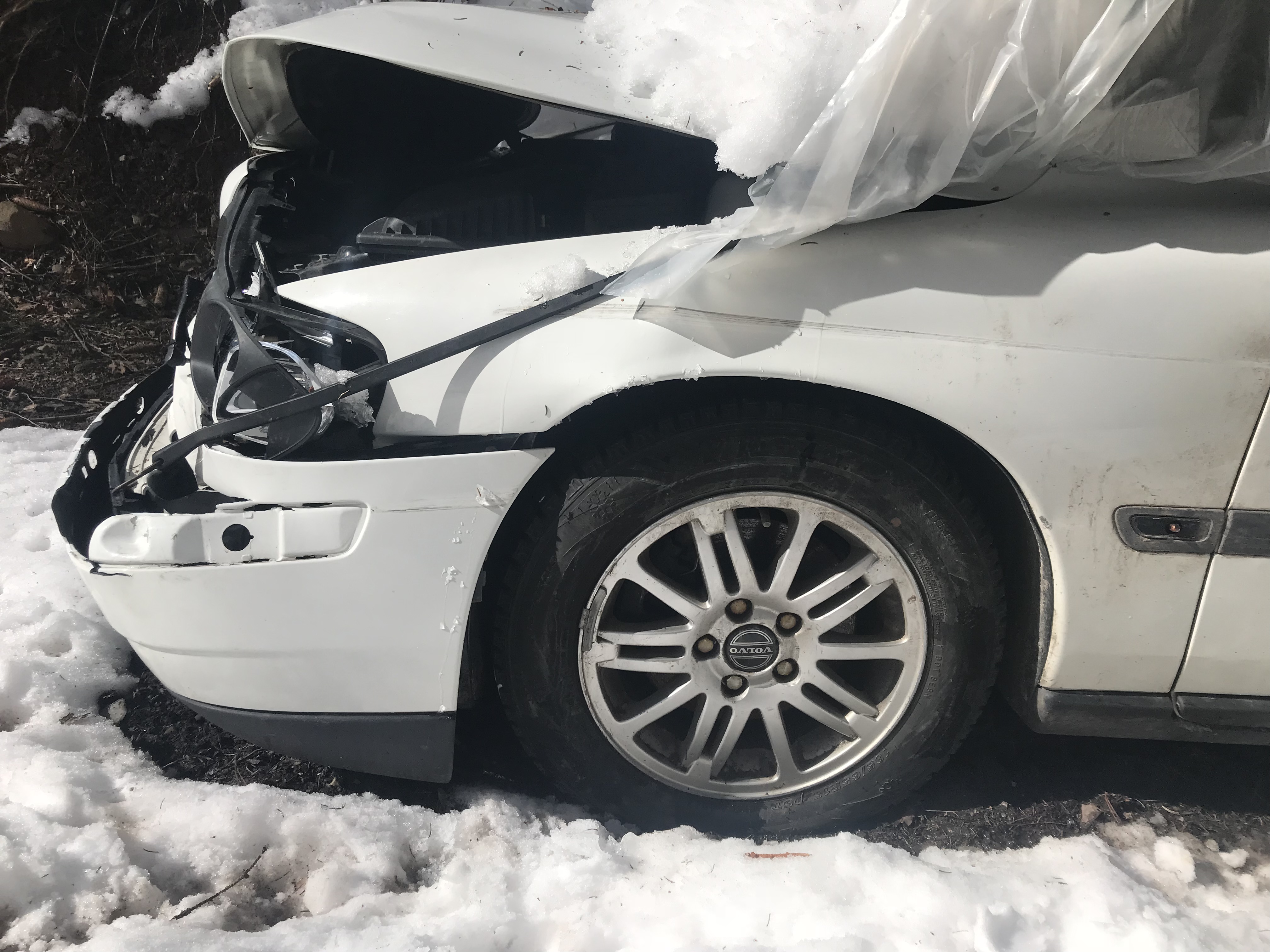

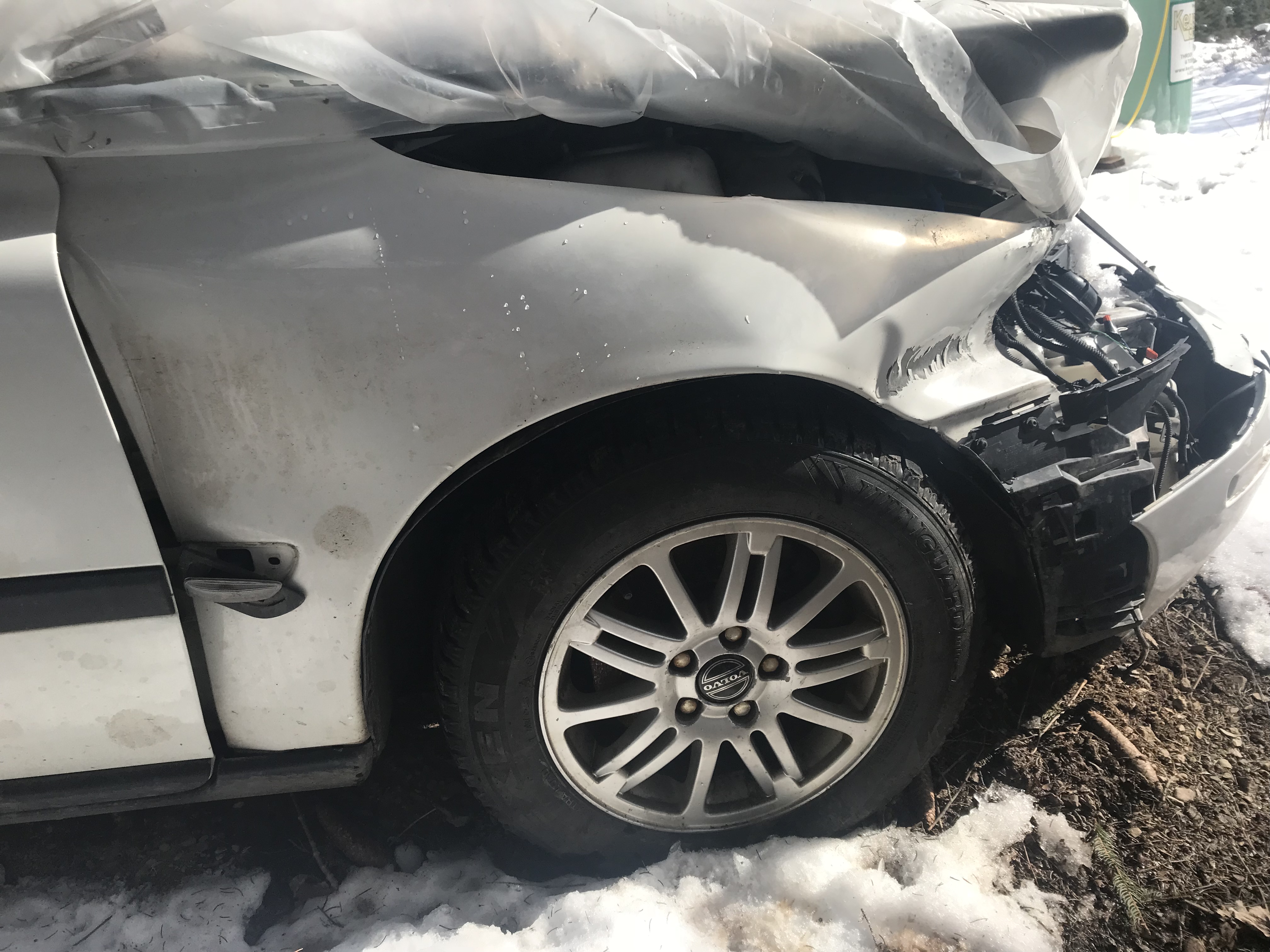

The photos look like a car that had a lot of angular hits. If you aren't directed by the crash at the airbag then they SHOULD NOT deploy. Imagine you hit something where you are directed toward the windshield post and are unbelted. The airbag striking you on your right shoulder would only twist your upper torso and could make injuries worse. The direction sensing of airbag systems is not something never found in error on Volvos and also not on any others in the last 15 or so years.
I wrote unbelted as that would be the situation where a wrong deployment has more implications. Belted gives you the far more wide ranging protection of pretensioning and force limiting seatbelts and makes the airbags as secondary protection in very severe collisions where the passenger area intrusion and belt elongation from much higher forces makes the airbags provide extended protection. I see the front bumper beam displaced left and not much crush of extremities of the car on any corner. What injuries do you believe airbags would have lessened?
I don't see any side intrusion on doors. That is what triggers inflatable curtains.
You might contact an experienced lawyer but he is likely to employ an engineer or other expert witness at your expense before he will do contingency for any action. I see a car that looks like hundreds damaged in ice wrecks in TX with no airbags. Again, think of how an airbag that you impact on 1/2 or less across your upper torso is helping any injuries you have. The RF looks like the hardest hit and that would have sent you towards the center dash/radio area.

They could always retrieve the data from the SRS/airbag controller. It likely has an event stored even though they were not deployed.

As mentioned above I think, if the car was sliding sideways when it hit the guardrails head on, much like the car in this video at 3:55 , then there may be a chance the front airbags won't deploy 'by design' (imo)
