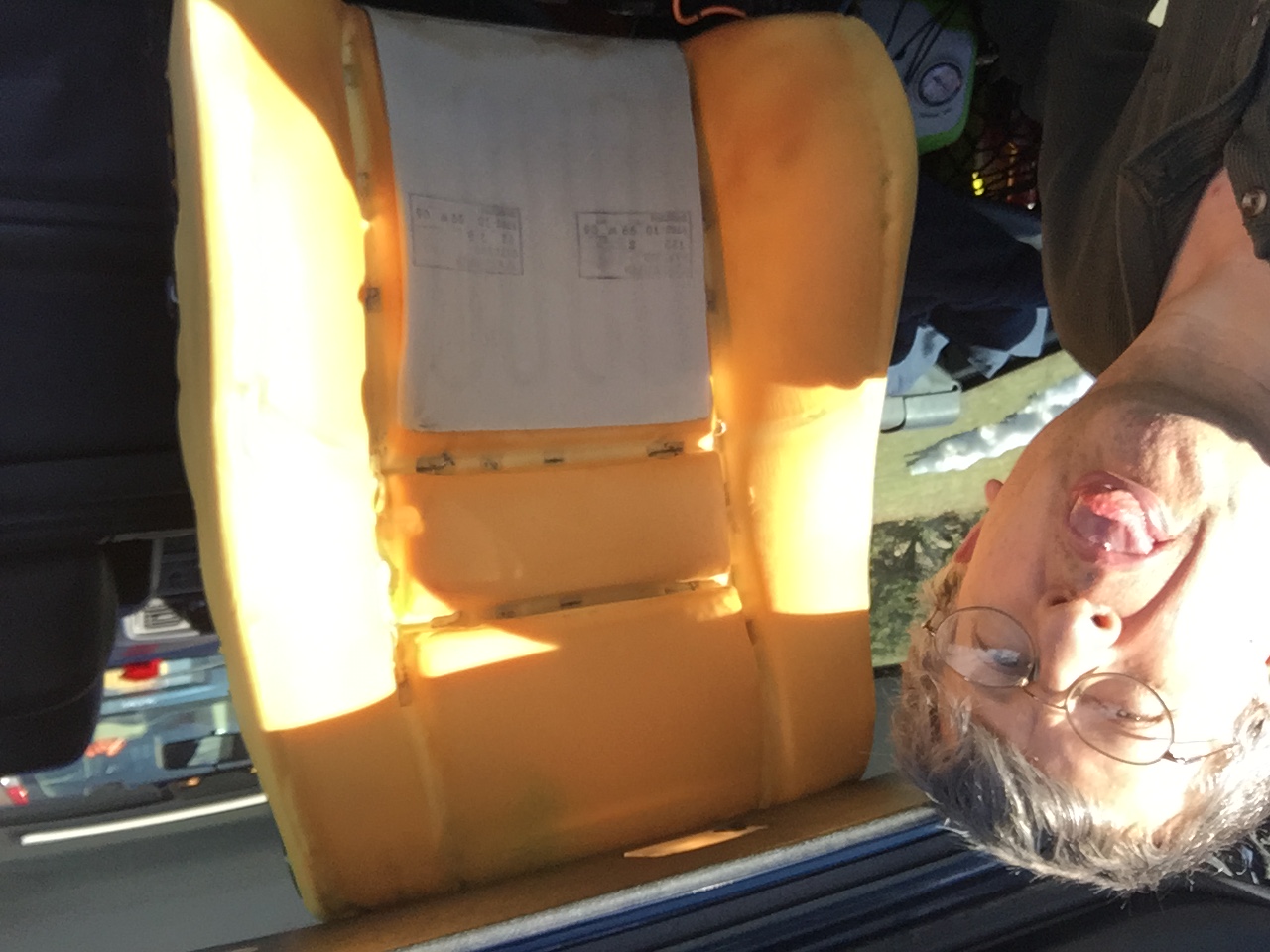

Found the release buttons for the head restraint. Not intuitive but got good pictures for posterior/ity
The seat bottom foams are swappable, the seat back foams are not due to the SIPPS cutout
This thread will turn into the skin swap thread, or something else which is safe for work

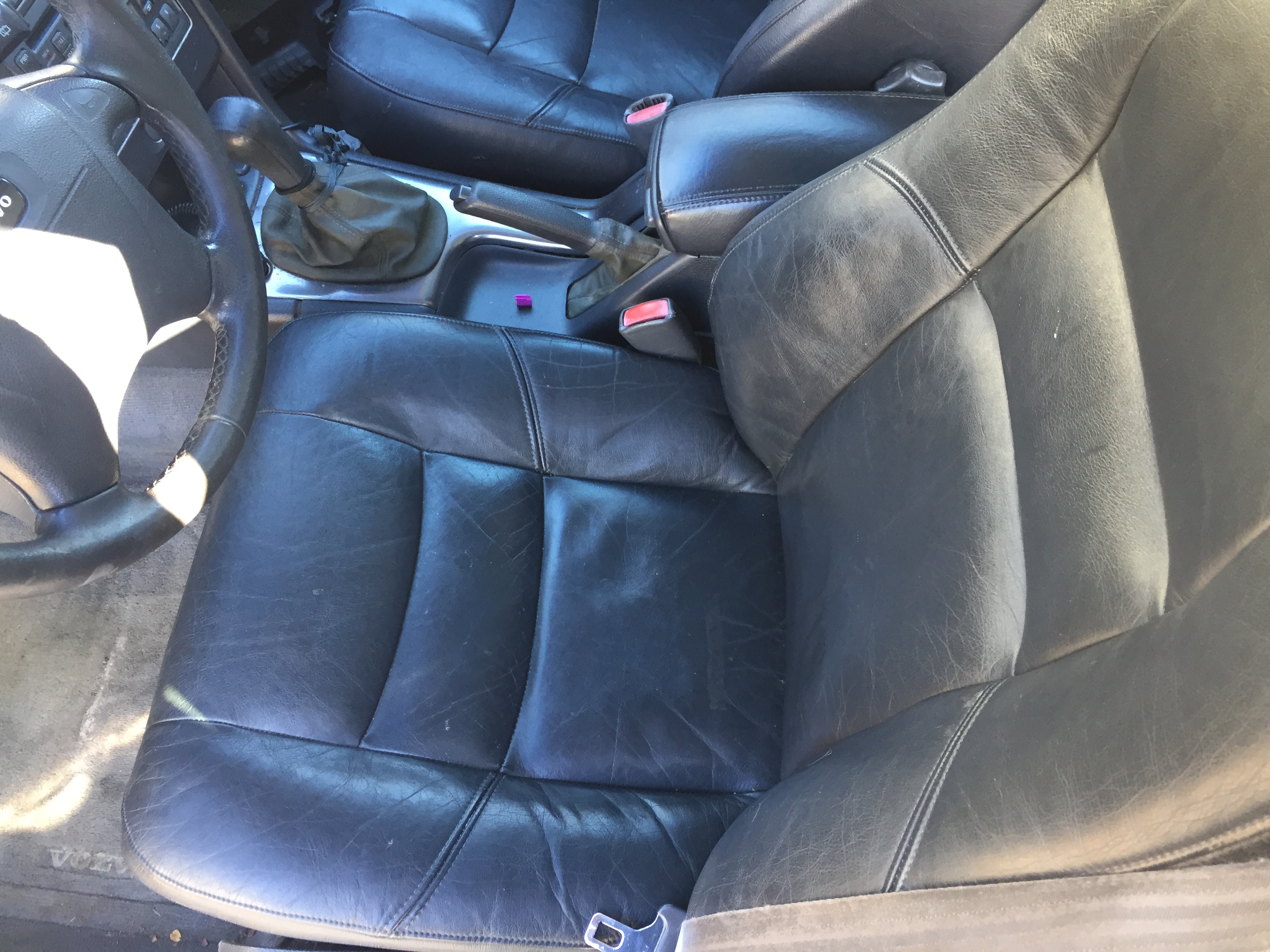

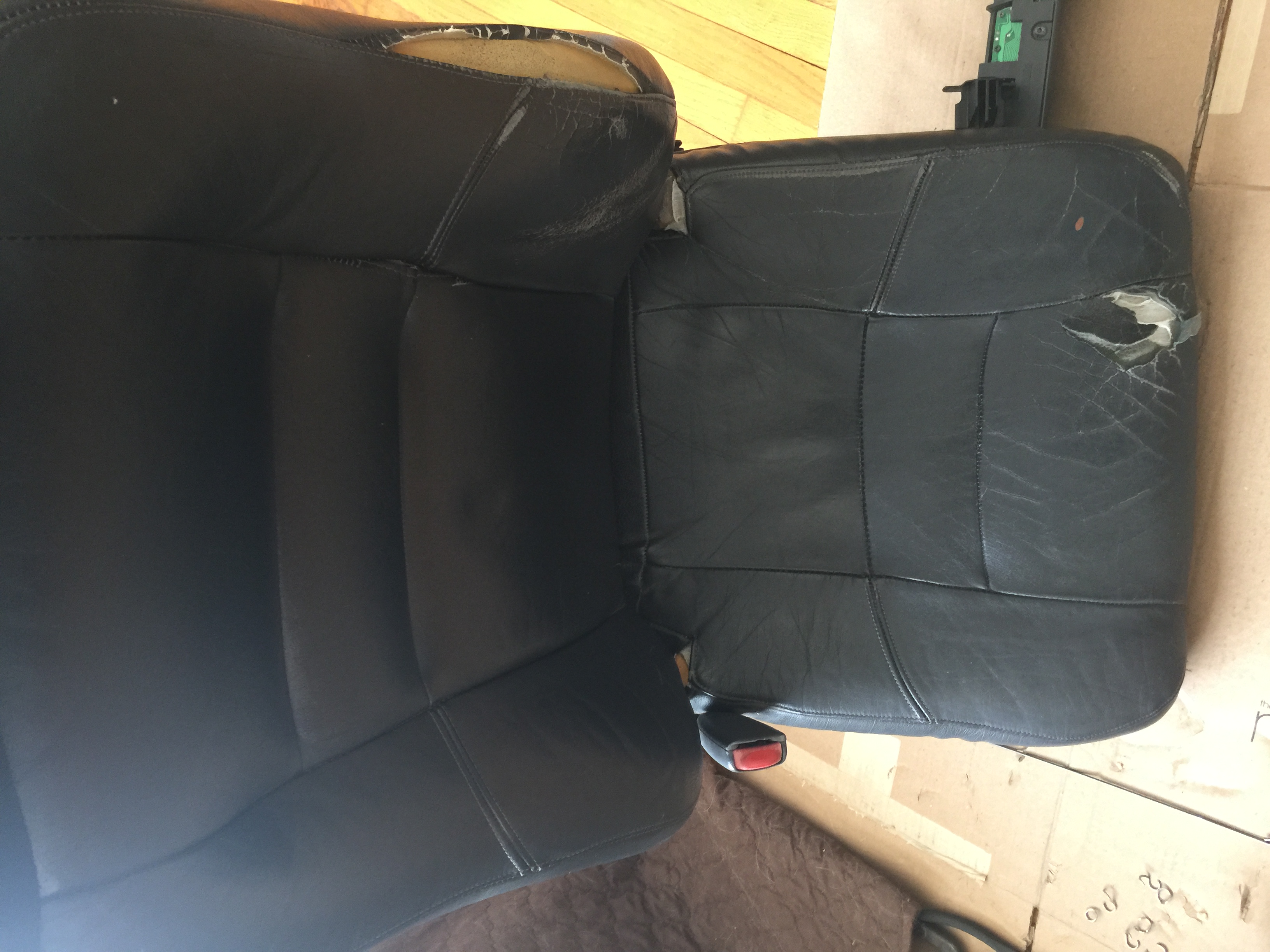

Well I got it done today
I swapped both skins and also put the passenger side seat bottom from my parts car into the driver side of my 1999
As comfortable as the P80'seat was before , I can feel the difference of a new seat bottom that hasn't had my fat a$$ on it for 200,000 miles
And, just saying....
Nasty old seat
Nasty old seat
Yes, it's a heated third rear seat
New skin upper lower, and passenger side foam bottom

Whilst I can't possibly comment on the posterior issue on the seat (old saying of look in the mirror before commenting!!Ahem), glad you got the set figured out. It is amazing how the change is foam makes such a difference. I did the same with the V70 NA, swapping the passenger seat from a PnP car with the foam and seat heater. Huge difference, and once you figure out how, it is not a terrible job, particularly when I have the hog rings and a couple of different hog ring pliers.

Well, my $500 parts car just gave me another $460 of good leather skins and a
LIke new seat base which will nice on my April travels.
I used zip ties but went with 4 inch...much too short. 6 inches would have been a lot easier.
Here's a picture of what toy are doing to release the headrests...
