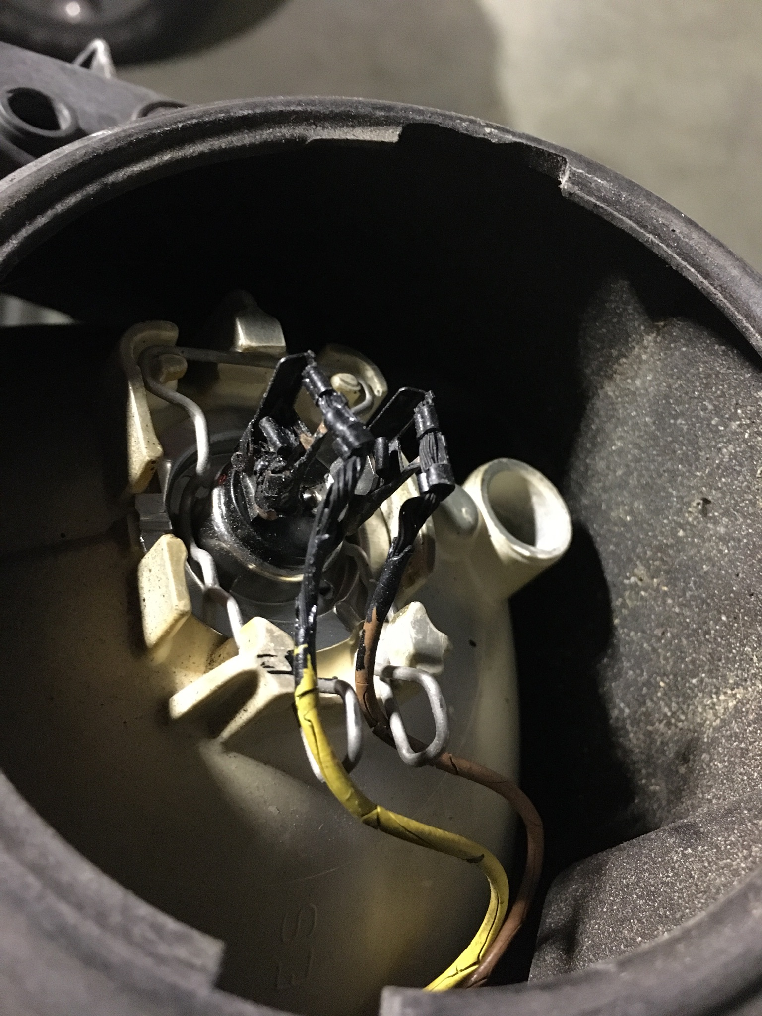

PSA by the way. Open up those headlight twist covers and inspect your headlight wires periodically

I had similar heat damage to the H7 bulb wires on my Mercedes. It was caused by a bulb filament which was disconnected but still sometimes working. This increased the resistance on the wires, generating more heat, causing damage. I was able to buy new H7 bulb socket and wires ("pigtails") but haven't soldered them in yet. I wonder Volvo offers similar harnesses, or if you could just get generic ones.
