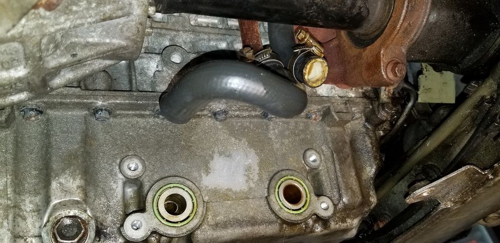

The Oil Cooler hoses look fairly new with new worm type clamps. They also had no heat shield.
Do you think these hoses were already replaced by previous owner?

I would say yes. The factory has both heat shield and they are attached together with a plastic clamp to prevent the, from chafing on the axle shaft , too
I would replace the drug store clAmps with ABA or Volvo ones with closed serrations, or, even better, Oetiker clamps

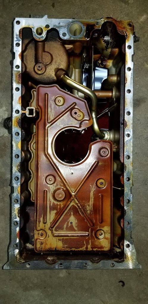

XC70Rider wrote: 08 Feb 2019, 18:47 Dropped the oil sump today.
Not too dirty so only took 1 hour to clean. I'll post pictures of the clean pan tomorrow before I reinstall it.
This pic answers a question about the oil cooler, you can remove it without draining the sump. The oil cooler lines on the biscuit type cooler run off the oil filter housing

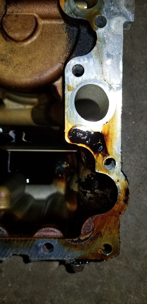

I also have suspicion the oil sump was previously dropped. In the top right of the sump there was a good amount of crud.
This is where the 2 bolts cannot be removed from below because of the subframe blockage. They need to be removed from the right wheel well. The mechanic obviously didn't give these bolts enough torque during installation.
I agree because a good amount of oil dripped out of the oil cooler even though the sump was empty.

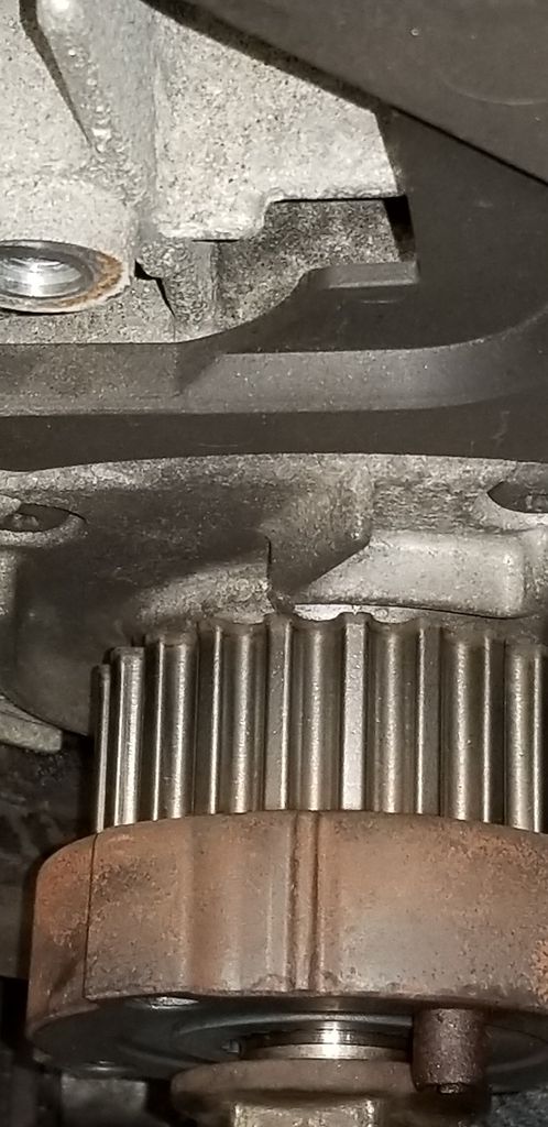

After mounting the oil sump I proceeded with the timing belt. I lined up the Camshaft markings with the timing cover but I couldn't catch any markings with the Crankshaft? After removing the crankshaft harmonic balancer and tensioner I could get a clearer view of the crankshaft gear. Still cannot find any markings on the splines. I kept my eye on the crankshaft while rotating it 360deg but all the splines appear identical.

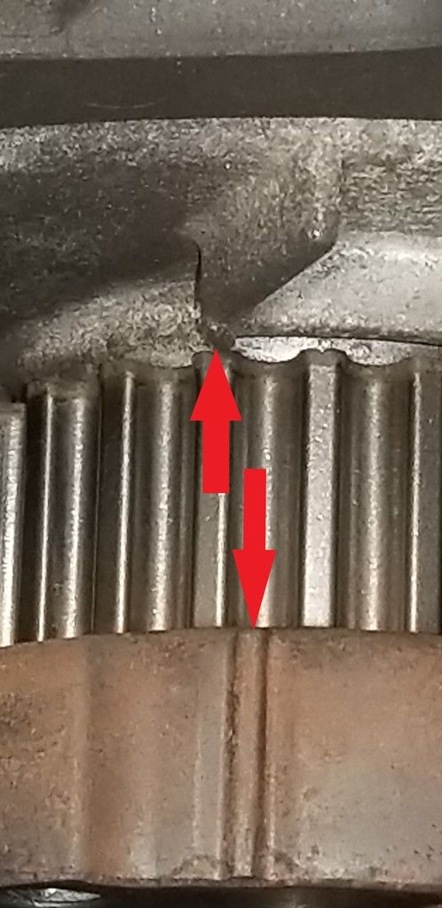

Here is a closeup view.
Are these the actual markings for the Crankshaft gear? If so I'll need to rotate CCW a notch.
