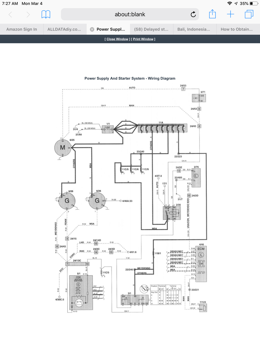

Pictures In this thread, but I’m still looking for an earlier P80.
It’s a green red heavy wire to a connector on the strut pre 1999 ( green in MT cars ....CAREFUL) , then moves inside the fuse box as pictured.
With your acumen, you can find it, the new follow the wire to the harness running down to the starter to confirm. On edit - fixed that, referring to the diagram below the starter bypass wire connects the load side of the 2/35 relay, not the starter.
It’s the two loose looking wires coming off the starter relay 2/35 mid picture
viewtopic.php?f=1&t=78989&p=448135&hili ... al#p448135

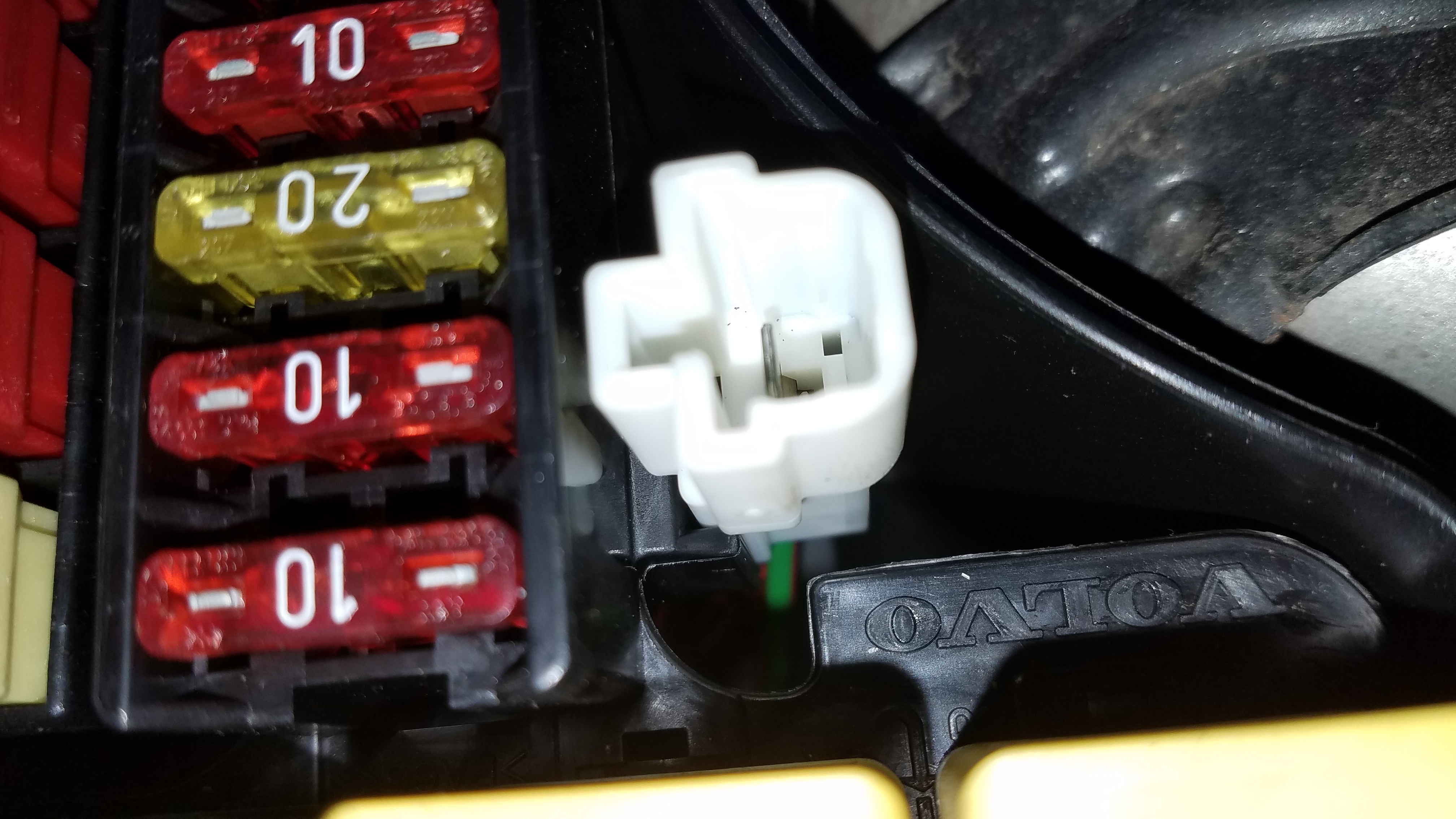

It looks like it's in the fuse box area of my 1998 S70. Definitely Green/Red (possibly primary Red, secondary Green)
So I just put 12V to this and it should engage the starter, just like I was turning the key, right? Does the key need to be in the ignition in "run" position?
On a side note, I really need to turn that rogue 10A fuse around. I mean, really, who does that???
