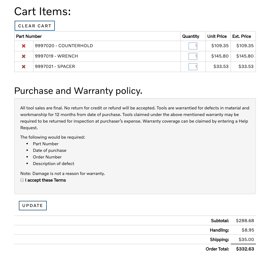

Tools make a job fun, here is the cost:

Wow, the 9997019 is super expensive given that you can buy a functional equivalent of it for about 30 bucks on ebay.
9997020 though is nonstandard, not much/any choice on the market for this one.
I recall that, for other models (V40?), the same counterhold is used along with a spacer which compensates the smaller diameter of the rack. Is that the 9997021 spacer on your list?

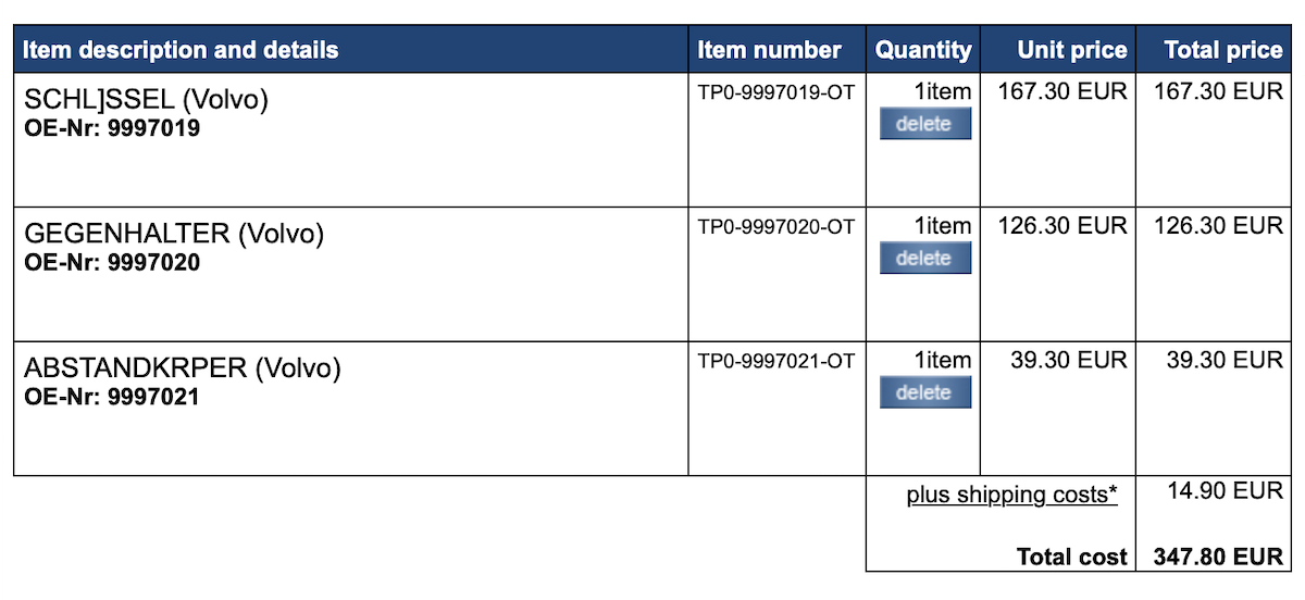

Not even better here in Europe.
Peace of mind can get expensive very quickly.
For the Haldex, Angle gear repair and maintenance i am at 520€ of Volvo special tools, by chance half of them were bought second hand off eBay!! I have already loan a set of tools but someone has to buy them first.
Still better than the dealer cost.
