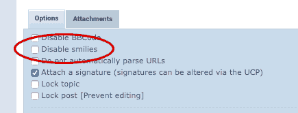

Went back in to edit it again. It won't clear Pfff!!abscate wrote: 13 Mar 2019, 18:42You’ve got some internet TCIP stuck on your 8 )Current metal fatigue in the conrods (a weak point for these motors)

Because "8)" is the ASCII code for

You can avoid this problem by checking "Disable smilies" in the Options tab beneath the editor.
