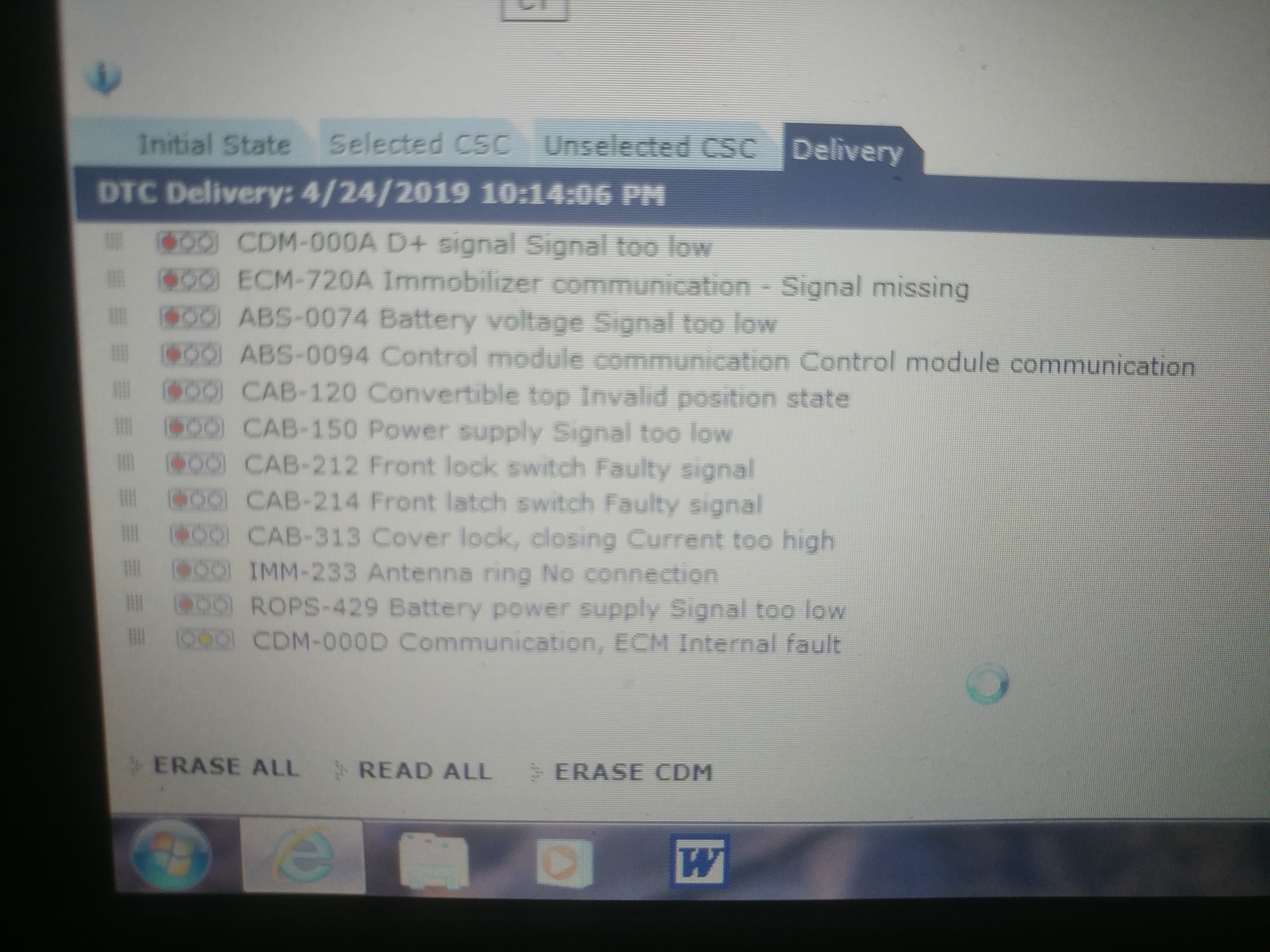

got vida running after a week of trying to load software.got IMM-233 antenna ring no connection and ECM-720A antenna ring no connection and CDM-000D commuication ecm internal fault....................

also any help with some of these code
RickHaleParker
Posts: 7203
Joined: 25 May 2015, 14:30
Location: Kansas
Has thanked: 8 times
Been thanked: 979 times
Post by RickHaleParker »
lavellp7 wrote: 25 Apr 2019, 19:11 also any help with some of these code
Double click on the codes. Starting with IMM-233.
Active
Past

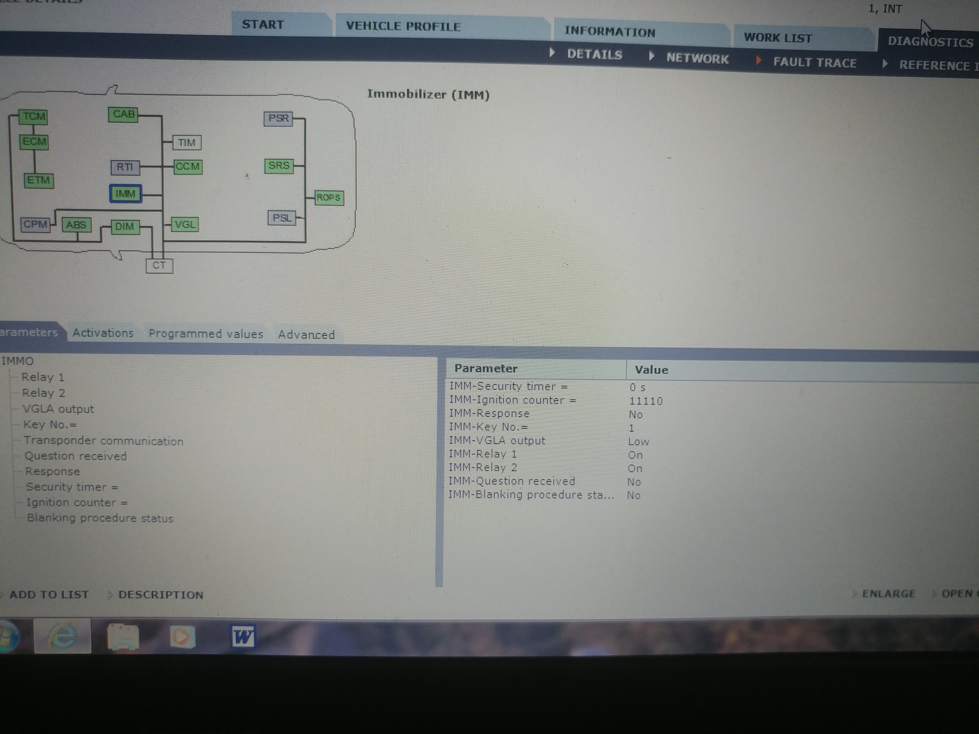

i see it know key 1 is in switch,but has no response vgla is low.what else should i look for????and what next thing to look for
i checked the antenna ring its new and reading good at module #8#9

Ah hell if this is the first time in. Clear all the codes and see what comes back. Some of the codes maybe artifacts from problems long gone. Abscate has another post going where he has starting problems until he cleared a IMM related code.
Active
Past

clear all the code and ecm-720 come back up...........run the battery down. Charging up to recheck tomorrow

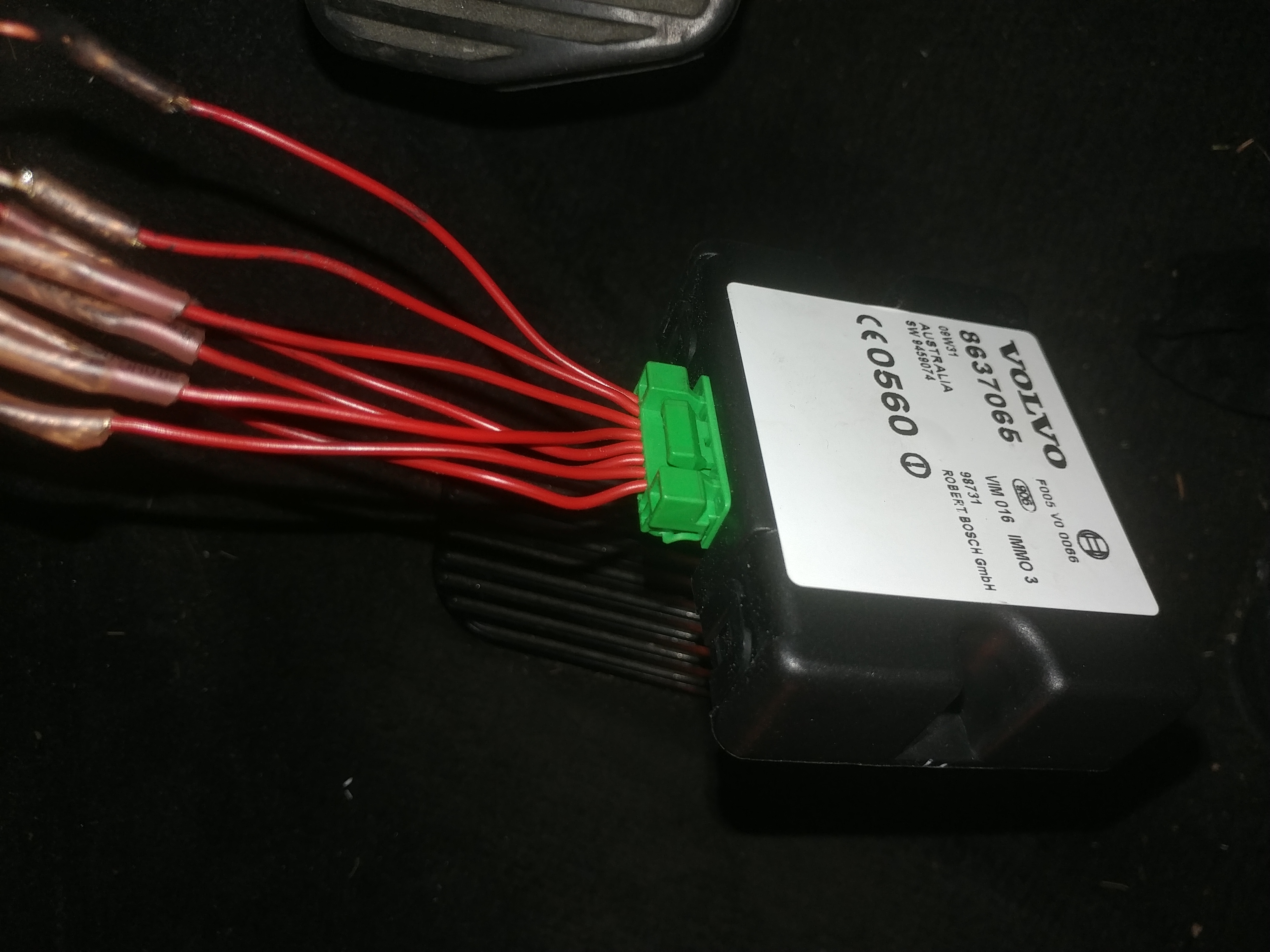

I'm gravitating toward the sloppy splices on the immobilizer loom. Some of them wires are suppose to be twisted pairs all the way to the connector, to minimize Crosstalk. Also poor solder joints can degrade the communication signal.
I cannot tell from the picture, are the splices soldered and soldered well or them dam crimp connectors?
Active
Past
Posts: 36149
Joined: 17 Feb 2013, 17:54
Has thanked: 1610 times
Been thanked: 4065 times
I totally missed those splices
Those won’t work. You need some rewiring help from an experienced electrician. There are twisted pair comm links on the antenna ring that need to be done right.

Post by lavellp7 »
i didt wire them this is how i got car in two months ago,the seller had someone replace immobilizer and Antenna ring and all the parts chasing to fix car.....it never got fix so.all code are clear except the ecm-720 my Question is what VGLA output =low and blanking procedure = no
