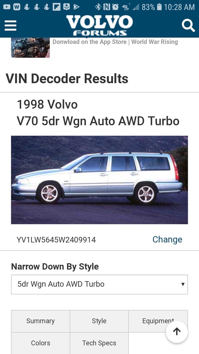

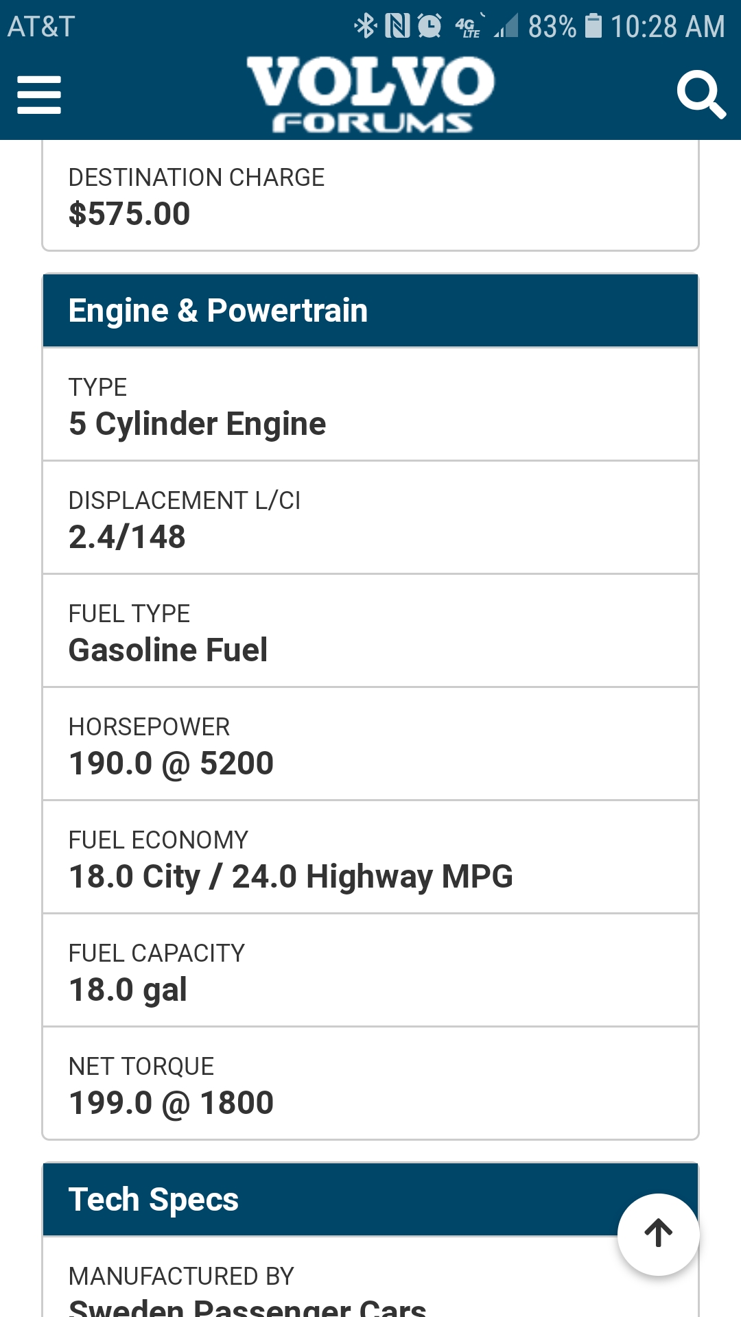

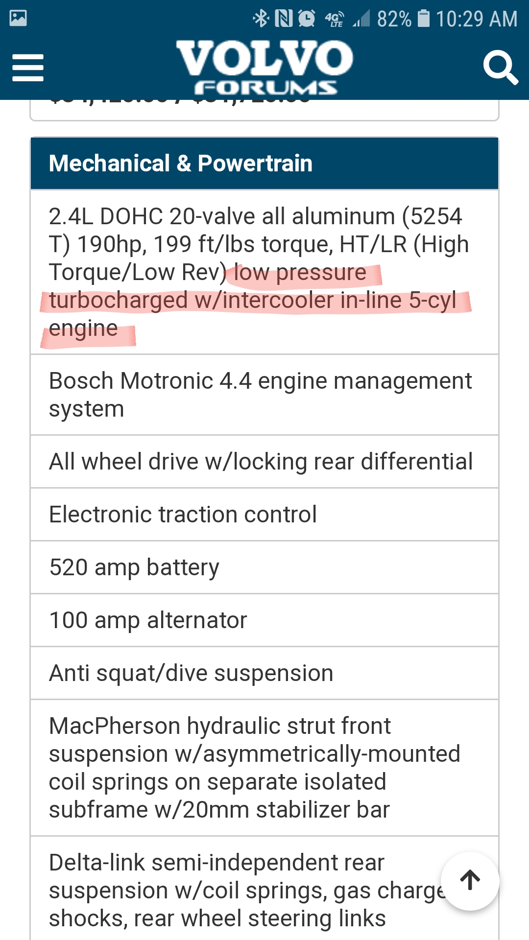

Check these out. This is looked up off my vin numbers

Gmstewart22 wrote: 14 Apr 2019, 12:32 Check these out. This is looked up off my vin numbers
B5254T
The B5254T is a 2.4 L (2,435 cc) straight-five. It is turbocharged and intercooled with a power output 193 PS (142 kW; 190 hp) at 5100 rpm, with 270 N⋅m (200 lb⋅ft) of torque at 1800–5000 rpm. It is equipped with Bosch Motronic 4.4 engine management for model years 1997 and 1998. It is equipped with Bosch ME7 engine management for model year 1999. Boost pressure is limited to 6 psi (41 kPa).
Applications:
1997 Volvo 850 badged as 850 AWD or 850 2.5T
1997 –1999 Volvo S70 badged as S70 2.5T or S70 AWD
1997 –1999 Volvo V70 badged as V70 2.5T, V70 AWD or V70 2.5T AWD
1998–1999 Volvo V70 XC badged as V70 XC AWD or V70 XC 2.5T AWD
1998–1999 Volvo C70 badged as C70 2.5T (convertible)
1998–1999 Volvo C70 badged as C70 2.5T (coupé)
Active
Past

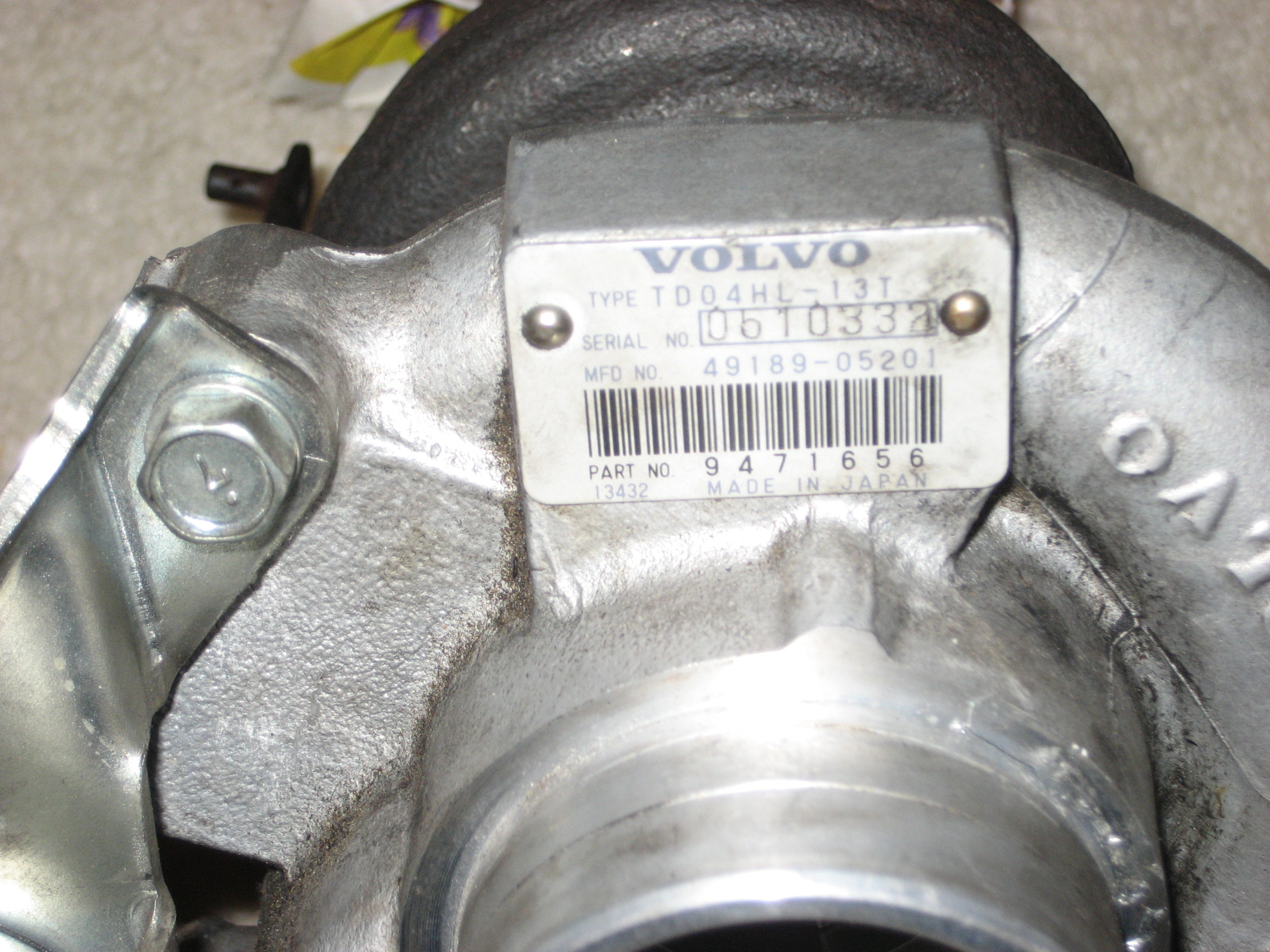

You can just read the plate on the turbo to be sure, but it cam from the factory with a 13t. All AWD in 98 had the LPT engine.
You can also put on a 15g or 16t, an HPT ECU and the injectors to match from the engine, and get more boost that way.

Look at the turbo, look for this plate, check what it says on it. You will likely need to wipe off some grime, they all get messy.
You will now for sure what you have!
turbo name plate
