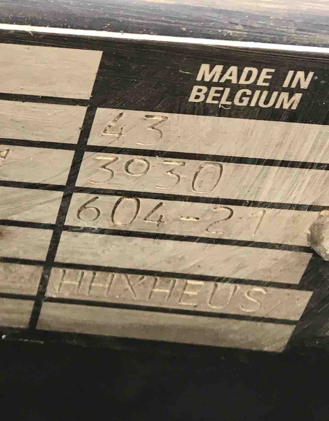

Some news about Blue's rescue. The color of the car is 604 -21 : 604, I understand, but what the 21 means ?

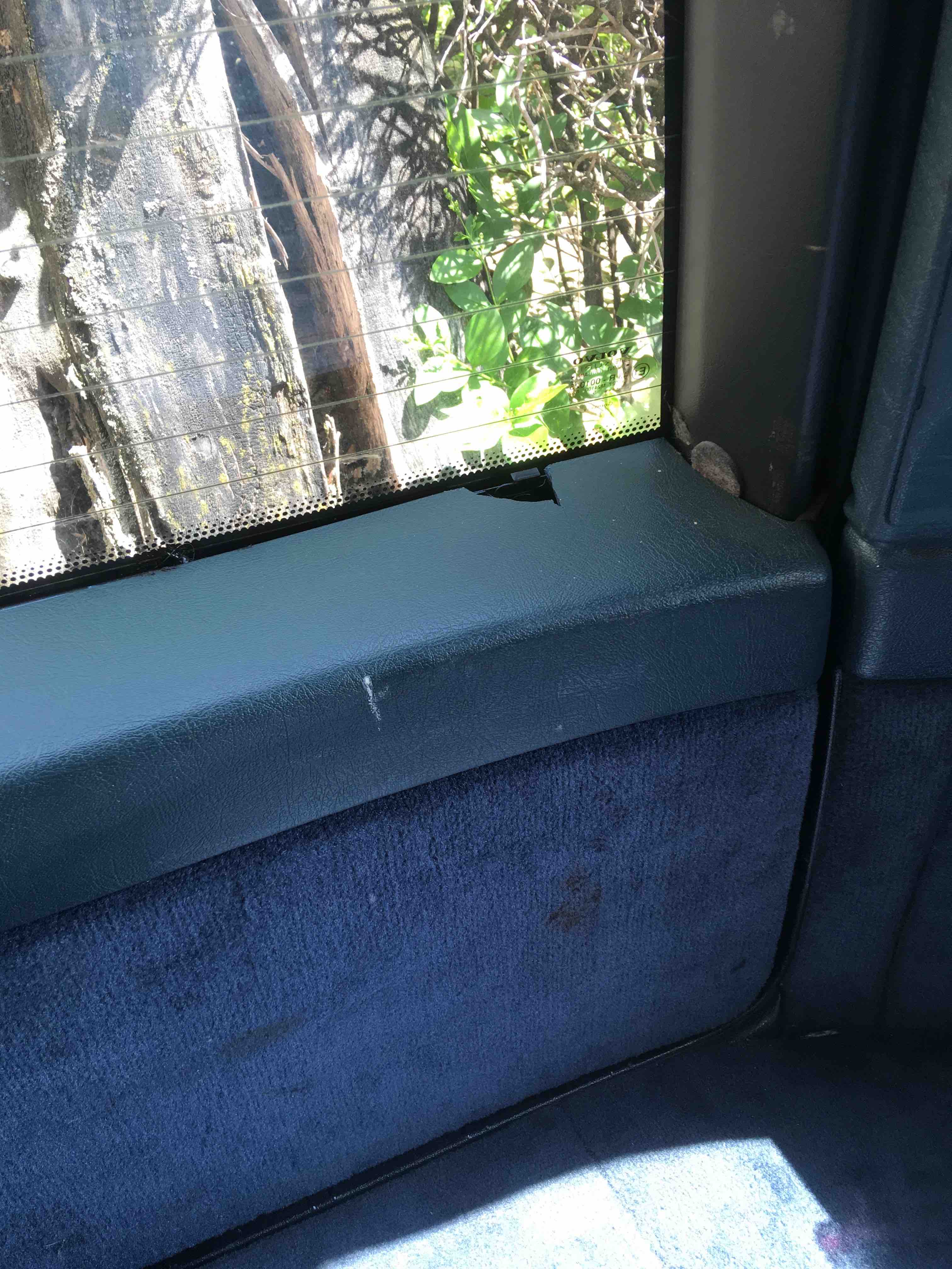

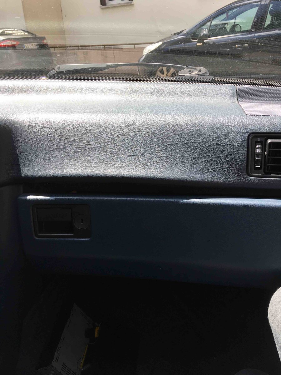

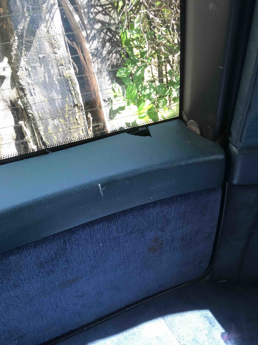

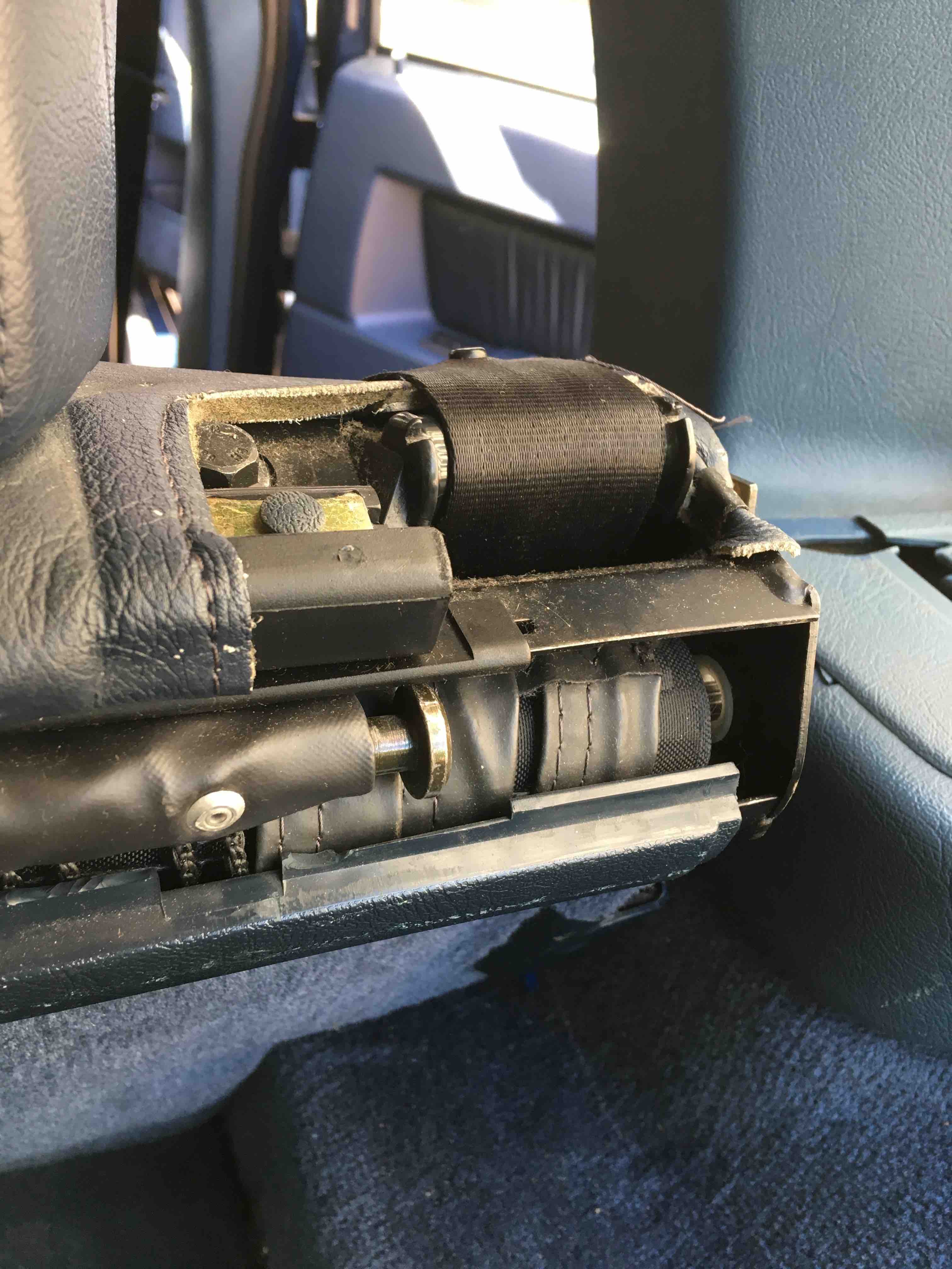

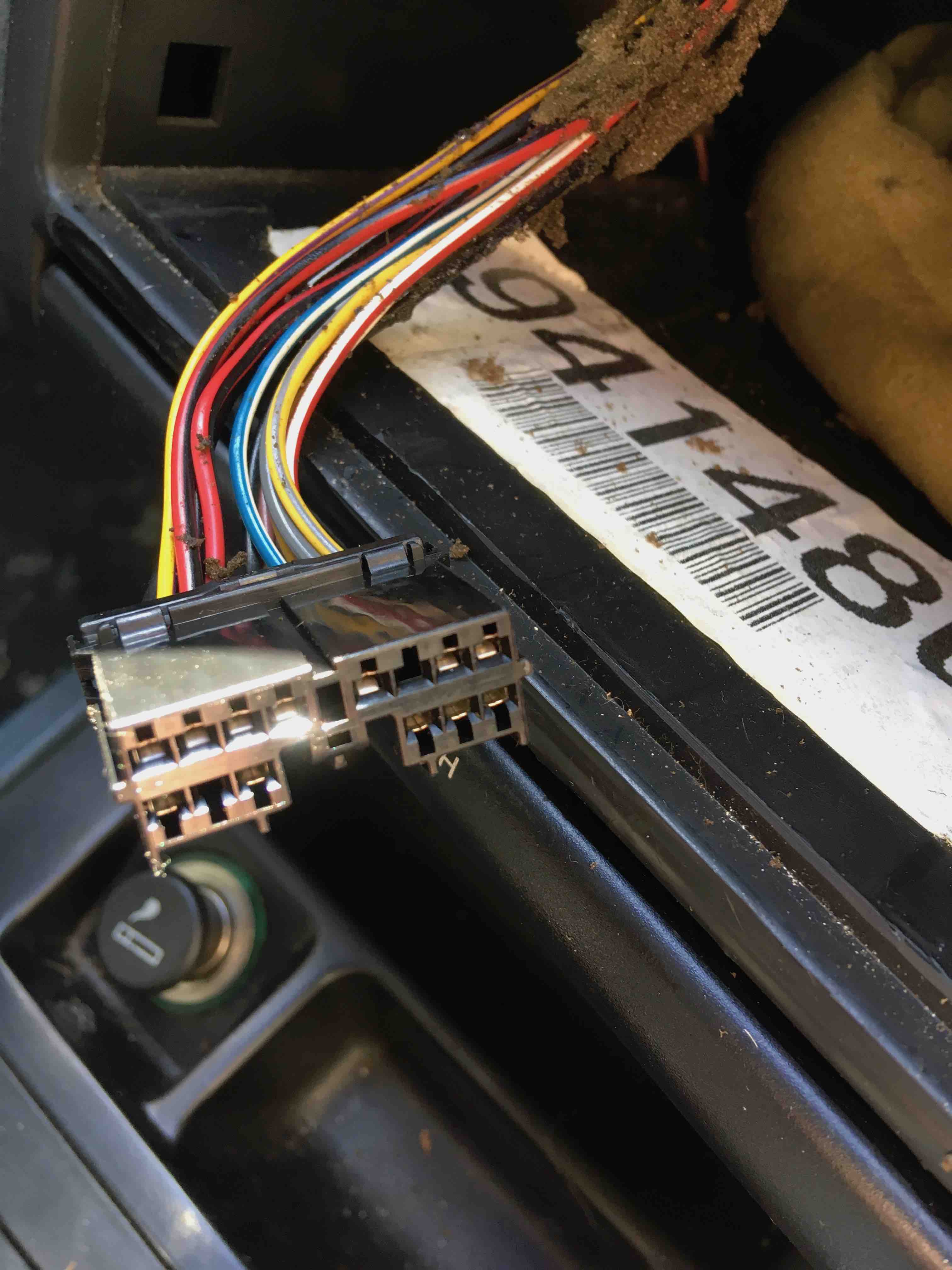

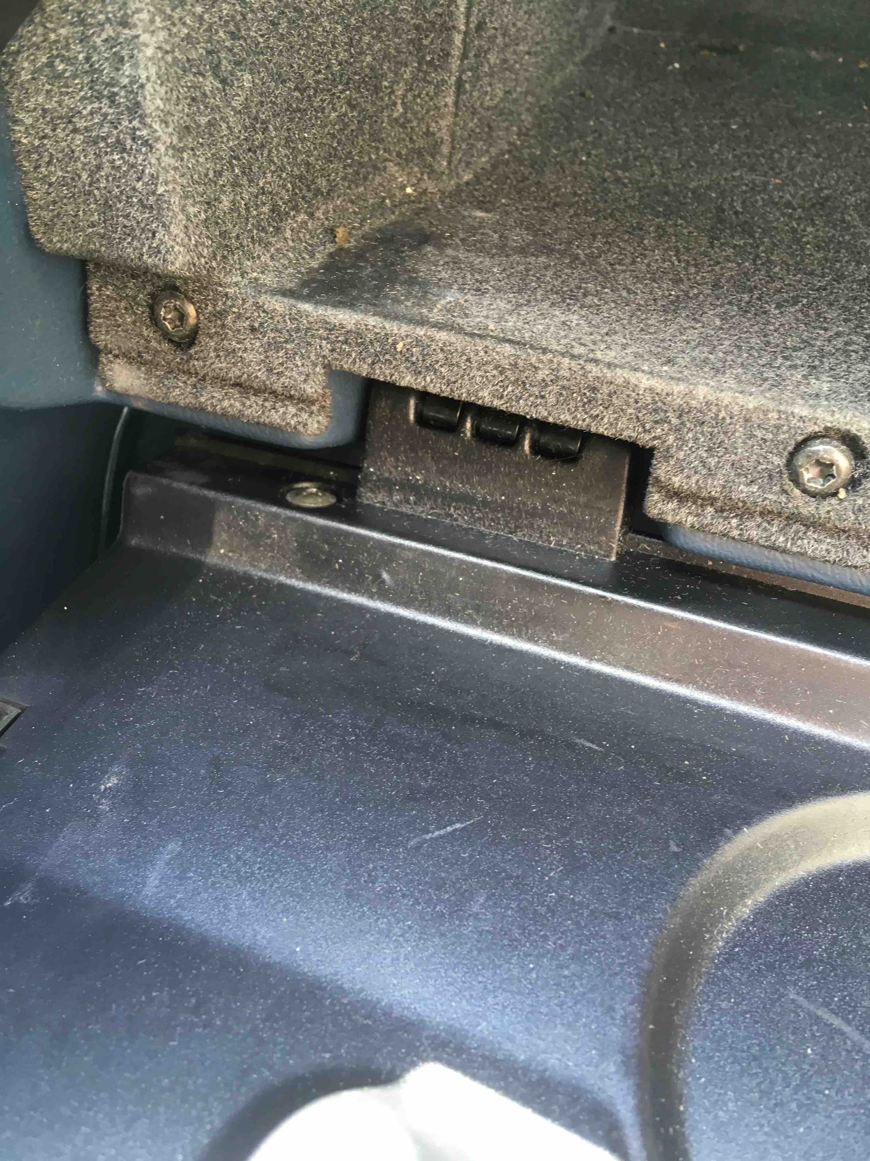

Here some pictures of the visible issues I have to treat.

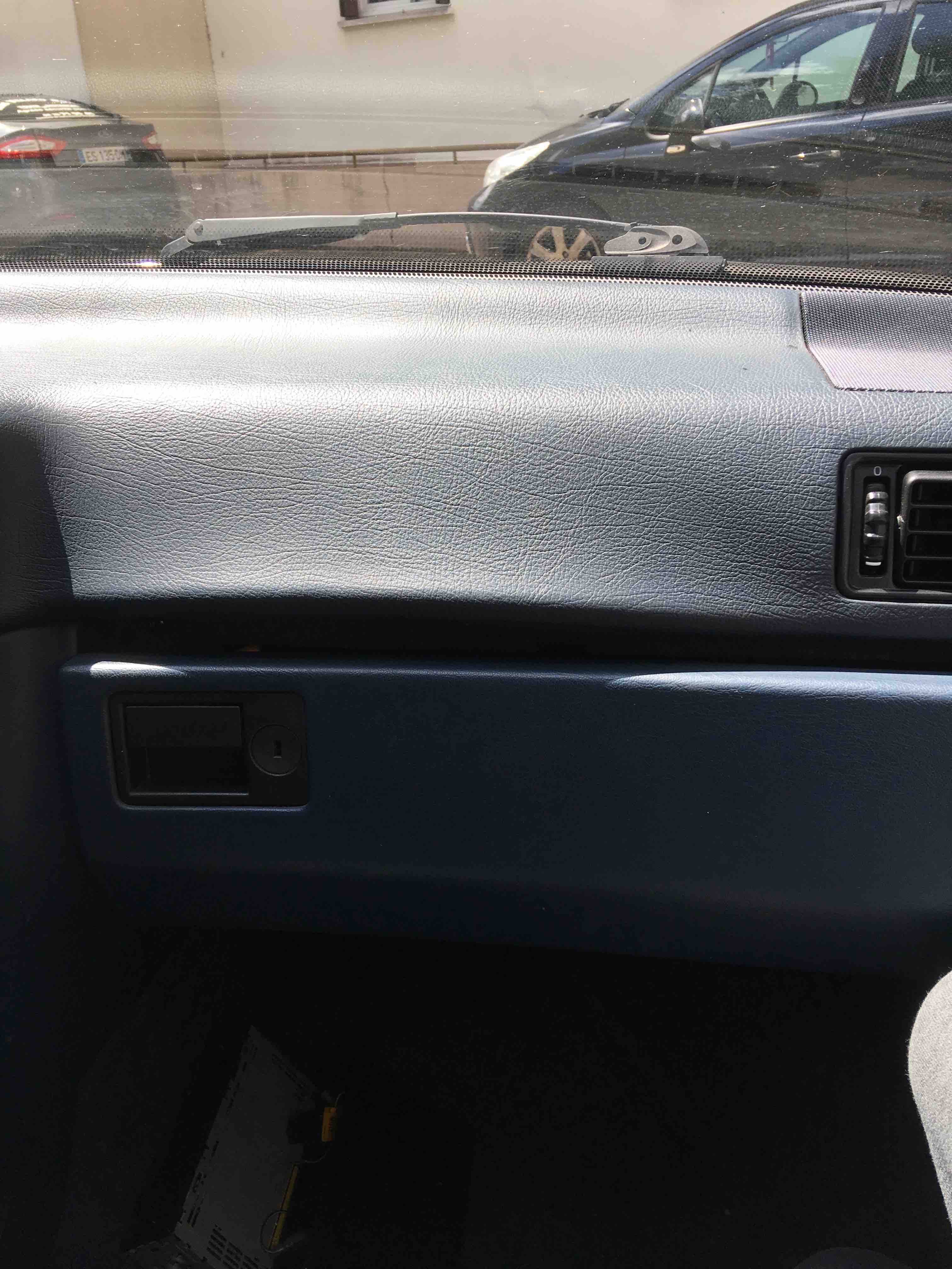

The glove box seems either to be unscrewed or broken
The radio wiring hasn't been touch by a mess, which is a good new. The wiring of the sc 901 present in the V70 will play its role.

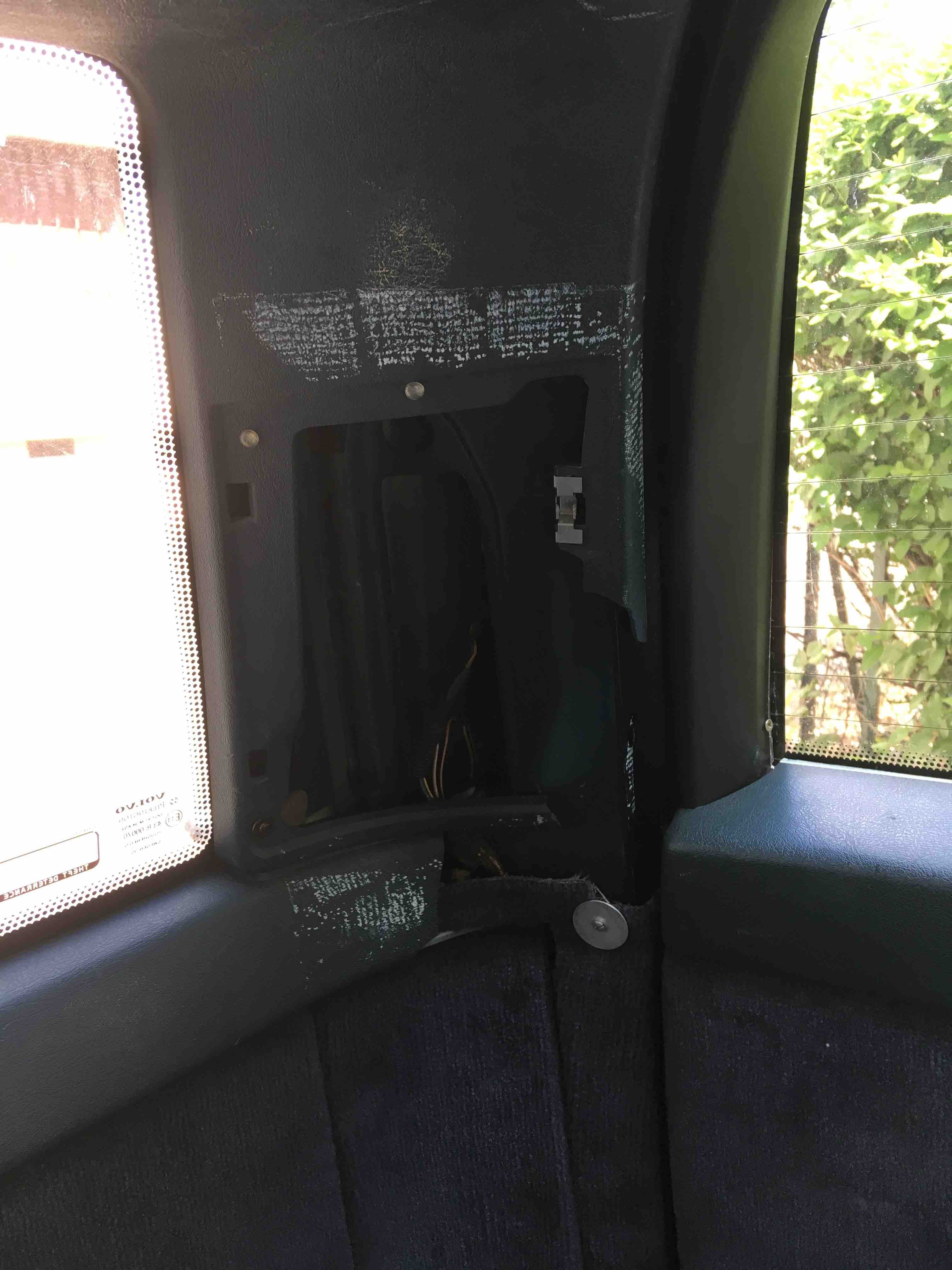

The cover of the tail gate is to be replaced

21 means the paint’s made by Beckers, and it’s solvent based or metallic. :)
4th digit is manufacturer, 5th is type of paint. :)

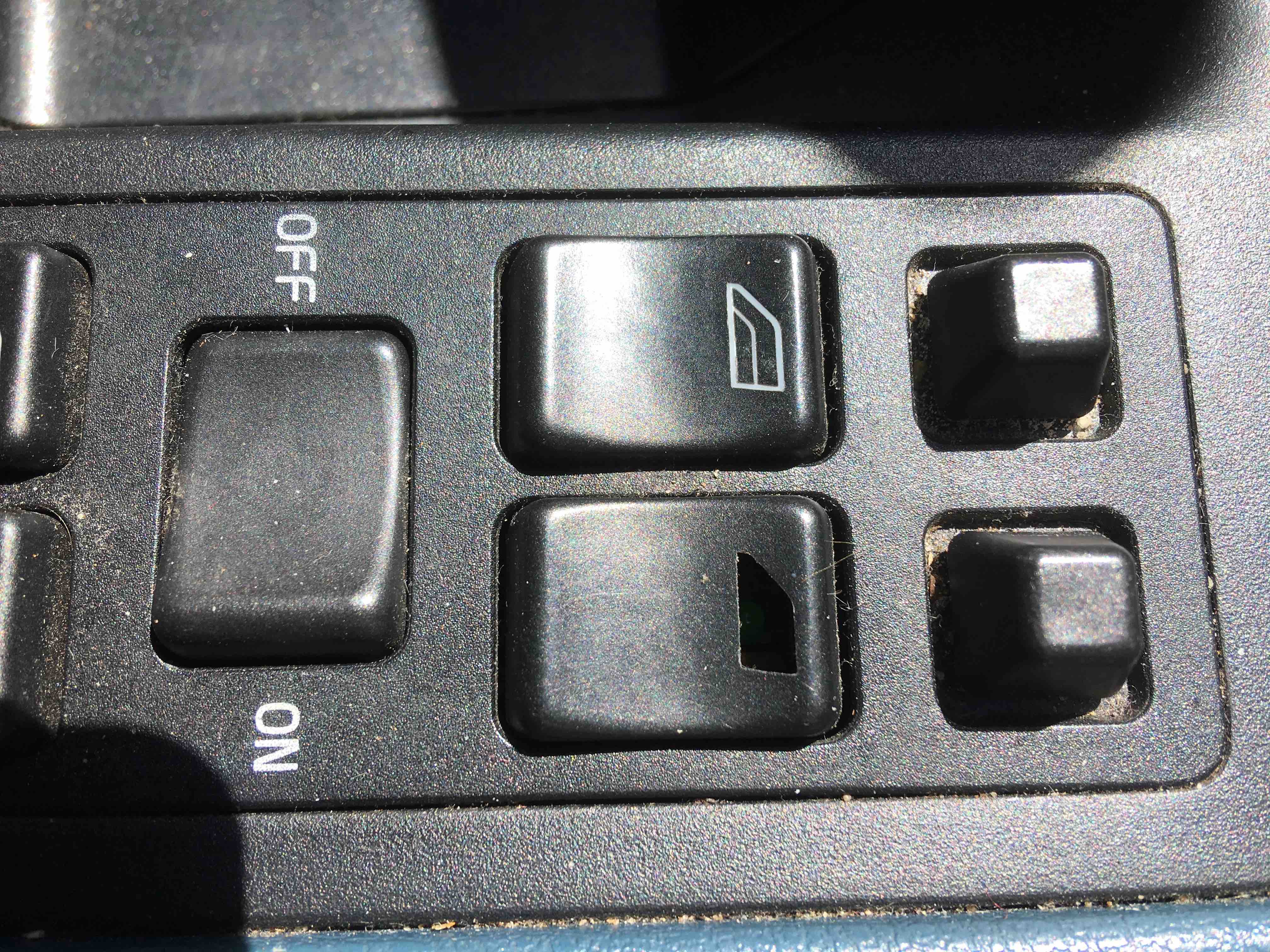

i have another question. About the windows central command, what should I use to clean it, that doesn't run the risk to ruin it ? Sopay water with smooth brush ?

manovlov wrote: 12 May 2019, 20:45 what should I use to clean it, that doesn't run the risk to ruin it ? Sopay water with smooth brush ?
Medical grade Isopropyl alcohol, It will evaporate and leave nothing behind.
