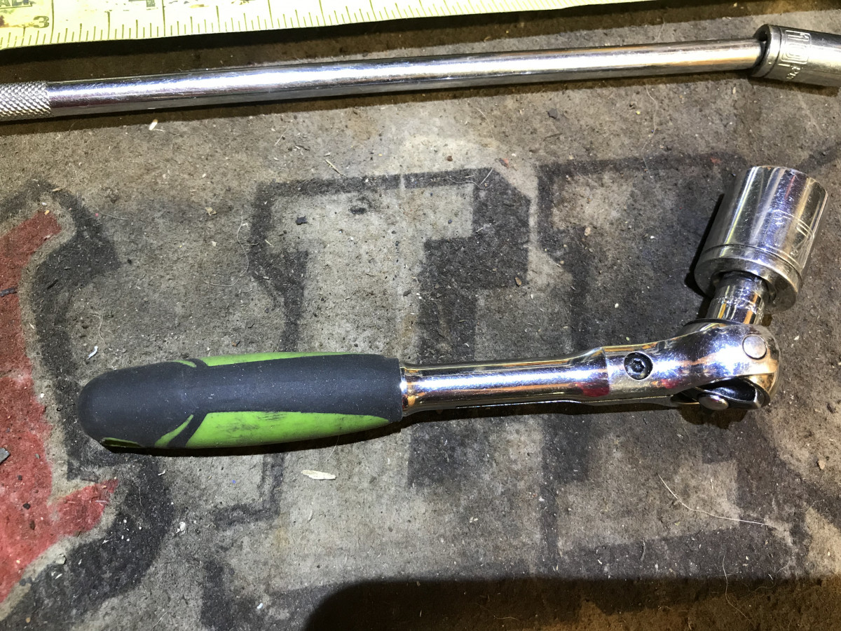

Is that a swivel socket ? It looks quite 'fat' for a 10mm 1/4" My non swivel one was significantly thinner which may have to do with sliding it on the bolt head

Just a standard Craftsman, no swivel.

If it doesn't fit in there, may try a hardware store maybe they sell one that has a smaller diameter. It's all about this diameter, my socket was touching against the thermostat housing when I placed it on the bolt, I think a little larger diameter and the socket wouldn't have got over the bolt

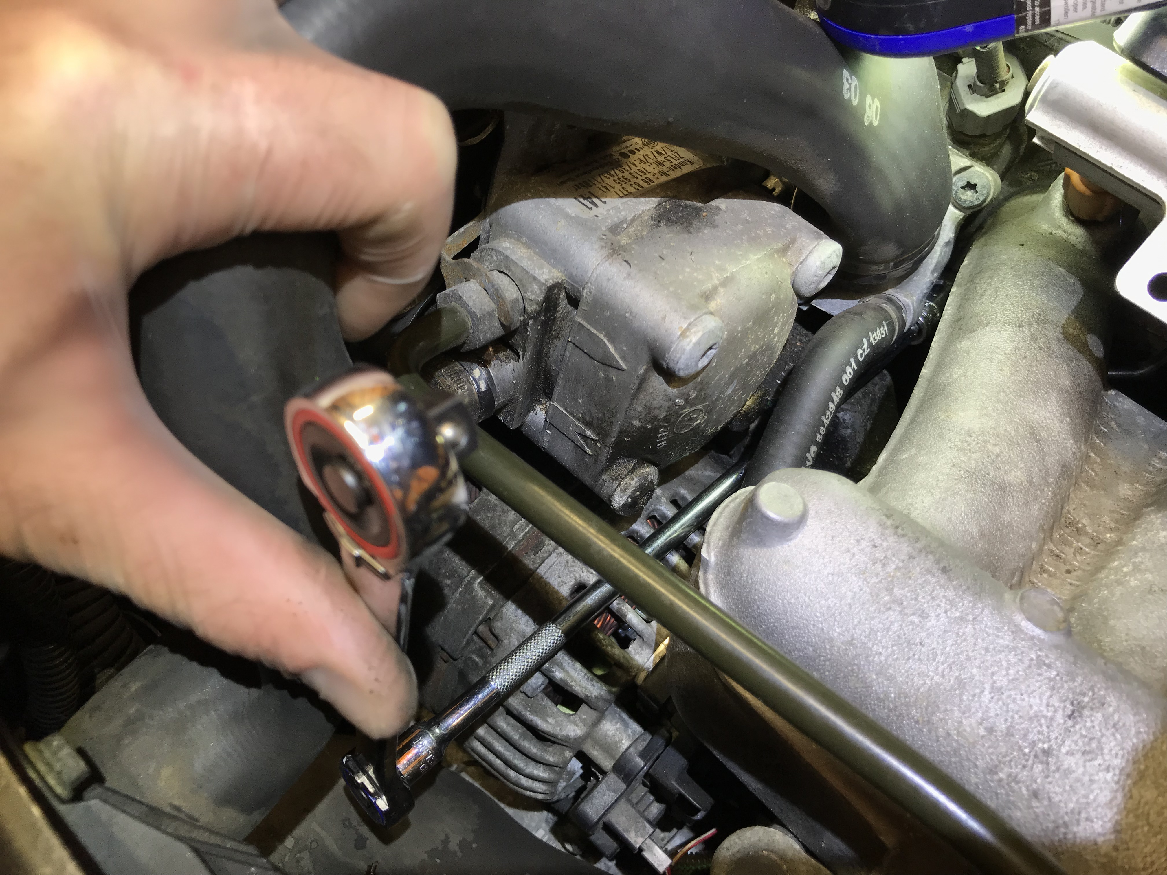

I think this can be done without messing with the pump or thermostat housing

Congratulations on getting it. Man, sure can be a bugger to get that one figured out.

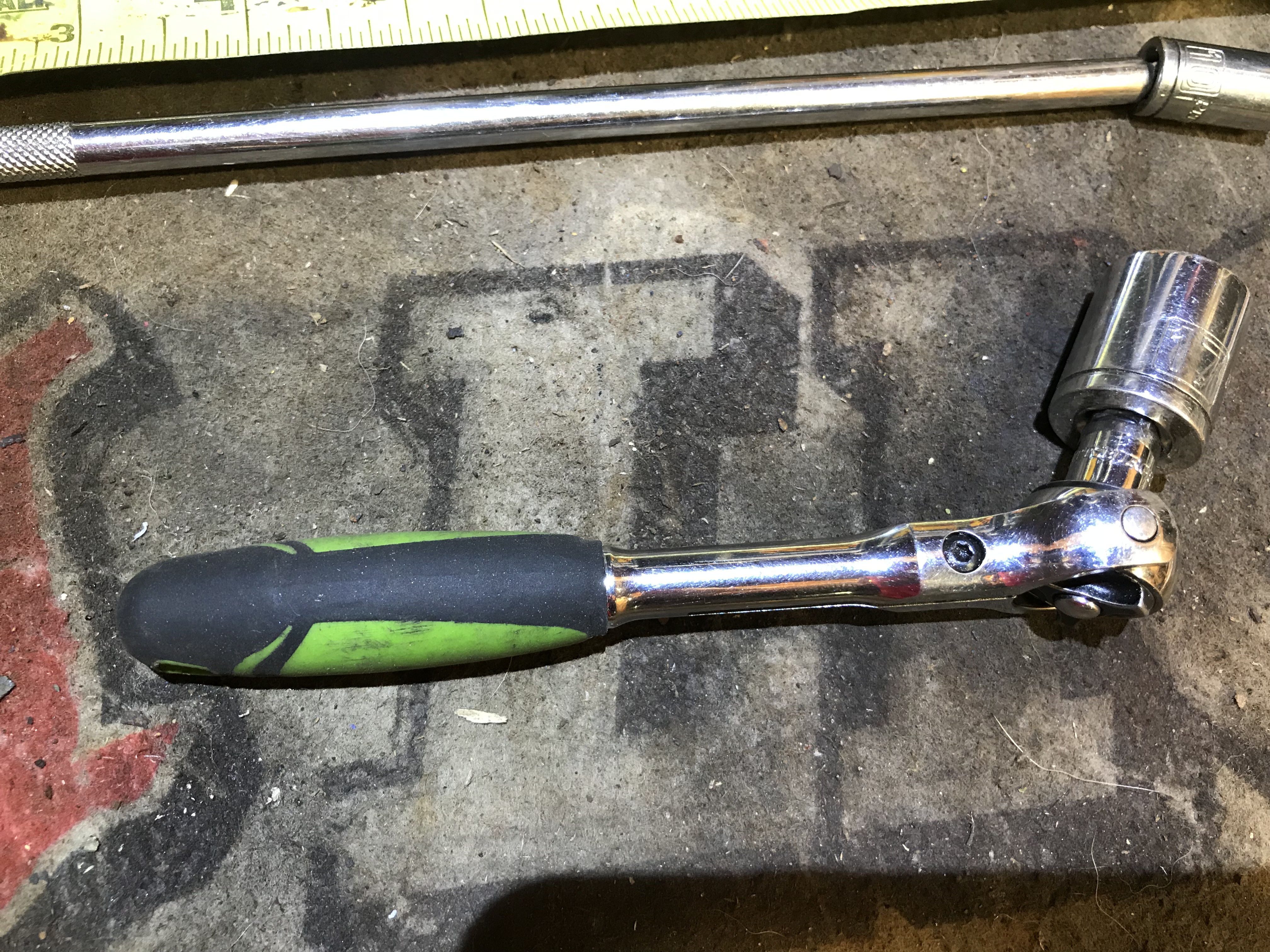

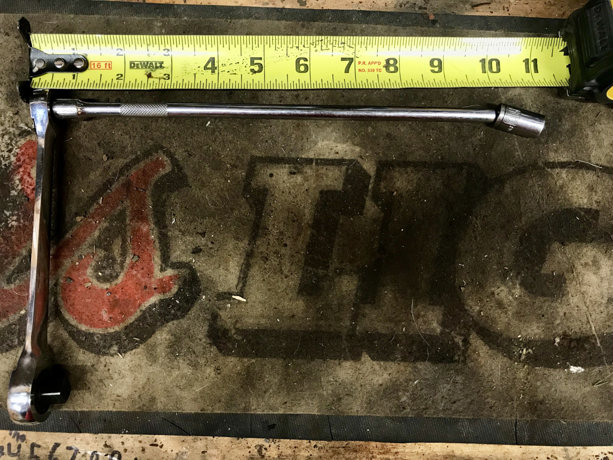

This is what I use. I’ve only done turbo 2.5 P2's, so I can’t speak to any alleged increase in difficulty with N/A engines.
It’s just a 1/4” extension w/a wobble end (not a u-joint type swivel), 10mm 1/4” drive 6-point socket & a 1/4” ratchet.
For the banjo bolt, I sometimes can get a flex head ratcheting 17mm end wrench on there, but once the intake manifold is loose from the head this is what I’ve used. 1/4” drive swivel head ratchet, 1/4 to 3/8” adapter, then your 17mm 6-point with 3/8” drive.

To keep the contraption from being "floppy" use electrical tape. Wrap it around the joint and a bit higher. You can bend it in the shape you want and it will hold for a few uses. Common trick for floppy swivels. Same concept as your wire but will be easier to fashion.
As to SnapOn - it is a ball joint contraption. I measured a common 10mm socket at 13.75 mm - the SnapOn socket is 15.25 on the socket end and 16.85 at its widest point on the swivel end. It doesn't get fat until about 20mm. These are measurements for 1/4" sockets.
