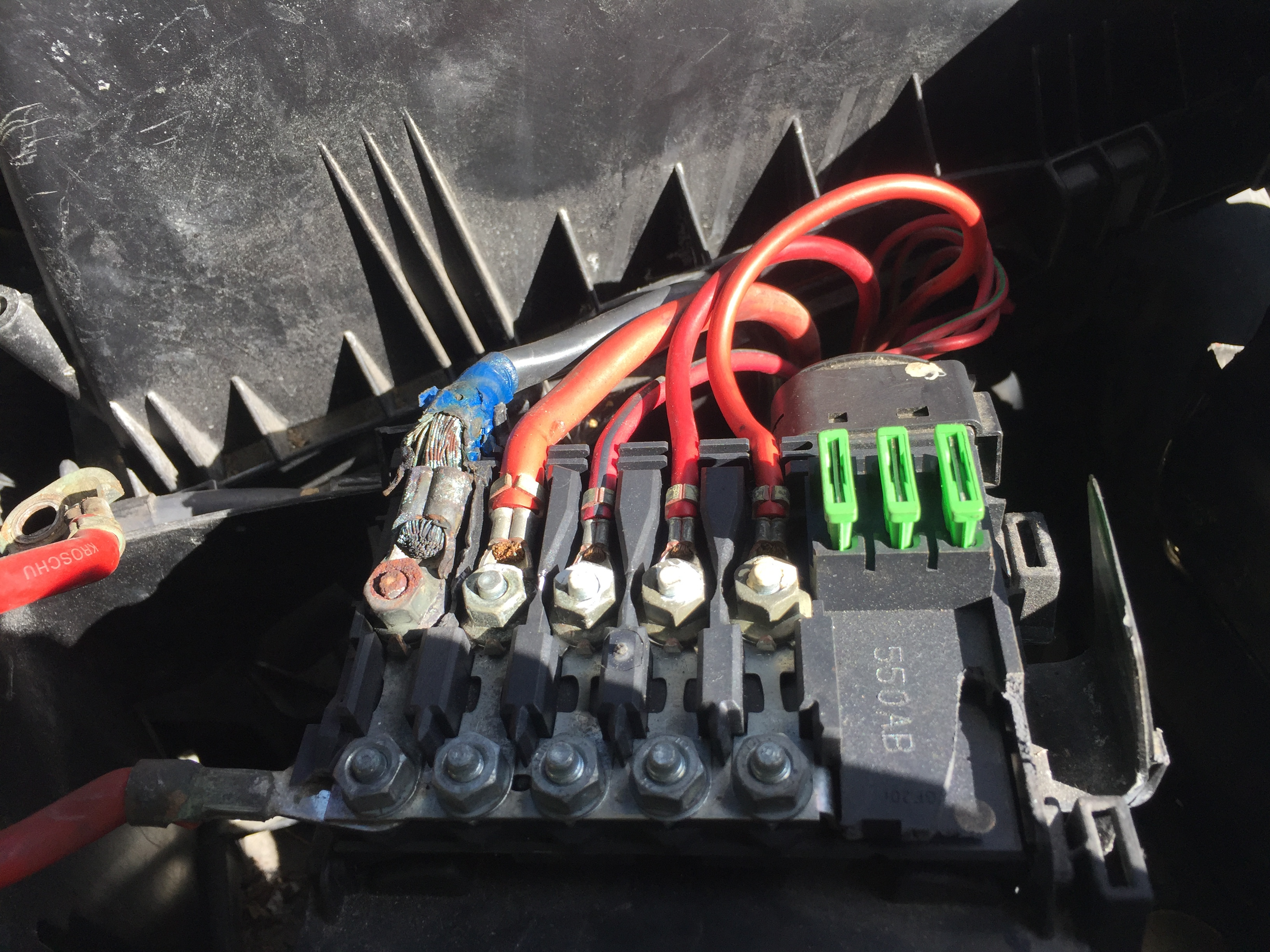

Well , the fuse box + battery cable is pretty corroded . Bought a battery cable to replace it. I'll cut a notch to install into box. My question " What to do with the connection end of cable in fuse box ? " Tape it up , cut off ? Don't want to have a bare wire in the fuse box . There 's not much slack in it to pull it out of box . I'd appreciate if anyone who has replaced this wire to chime in on how you secured it .
- Posts: 36137
- Been thanked: 4064 times
Let's see a picture of this bad boy.
I'll show mine first.
