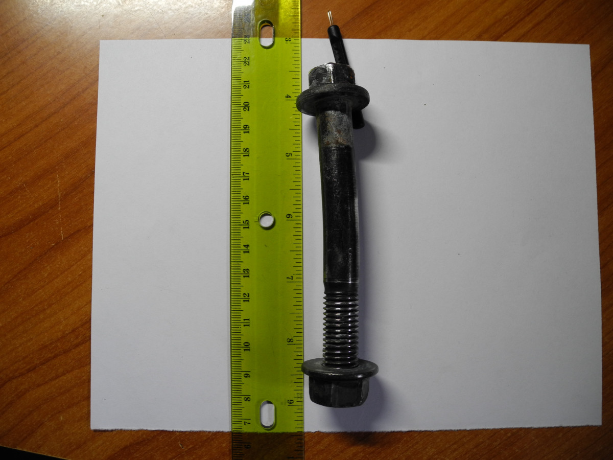

My description maybe a bit too long and causes confusion. Hope the following timeline clarifies:
Sept 2019 - oil change at Pepboys - I don't think it's related to the incident
Jan 2020 - wheel alignment at Pepboys. - I don't think it's related to the incident. Also, No service on control arm, etc at all (!!) that I may have misled some of you
Feb 14 - hitting curb
Feb 15 - incident, lost of control, towed to dealer's service dept
Feb 20 - inspection by insurance, deemed not from wear and tear, incident no fault to me. Agreed to pay beyond the deductible
Feb 24 (today) - parts should arrive, replacement of control arm/bolts on left side at dealer's service dept
Thank you for the advice on the thread. I will request dealer's service dept to also replace the bolts on the right side.

Old thread but still worthy of discussion.
I think the failure here was the nuts came loose and the bolt machines the visible groove into the bushing and control arm. That’s wear, not impact damage.

Glad you were not injured in what must have been a very scary moment. Recently on my 1998 S70-T5, the forward bolt of the two lower control arm bolts, on the left side, broke allowing the arm to move away from the mount point. Fortunately I was just going up my driveway, with the steering locked all the way to the left for the turn, when I heard the most unusual noise as the control arm moved back and forth after straightening the wheel direction. I have usually replaced the bolts when changing the arms but maybe retaining the Volvo hardware is safer than using the newer imported hardware.

800artfreed wrote: 07 Jan 2023, 13:28 Glad you were not injured in what must have been a very scary moment. Recently on my 1998 S70-T5, the forward bolt of the two lower control arm bolts, on the left side, broke allowing the arm to move away from the mount point. Fortunately I was just going up my driveway, with the steering locked all the way to the left for the turn, when I heard the most unusual noise as the control arm moved back and forth after straightening the wheel direction. I have usually replaced the bolts when changing the arms but maybe retaining the Volvo hardware is safer than using the newer imported hardware.
Thanks for sharing that art. Wow!
Moving forward
Volvo says replace the LCA bolts with new on removal. That means Volvo bolts, not the crap at Lowe’s.
I confess I have reused the strut bolts many times, but I’ve been religious on the LCAs. They literally keep the wheels on the Bus
