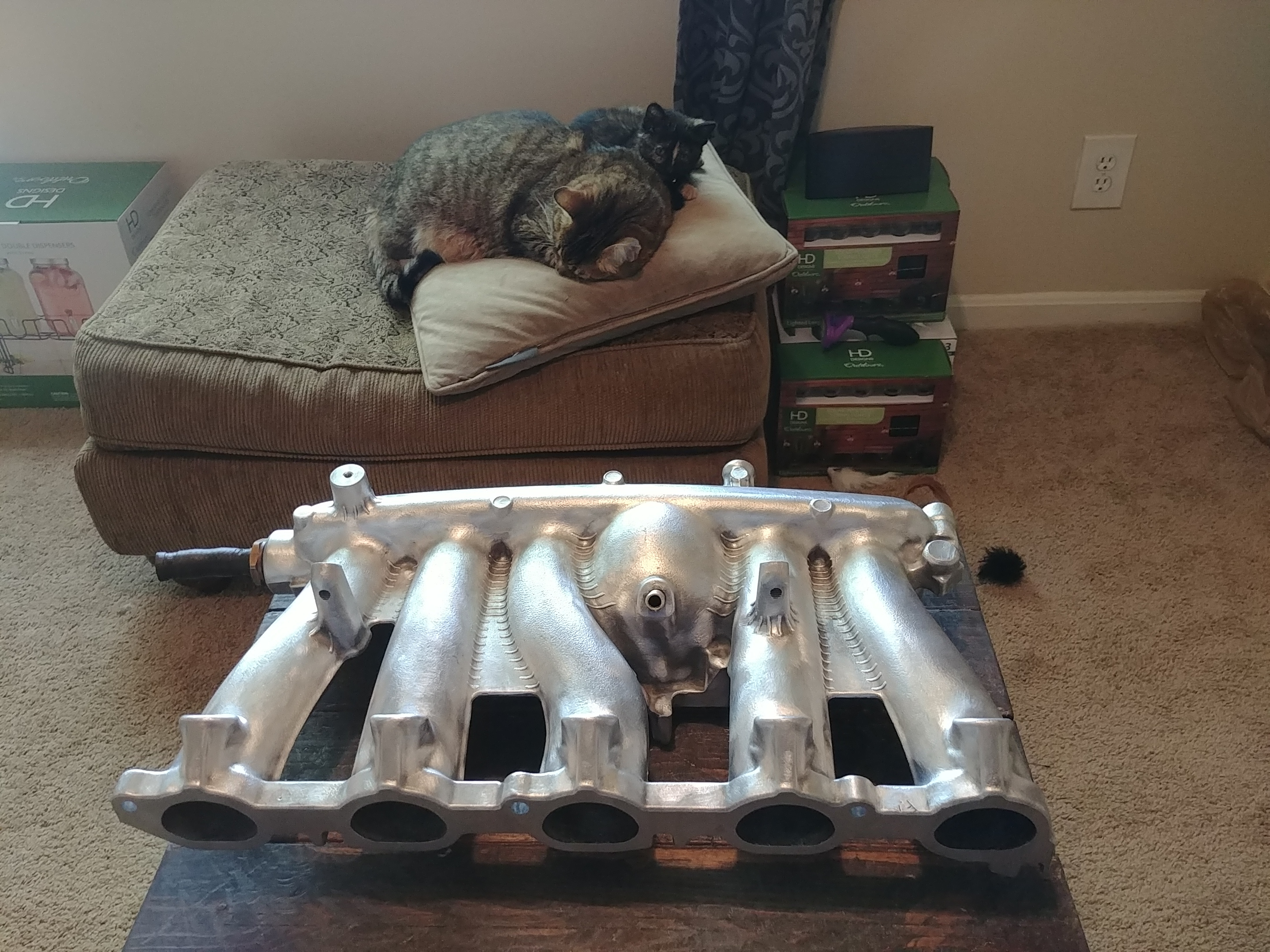

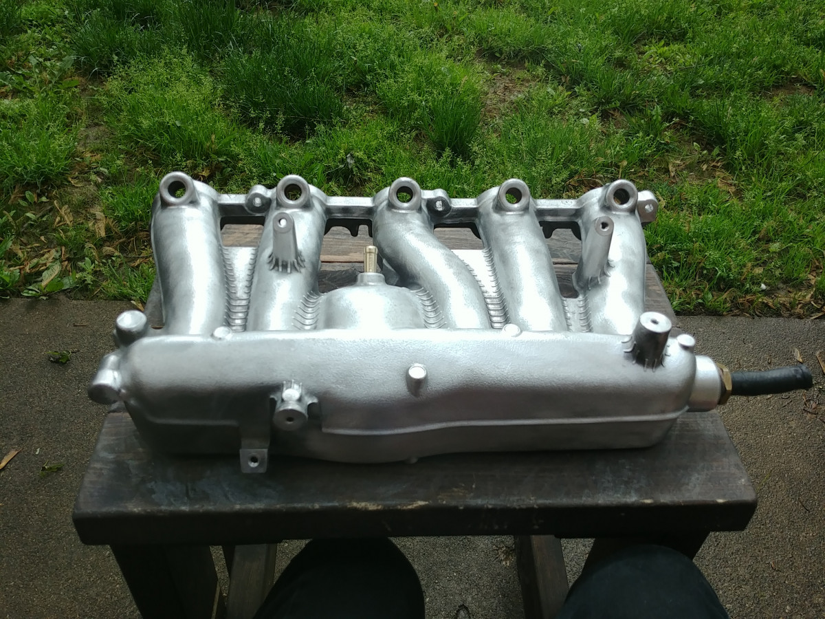

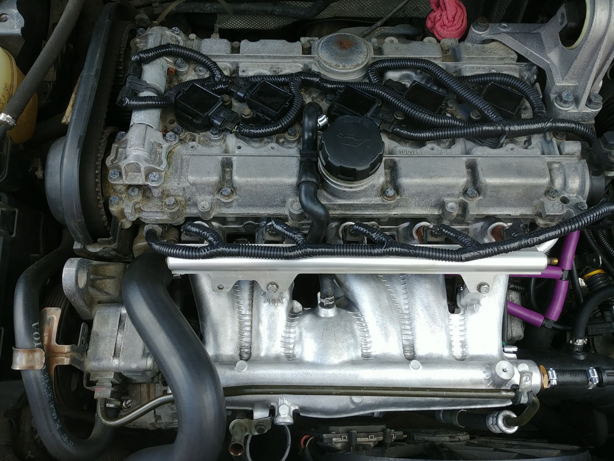

Replaced the spark plugs, coil packs, coil pack wire harness, checked injectors, wired in new fuel rail wire harness. Problem still persists. Codes. P0300, p0301, p0302, p0304
Thinking head gasket needs replacing.

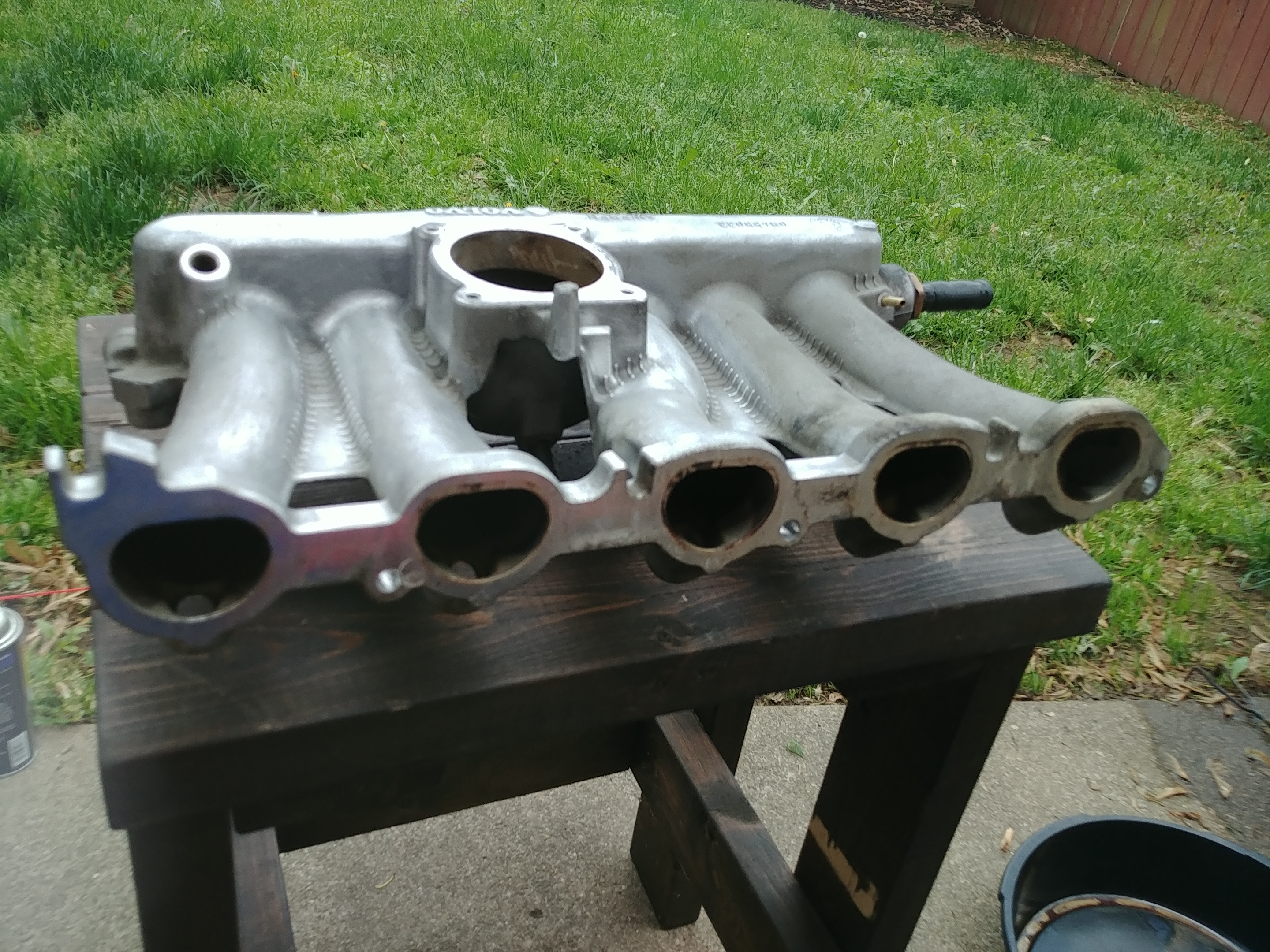

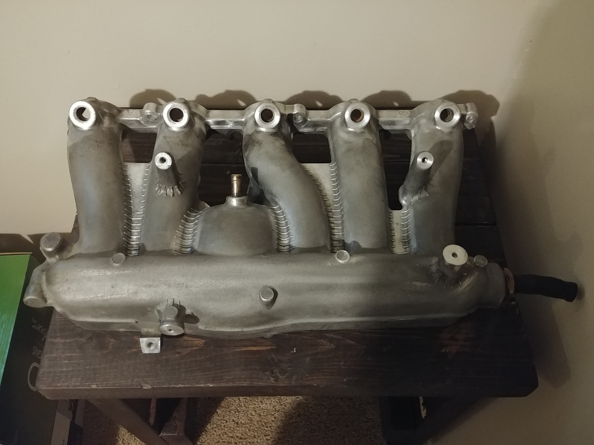

And cleaning that manifold really makes a difference. Before and after pics.

What did you use to clean the intake manifold? It sure looks great.

I have a couple questions for you.
I can’t tell on the coils; I tried zooming in on the high resolution images but I can’t quite make out if there is any writing on the tops of the coils. If they are no-name-brand/Chinese cheap coils, they will be blank & I would not be surprised if one or more of them are dead right out of the box. Also, what did you go with for plugs?
Now, before you buy more coils, have you checked your compression? Did you take a close look at your injectors, & possibly clean them?
From the looks of it you are doing very meticulous work, nice job on the wire loom!
Also, nice job on the intake plenum! Most of mine have mouse piss & years of ugly stuff on them
