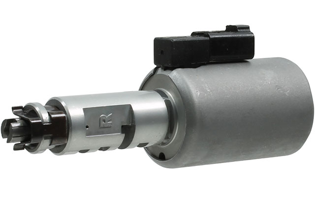

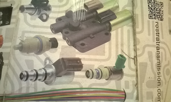

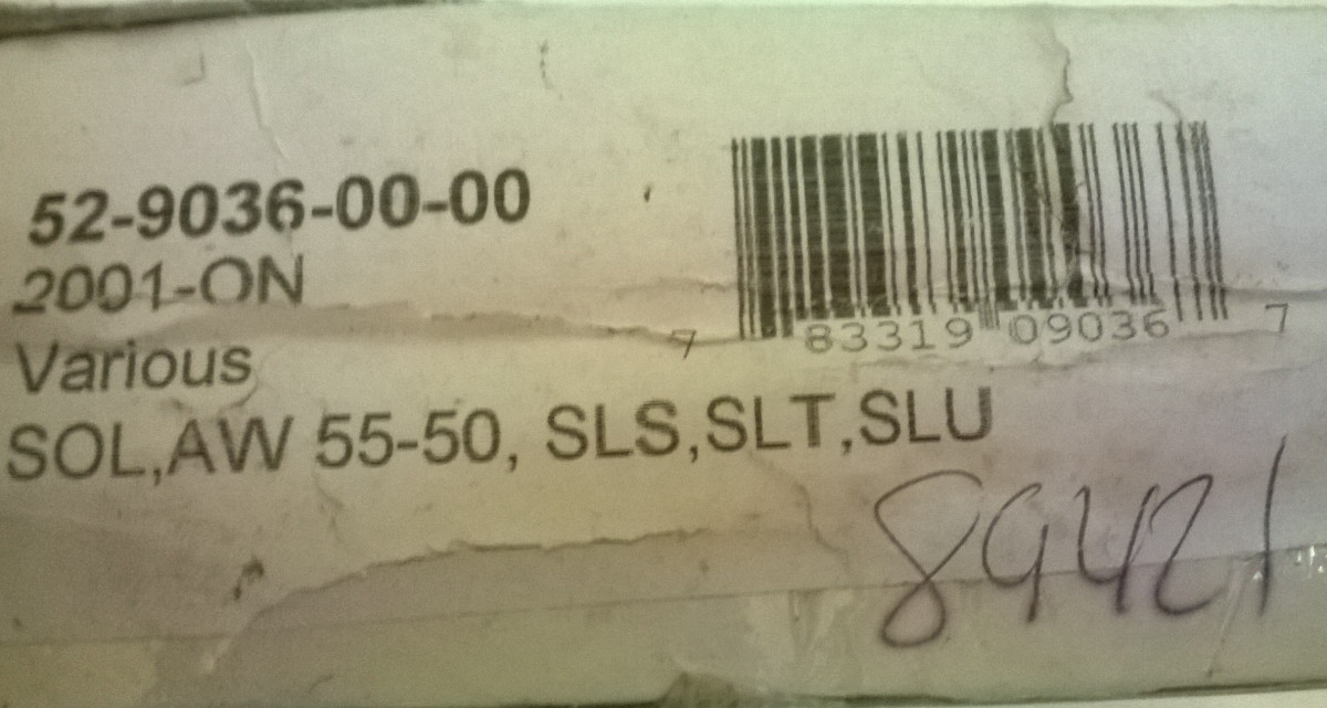

What is really important is to know many Ebay sellers are scammers shipping chinese solenoids different that what their listing pictures show. With that in mind, this one 'seems' legit, but 2X and triple check yourself (seller transpartsnow503) https://www.ebay.com/itm/AW-55-50SN-55- ... Sw74Bc7p2l
For example, there is another seller who has them for $115 but has many neg reviews. Better pay an extra $30 and get the real Rostra. Our Volvos have Rostra and one can quickly compare the original ones with what they get from Ebay
Also never buy 'remanufactured' ones - they are cheap but I'm quite sure it's a bad choice - most surely just used solenoids put on sale
Pic of the genuine box I got 52-9036-00-00
Pic of a Rostra solenoid with the machined surface and stamp
