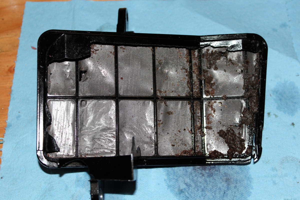

There's a good chance the sound is due to a mostly clogged and restrictive trans filter and this would explain the other problems you're having such as the harsh reverse. The gauge pressure readings will confirm if there's a problem with the pump pressure due to a restrictive filter.
Assuming the filter is clogged up you'll be facing the decisions of doing a long term fix that requires pulling transmission and rebuilding or replacing with a known good one or as described in the link below drilling and tapping the bottom of the case (clever idea, see link) to get access to the filter screen for cleaning or poking holes in it. This would be a shorter term fix where you're just trying to get some more miles out of the transmission. The condition of the rest of the car may help you decide what to do next if this is your problem.
Before I decided to rebuild my transmission I did go ahead and cleaned the filter screen because I was considering a rebuild down the road and didn't want unfiltered fluid circulating through the valve body and transmission with the poked holes method. I was successful in cleaning about 75% or more of the screen surface and I think this would have kept my transmission going for an extended amount of time but I didn't find out since deciding to just to rebuild it for an even longer term fix. With my car I had just done a lot of other maintenance work (tires, battery, PCV, oil pan reseal...) so decided to fix the transmission. I only put about 500 miles on it after cleaning the filter and it was working well. When I opened up the filter during the rebuild I was surprised how well I was able to clean it through the drilled hole opening. There was a very shallow areas where the case of the filter narrows down close to the screen that I could get completely clean as you see in the photo but overall I got most of the surface cleaned up,
[attachment=0]filter screen after cleaning.JPG[/attachment
my post about cleaning the filter is the March 22nd one
viewtopic.php?f=9&t=82841&hilit=clogged+filter
The thread is long and I recall Precopster mentioned something about blowing air through the trans cooler line to help verify if the filter is clogged. I didn't try this but it did sound like a quick and easy way to check if he filter is completely clogged. It's not a long lasting fix it sounds like it may blows just enough crud off the filter fo get some fluid flow. In your case though where the filter isn't completely clogged I don't know how effective this would be but it might worth a try before deciding on other courses of action, such a drilling a hole in the trans case.
