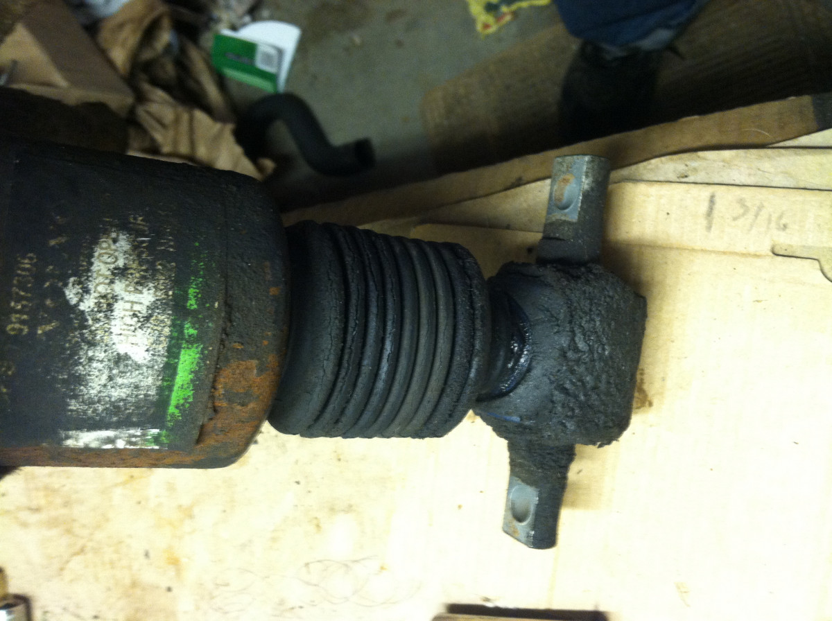

Nivo's have made it to the border, Proctology exam is likely underway. Looks like the boots mentioned in the repair thread are close to NLA, one online Dealer says national backorder with 3-6 week availability, but a big dealer complex in DC said over the phone they think the part number is headed for the "retired" list. The adventure continues.

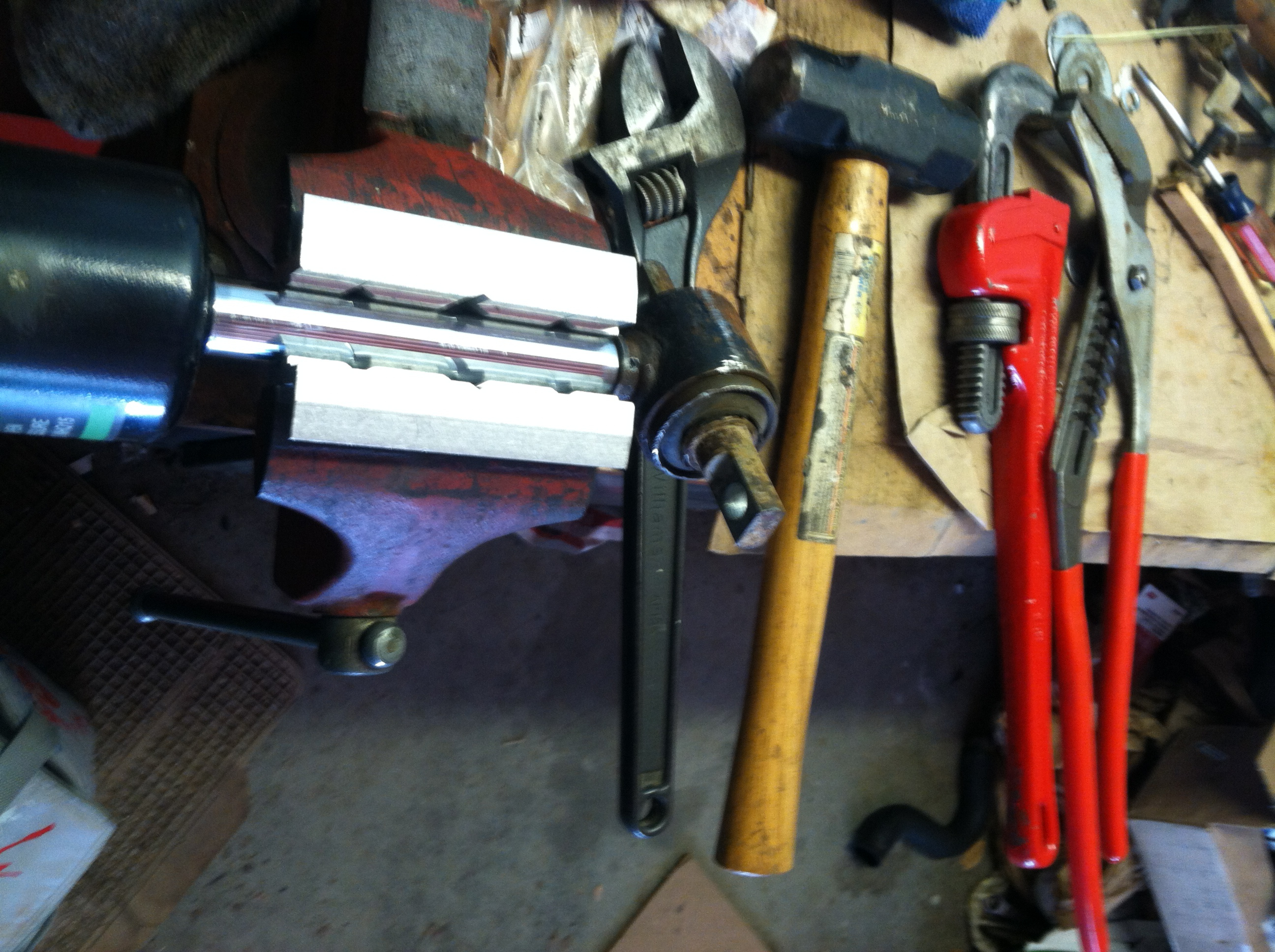

I recall it took a sharp whack with a hammer to break it loose. Obviously taking care not to bend the shaft. A large pair of pipe pliers/wrench would also help.
Glad they arrived ok. Hopefully you can find a boot option that works for these.

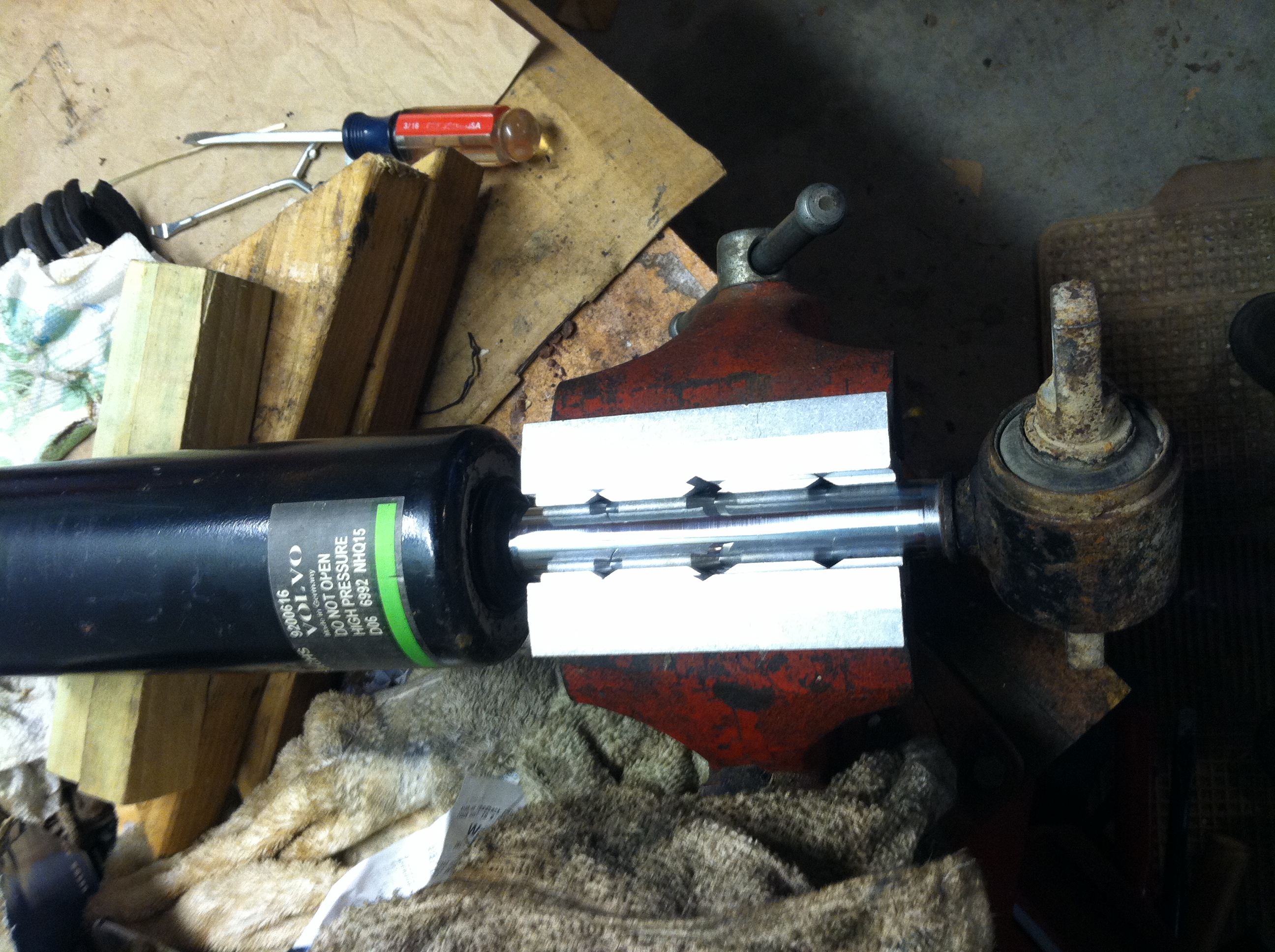

Depending on how you do the math, I'm, like, 5/8ths through the Nivo replacement.
I think I found the problem with this side.
Still no luck removing the bushing fixture from the other replacement.

So far, these are the weapons brought to bear (butane pencil torch, not pictured);

It's official, the boots, 1387105, are no longer available. I had placed an order with Tasca and they just cancelled it and issued a refund. Skanix claims to have them over there, but shipping is 125 Euros.
