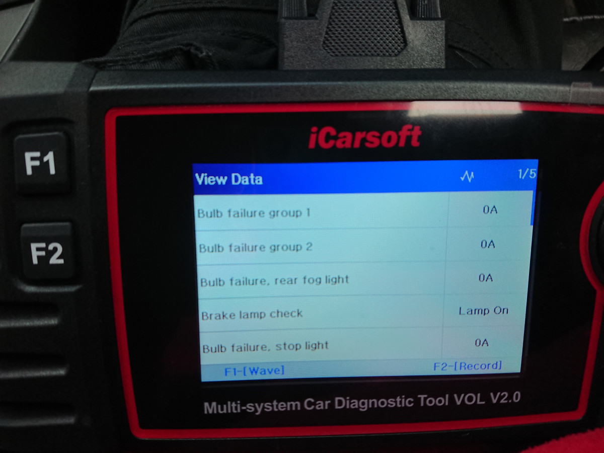

OK so... Today I hooked my icarsoft to dad's v70. When lights on live data shows a resistance line of (plucking a figure 0.75 went up to 0.78 when I tapped his rear light making the down bulb light (it was for exploratory purposes
Mine runs a flat line on all feeds for brake possition and rear fog lights.
Canbus failure?
I'm assuming all of those systems run their own comunication line to establish the level of resistance?
Group 1 being sidelights/position
Group2 ? Headlights? I'm not sure I'm not getting a warning on headlight or front fogs but I can't find a live data feed for these. (I expected that to be in the cem)
Canbus failure?
