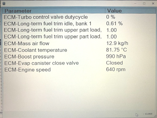

Yes, replaced the MAF and TCV when putting new pipe between MAF and turbo. The tcv hoses are the colored IPD silicon hoses for easy routing and connection, also made sure that the three hose connection and sensor at PTC were snug.
ERASE ALL procedure on error codes captured on 9/25. And followed by a warm engine ETM test, and then the 3-minute x 2 ETM reset procedure -- the Difference value 0.32 with Max Diff at 0.58º.
I can capture additional set of parameters, meanwhile, here is a vehicle information on following parameter at idle:

No leaks with they LTFT. The threshold on later engine management is about 20%, for the code to set.

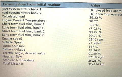

The test drive returns ECM 6806: Turbocharger control system flow fault - Flow too high. Would the Flow Too High due to Signal too high OR Signal too low, cause?
For Signal too high, it reads, air leakage after turbocharger
For Signal too low, it reads, hoses between turbo and tcv
Here is the Frozen data for ECM 6806:

Do you have your old TCV?
xHeart
Posts: 3321
Joined: 03 Dec 2011, 08:05
Year and Model: 2.0/3.2
Location: Great Lakes - USA
Has thanked: 116 times
Been thanked: 119 times
Post by xHeart »
vtl wrote: 27 Sep 2020, 18:03 Do you have your old TCV?
Yes!
vtl
Posts: 4926
Joined: 16 Aug 2012, 13:35
Year and Model: 2005 XC70
Location: Boston
Has thanked: 129 times
Been thanked: 686 times
Post by vtl »
xHeart wrote: 27 Sep 2020, 18:54 Yes!
Try to swap it back? :)
Also did you do a vacuum test for membranes in wastegate and in CBV? When they tear the pressure coming from turbo becomes erratic, not what ECM expects.
