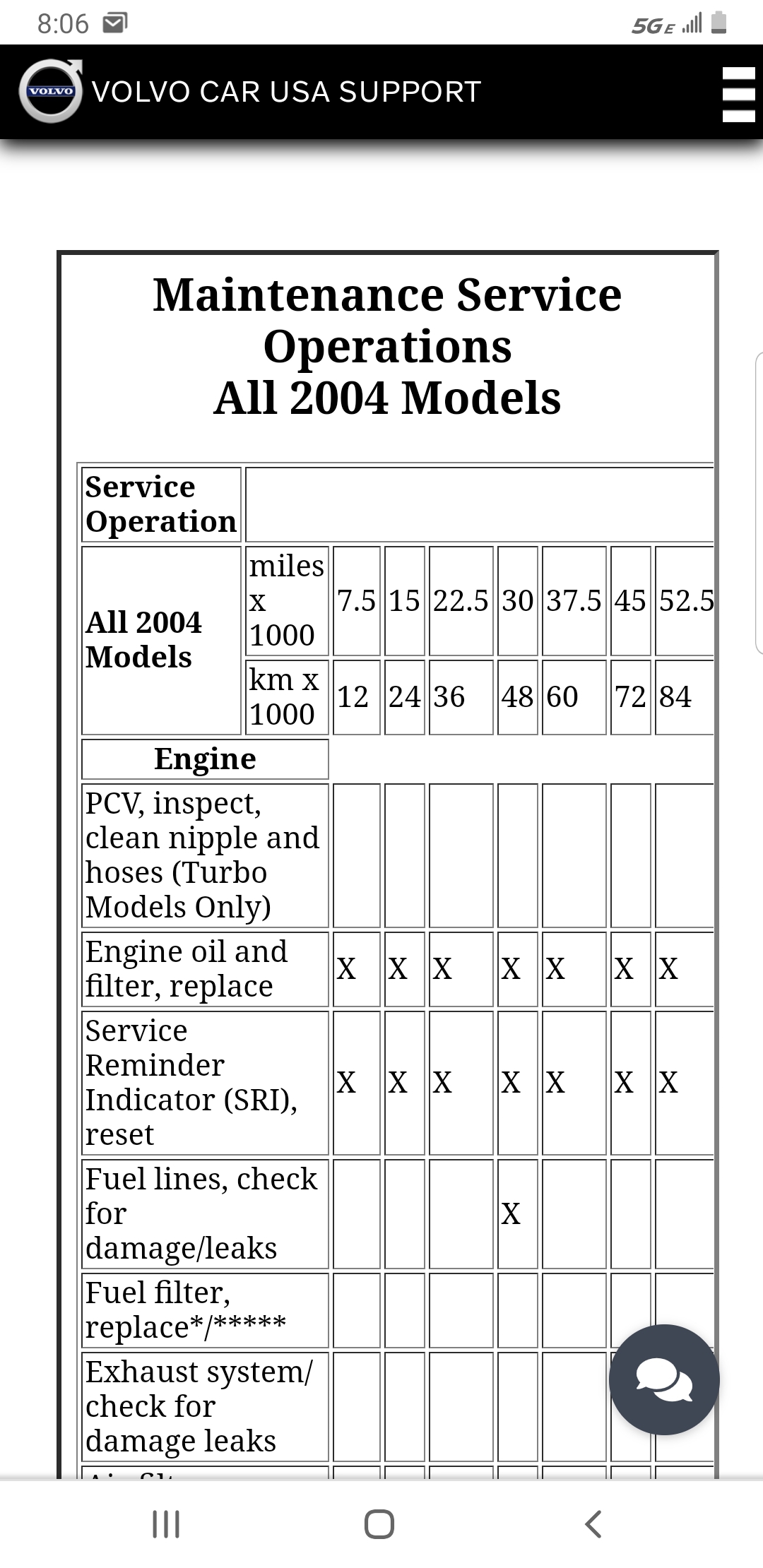

I think this is self explanatory. 5000 miles is the severe duty oil change interval. There is nowhere Volvo recommended 10K OCI for any 2004 model. June
