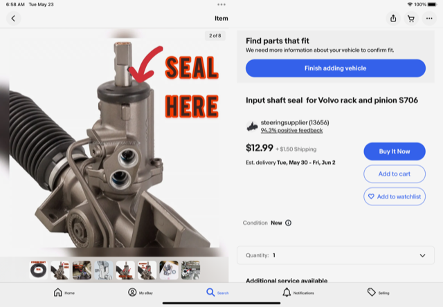

I just did a quick search on eBay and this is what I found..

- IMG_0550.png (203.08 KiB) Viewed 521 times
