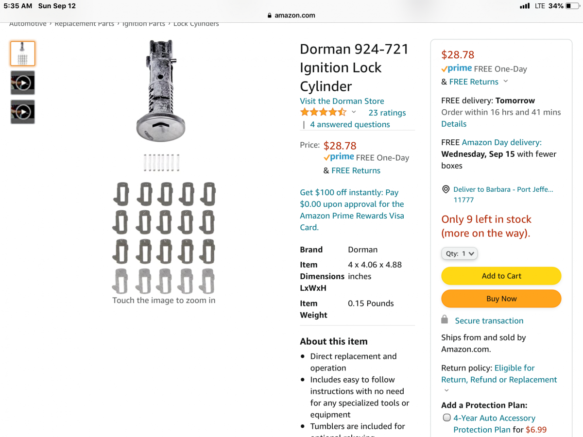

Hmmm. My understanding of how these locks and tumblers work is incomplete.
This Dorman kit shows all the tumblers are the same. Maybe the key code is selected by where they are set in the lock cylinder? Once I get Evita apart, I’ll know more

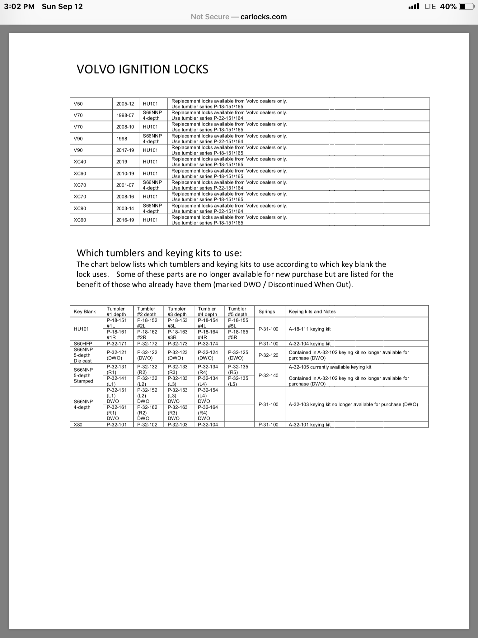

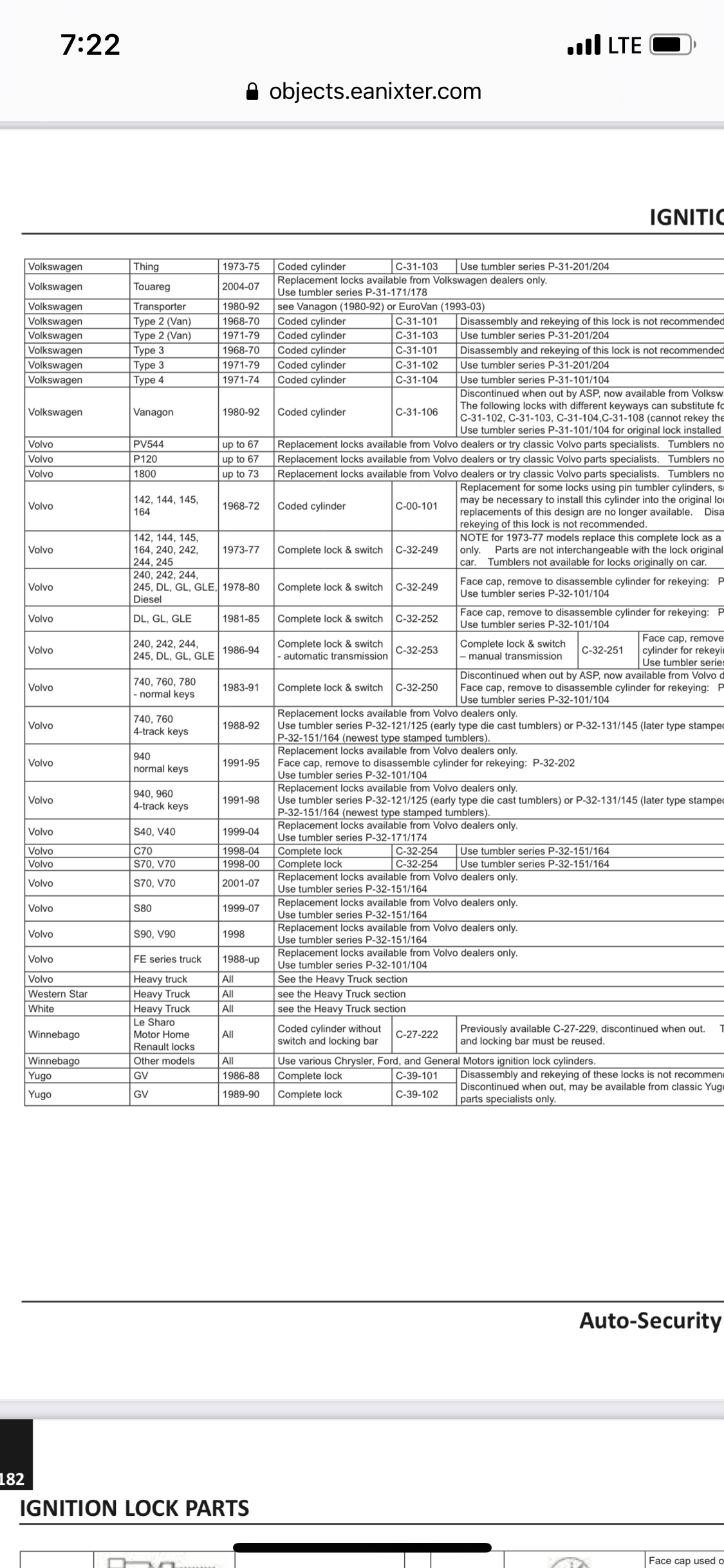

More research. Have found the tumbler set for Volvo. The key is described as a 4 depth, I wonder if that is the number of positions per tumbler
https://objects.eanixter.com/PD508431.PDF

That is basically how all keys work since they were all invented. The undulations on the 'keyed' part of the key moves up and down to move the tumblers to the right height to catch on the outer part of the barrel. Too high and the key won't be able to go into the slot, too low and they won't catch the outer barrel. So basically, you have to find the correct parts that give the profile of your key. A slow laborious task but do-able.
Still think new basic keys and gluing one with the key chip under the dash. You will probably still find it will out live the car.

Neil, that’s definitely plan B if I can’t get the newtumblers to work with the old key.
But, more knowledge gained.
The tumbler kits are no longer made and are “DWO” ...locksmith code for discontinued when out.
But we have a source for these....the door locks and trunk locks use the same tumblers.
There are indeed 4 distinct tumblers in use so rekeying will involve getting your tumbler choice right.

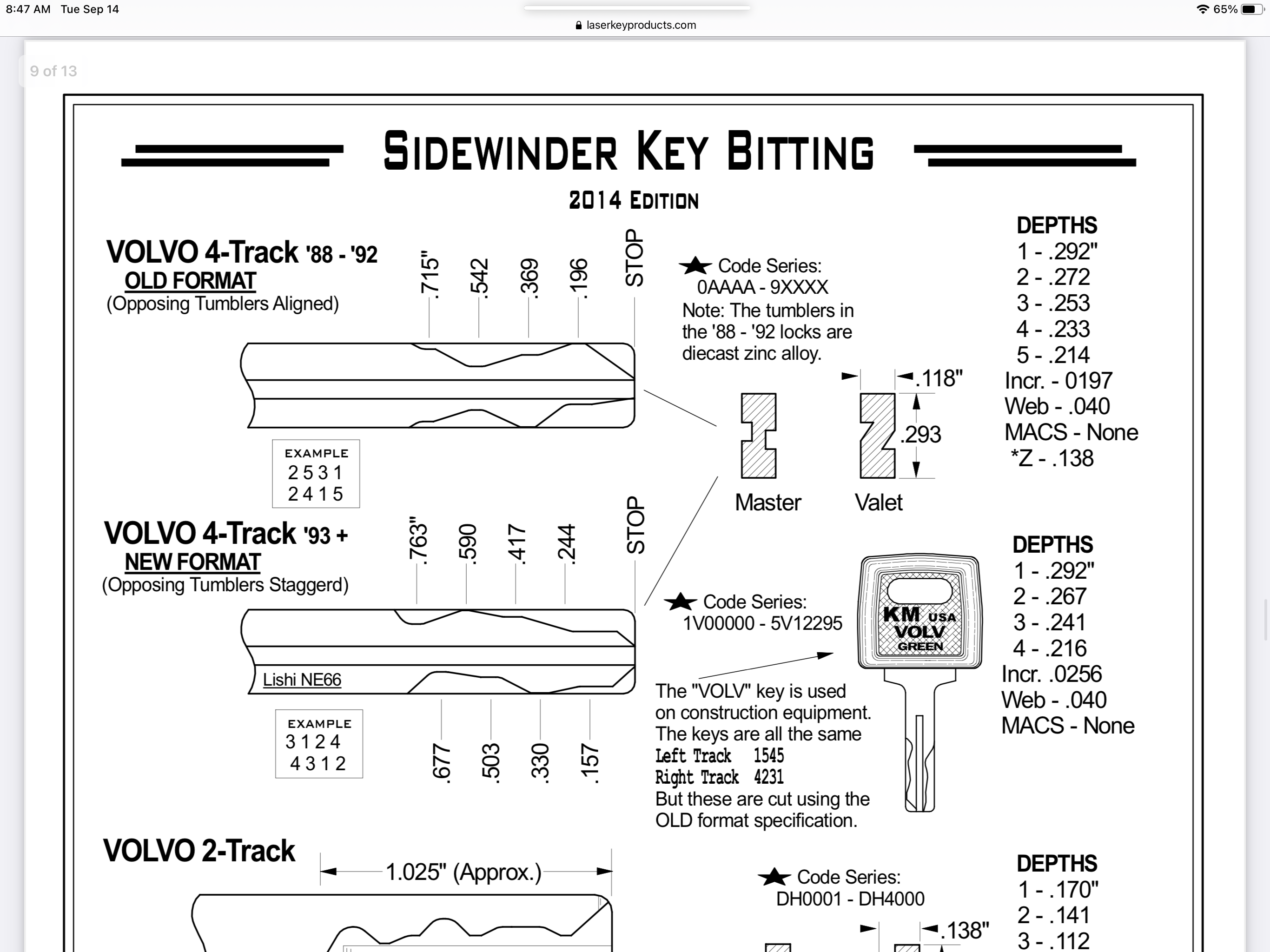

Post by volvolugnut »
Notice the Volvo 4 Track New Format note in the center of each image. "The VOLV key is used on construction equipment. The keys are all the same."
