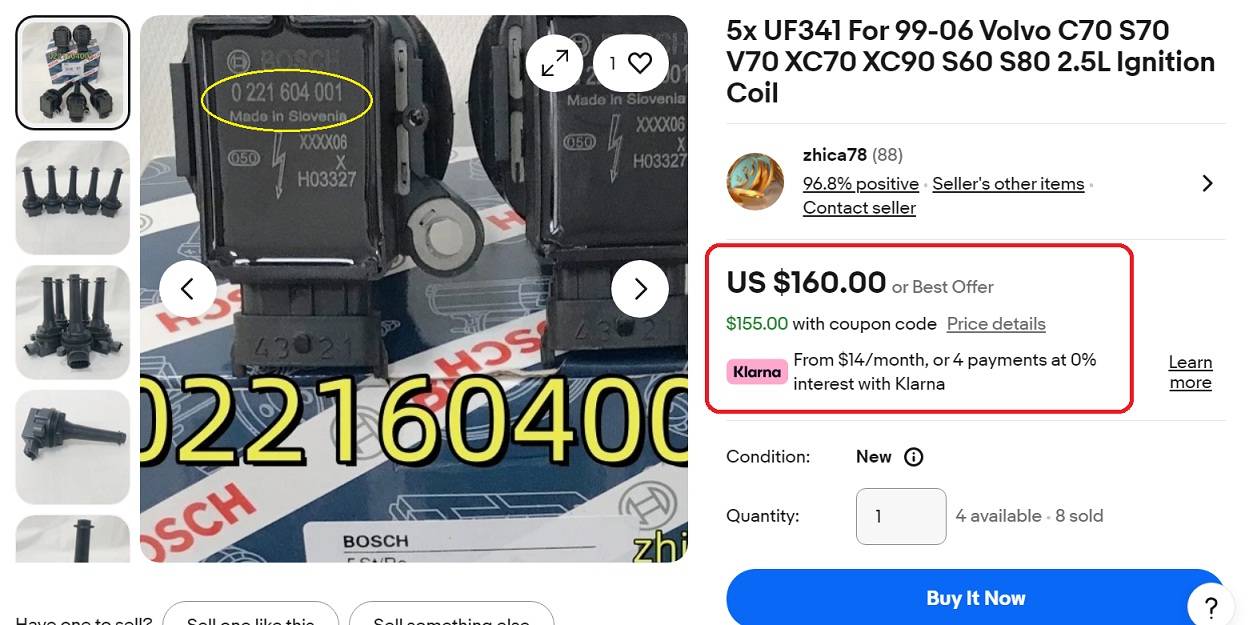

I understand Bosch is the factory supplier of Volvo coils.
Has anyone here used the Bosch coils from eBay sellers?
As you know, NOT all eBay sellers are shady, some sellers sell genuine Bosch stuff...In the attached photo,
it shows coils made in Slovania.
For comparison purposes:
- eBay seller: set of 5 Bosch ---> $160 for 5 or $32/each.
- FCPEuro, Autohausaz: ---> $240 for 5 or $48/each.
