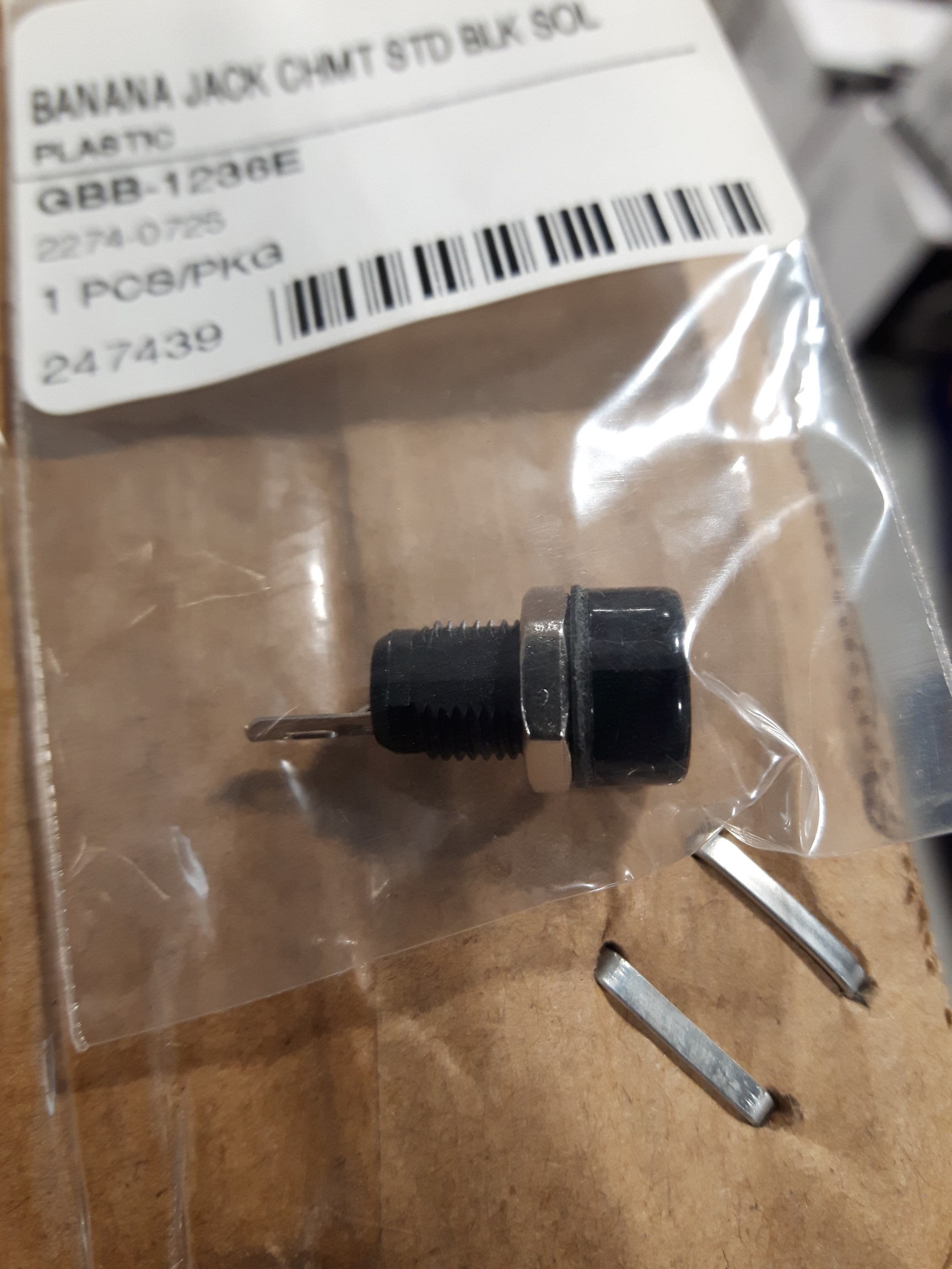

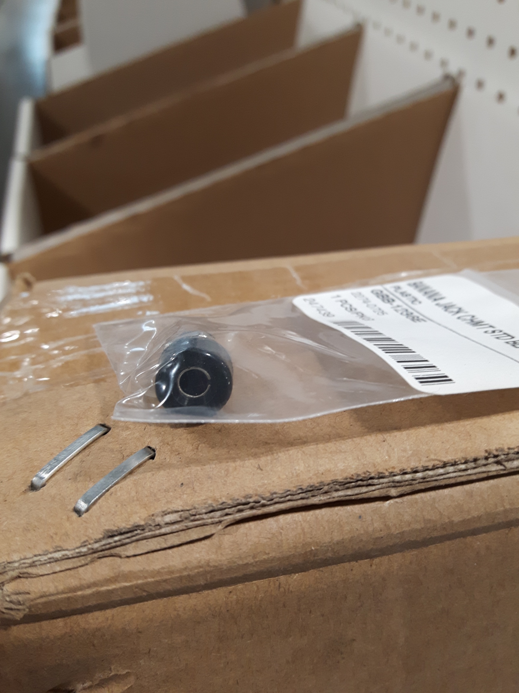

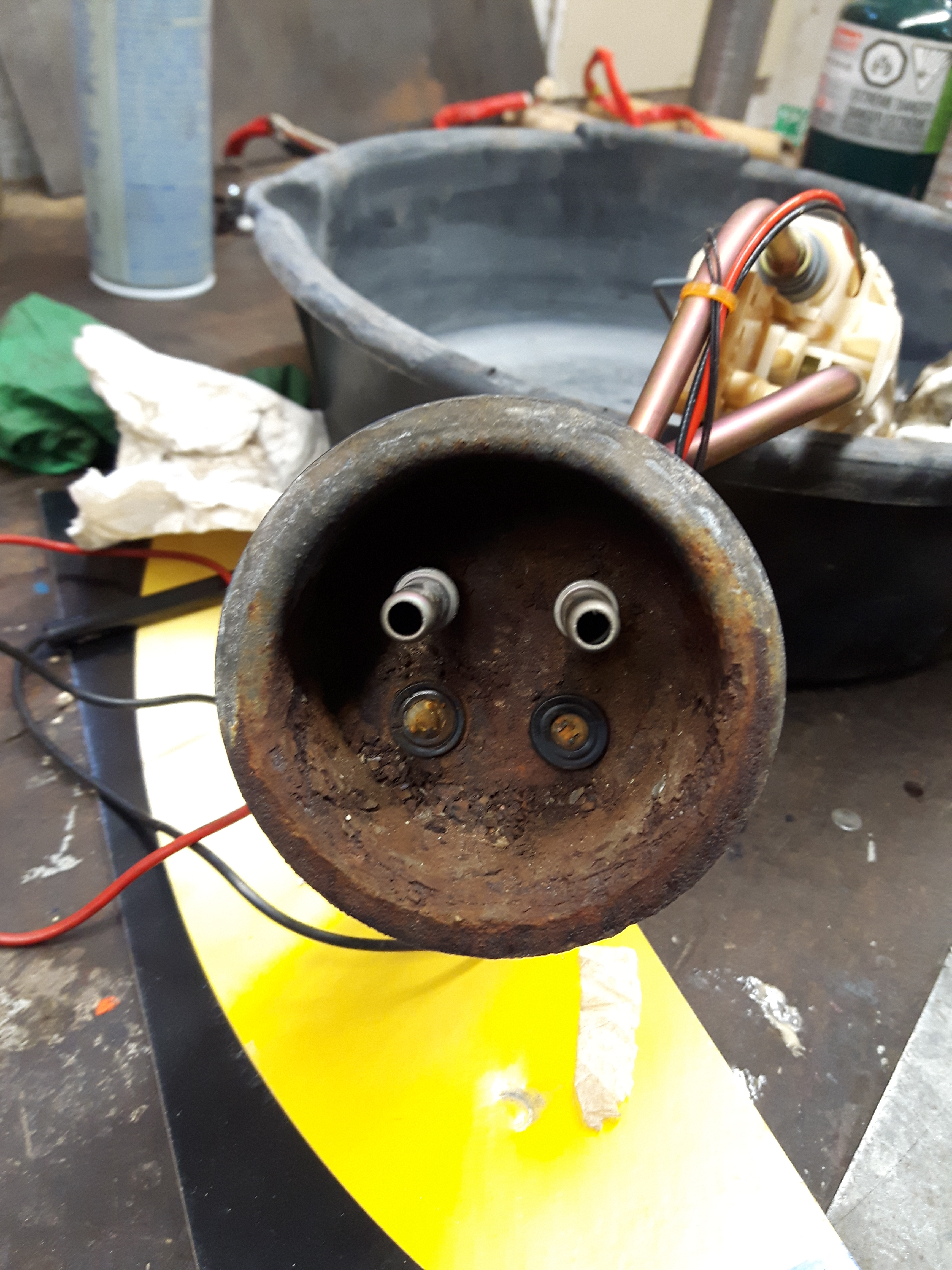

Well I thought long and hard about just repairing wires but i just couldn't come up with and acceptable way to seal the wires against full load of fuel and sloshing around.
check out 3rd pic
https://www.amazon.ca/gp/product/B019BT ... UTF8&psc=1
They are corroded flush to the tank entrance and if I was to repair wires I'd have drill out old connections and to seal it perfectly as to not leak fuel when the tank is full. Thought about a "gland nut" arrangement may work?
https://www.enfieldelectrical.co.uk/upl ... 20SB_1.jpg
I didn't feel confident with the idea of silicon or epoxy although they may have worked?? but what if it didn't??

For those dealing with broken wire syndrome, I made a through hull wire connection on Kat, the S70 AWD 1999 by drilling out the pump wires, putting in a friction fit peice of 8mm CuNiForm 5 cm long covered with epoxy, epoxying both sides to seal, then fed in the wires, then filling the 5 cm tube with epoxy slowly to make a plug.
