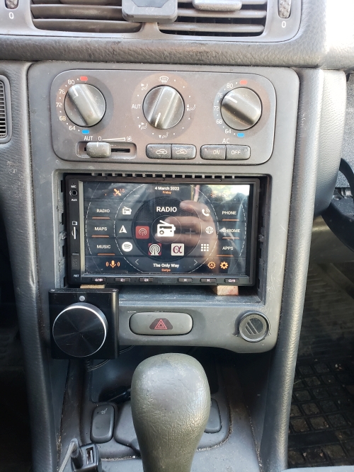

A shim for the win! Found a piece of wood that was the perfect size. And for anyone else who comes this way, removing the climate control box was the key to everything. Thanks so much @MoVolvos for that tip.
Here's a couple of pics, including my anti-crackhead faceplate. I plan to make a bezel to neaten things up but no rush. Still loving the stereo.
