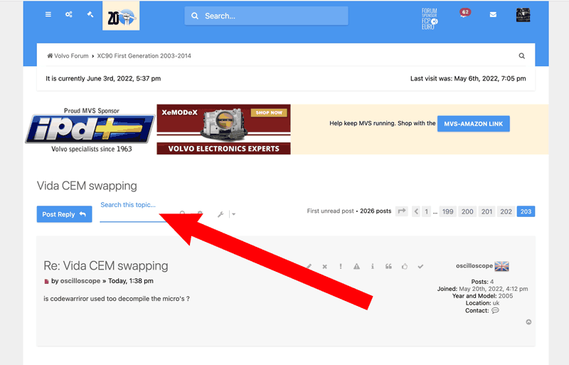

search.php?keywords=tcm&t=85611&sf=msgonly
Hello postoak and welcome. You can search within topics using this. This is what it looks like on desktop, mobile is similar.
