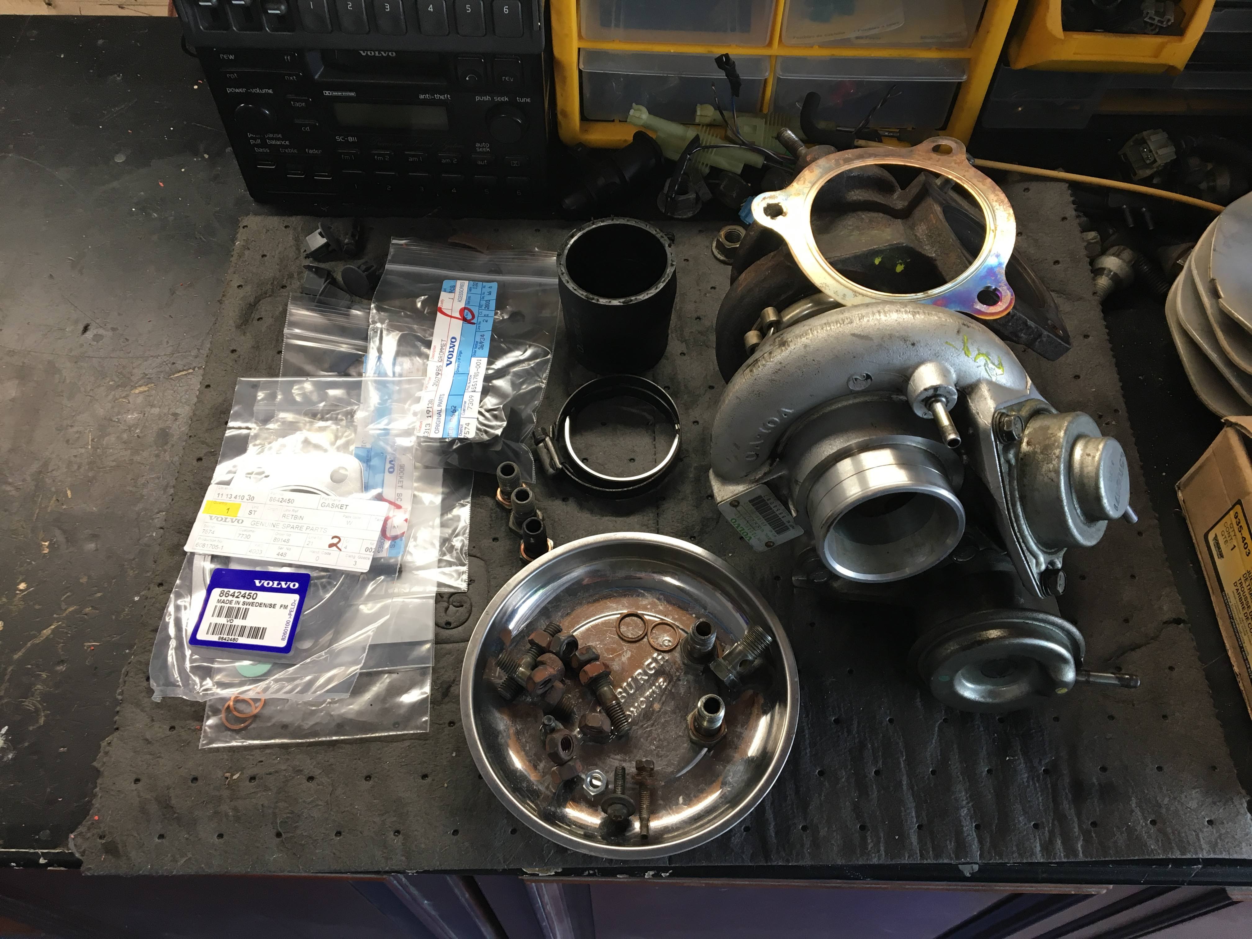

Did some stuff on the S60 :mrgreen:
16t is installed and it runs pretty well! I need to figure out why it won't move now, I have a feeling the passenger side axle isn't seated. The PO told me the transmission just randomly stopped working, and that was that. He towed it home and parked it, then it sat until I bought it.
The car rolls in park and makes a little grind when I put the shifter back in park. Doesn't move in any gear. Interestingly enough, the passenger outer CV boot is torn and the axle seal is leaking. I'll investigate further tomorrow.

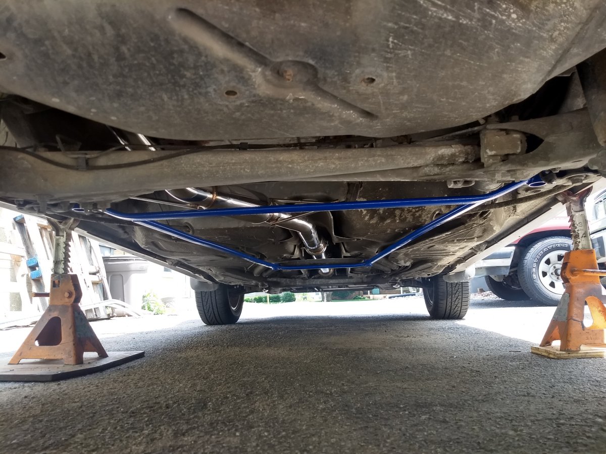

Installed a new SS Maximizer exhaust on the wife's '97 855GLT, along with a used Viva rear chassis brace we had re-coated.
bmdubya1198
Posts: 6338
Joined: 30 December 2014
Year and Model: 2K V70R M56
Location: Charlotte, NC
Has thanked: 304 times
Been thanked: 517 times
Post by bmdubya1198 »
Got the S60 driving. PO was obviously a pro mechanic, because the transmission that magically failed is fine! Turned out the passenger side axle was broken, which would explain the grinding it made when I put the shifter in park as well as the fact that the car would roll in park.
Took it up and down the street and it rides surprisingly well considering the control arms, struts, tie rods, etc. are totally shot.
I'll have to post pics of the old axle shortly. It totally separated right near where it goes into the transmission. Plus the inner CV joint fell right apart when I went to pull it out, so that didn't help.

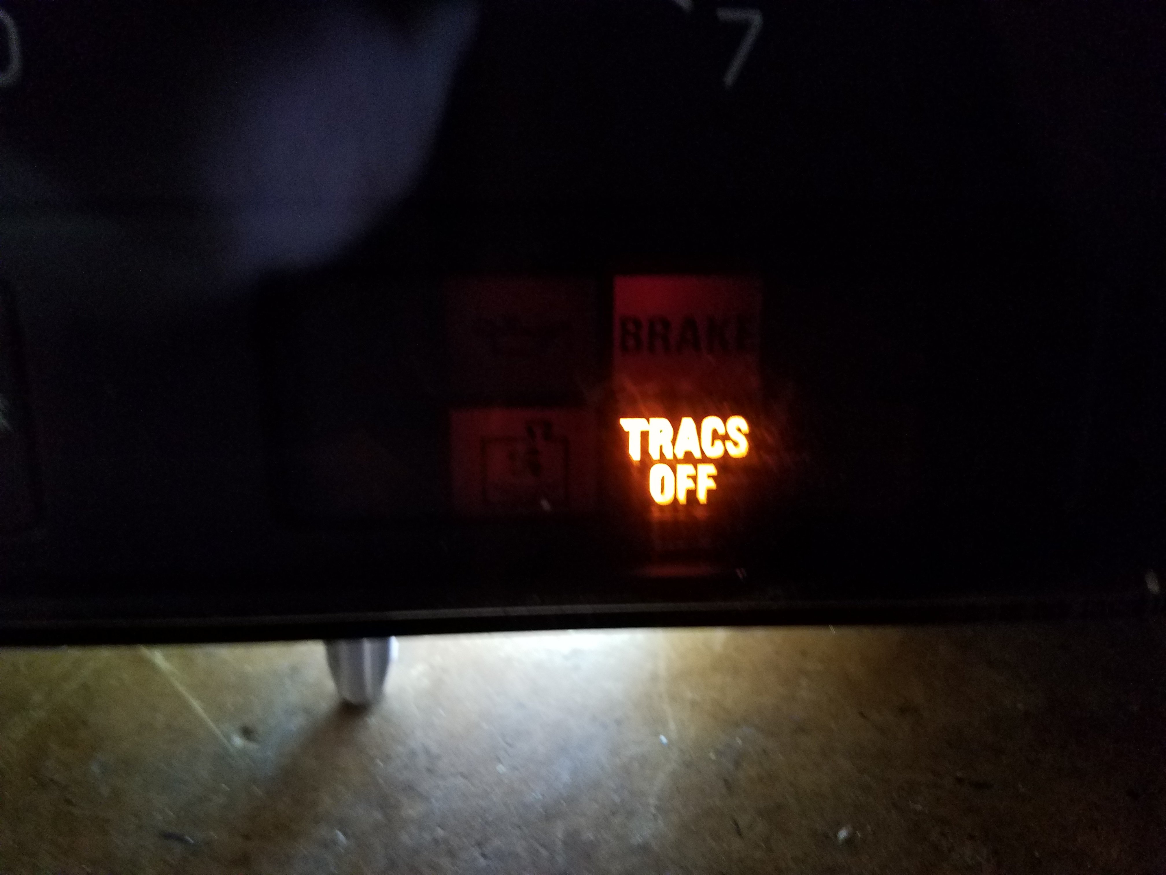

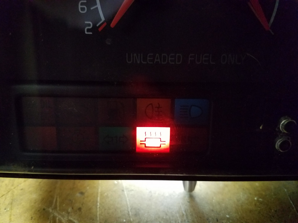

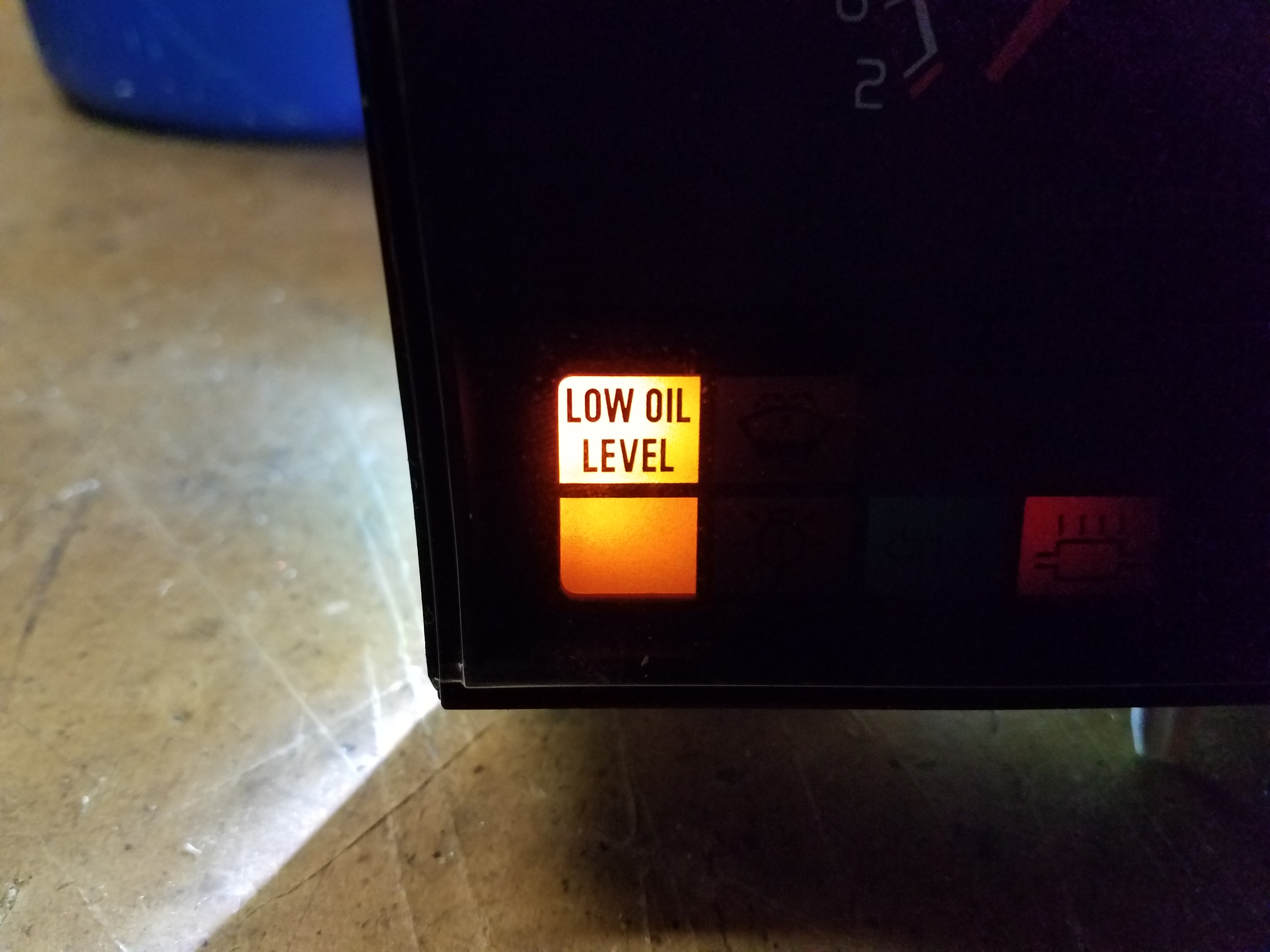

Had a productive session working on the instrument cluster. Correct my mileage and replaced the tiny broken gear. I'm alalsalalso worried I may have damaged some other gear during the repair. Only time will tell.
While I was in there I decided to change out the 4 main bulbs and the 2 smaller bulbs for the info display.
Which dash lights in the VDO cluster are supposed to have bulbs? When pulling the cluster I noticed 4 slots have no bulbs. One is labelled TRACS, which I don't have so not worried. Another is the "LOW OIL LEVEL". There is one blank and the last one is a symbol I have never seen before.
Posts: 35296
Has thanked: 1504 times
Been thanked: 3817 times
Thats the heated rear third seat indicator. It looks just like the CAT overheat warning on earlier cars.
