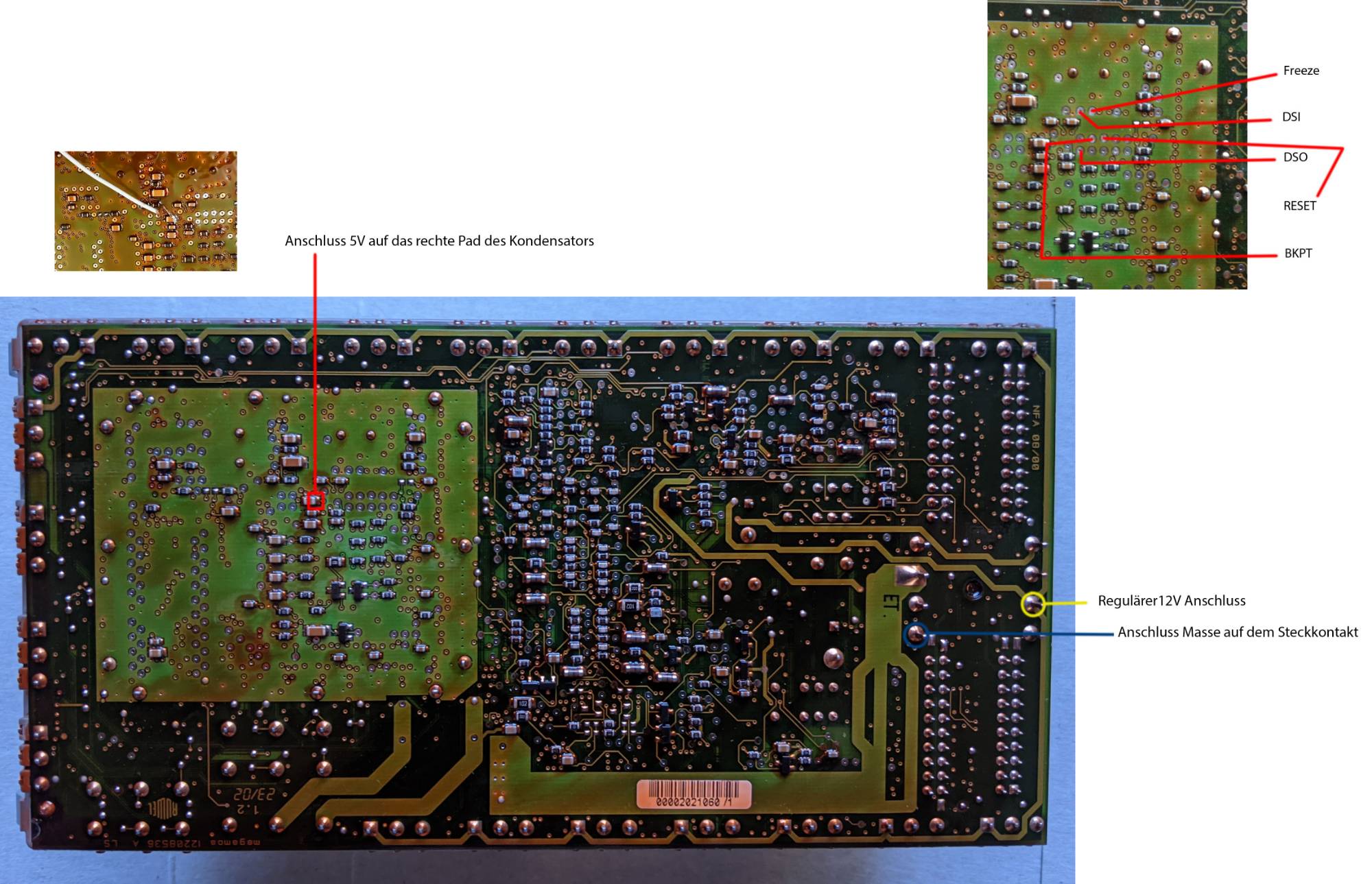

Does anyone have schematic for the pins?
T5Luke
Posts: 142
Joined: 11 November 2020
Year and Model: S60 T5 2001
Location: DE
Has thanked: 11 times
Been thanked: 130 times
Post by T5Luke »
Here...
2 options, connect the 5V line at the capacitor, or connect the 12V at the CEMs main connector. Both connections 5V and +12V are not needed together...
Masse means GND
If you use 12V power supply connect GND from it also to arduios GND, so they should have common GND.

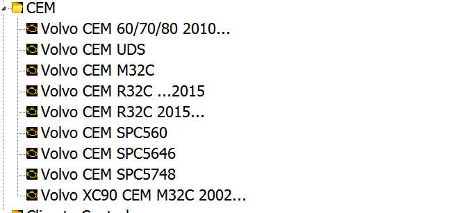

duzi wrote: 21 Aug 2022, 23:46 it seems that the "SMOK UHDS" gentleman also reads this branch. L (H) cem pin reading added in new update,True, with the year 2002 he was mistaken :) ..Guys you make the world a better place t.y
SMOK UHDS works easily.
I tried last night to read the PIN from some CEM I have at service.
2 of 3 are read without problem on the bench. 1st is read in 10 minutes, the second one in 5 minutes.
The second one has a flash from 2012/2013 XC90.
From 3rd won't read PIN, but I think some corrupted flash written into it.
And the last one I tried in my 2008 XC90 thru OBD. In 5 minutes PIN was found.

I was talking to the dev at SMOK and I wanted to know if the 0012 add on works on bench. As it can read all sorts of ecus. Sid807evo , Edc16c34 , newer cems to copy the info for cloning , which might be handy for pin reading.

what's the point, of reading a pin if it doesn't read the flash or config...without ioterminal, still have to remove the module

duzi wrote: 25 Aug 2022, 08:46 what's the point, of reading a pin if it doesn't read the flash or config...without ioterminal, still have to remove the module
Eh ? You don't need iot , you can use xprog , carprog , orange5 (not all mcu is covered) , etl iprog , vvdi things like that. , but if you mean for convince its not always easy. To just plug in and it makes it all happen. Is that what you mean?
