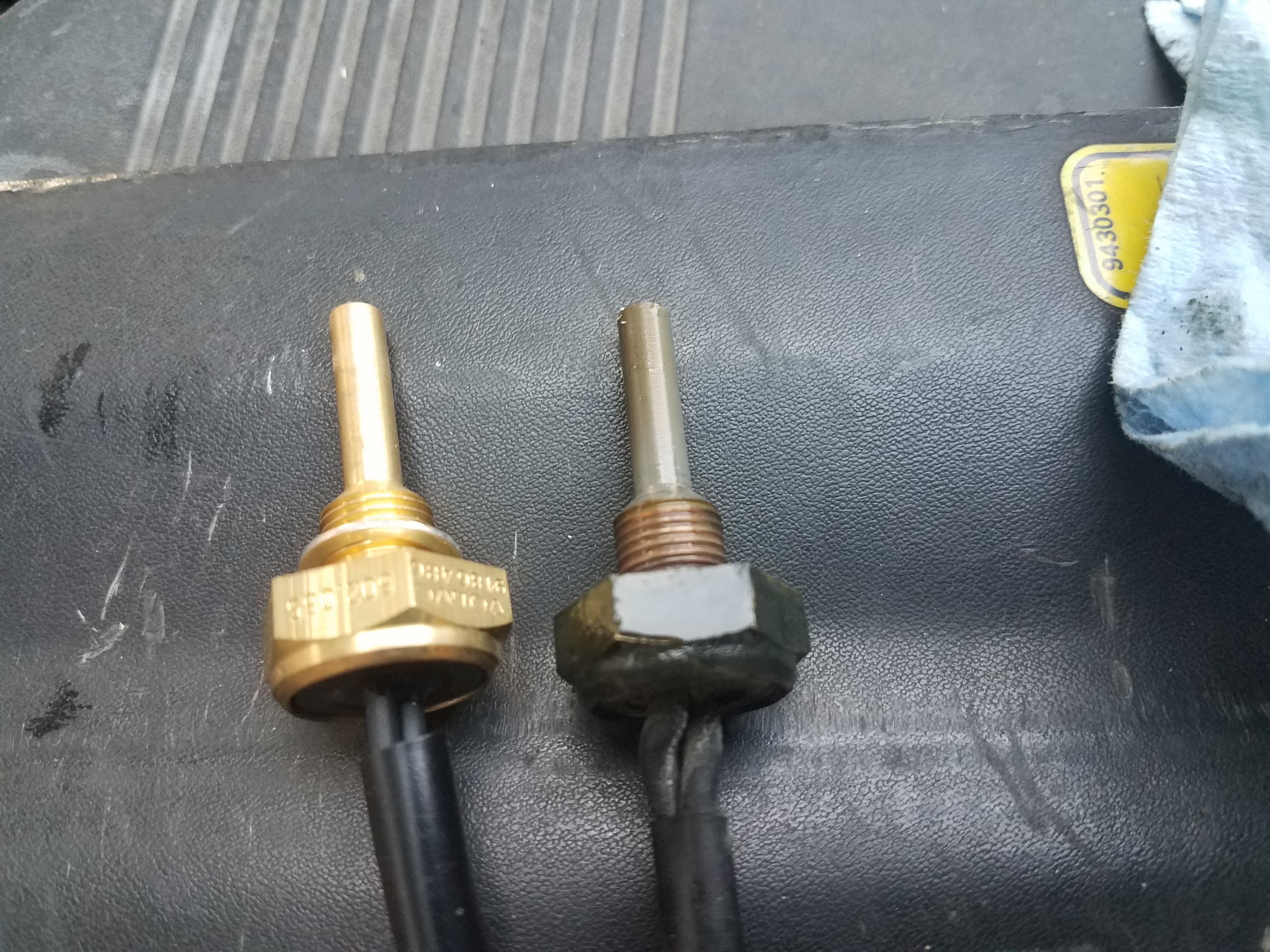

Replaced the coolant temp sensor today. Temp readings are quicker, low speed fan is finally working! Coolant no longer spilling over!
I'm hoping my mileage may change too. Been running rich for a while.
I was surprised at how tight the thermostat housing bolts were even though I just replaced them last week. I decided not to play around this time. I put a thin smear of antisieze on them. I dont plan on fighting with those in the future.
