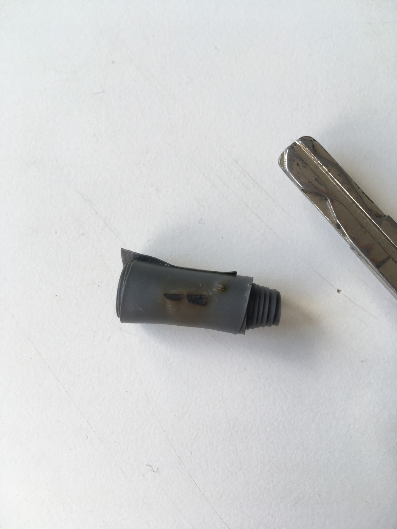

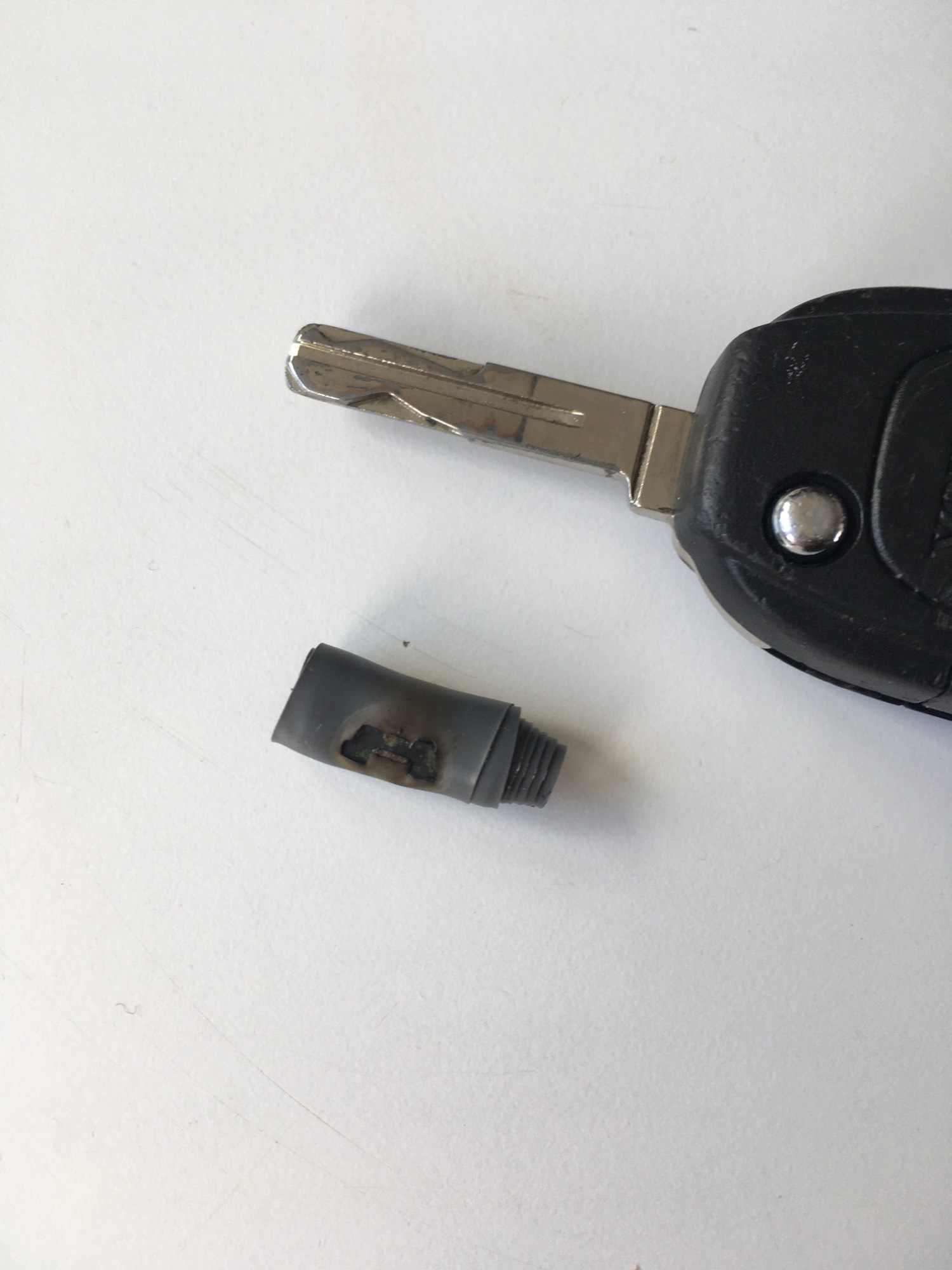

Today it got to 43 degrees F(woot!). I changed a left side low beam bulb (H7 for reference), added a half quart of oil, and checked my sketchy battery. It measured 12.17 V. It starts fine now - wonder if it will make it through late winter and I could replace it in the fall.
A funny thing - someone had put a rolled up duct or elec tape wad between the pins on the bulb. Not clear what that was about. Burn marks (too hot a bulb?) or corrosion? (this headlight lens leaks).

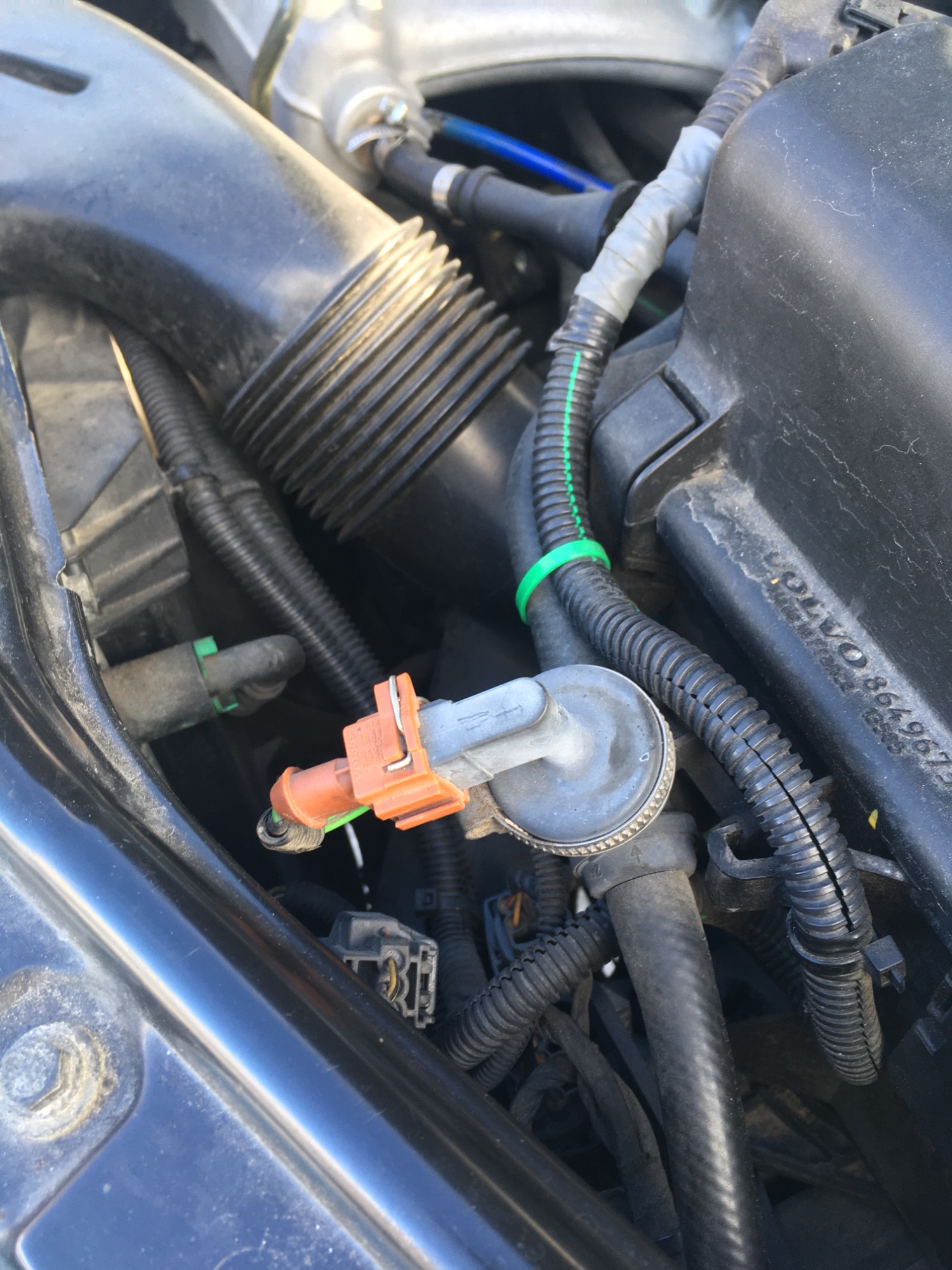

Oh, I forgot to ask, what is this fitting or valve upstream of the intake manifold? Between left headlight and turbo air filter box, orange-grey. I may have asked this before, and whether this is a preventative maintenance part.

https://www.fcpeuro.com/products/volvo- ... r-30744402
When it falls, vacuum pump works all the time until it dies.

Thank you! Would you hear that?

BlackBart wrote: 04 Feb 2023, 17:32 Thank you! Would you hear that?
Yes. Turn the key into position II, hear a quiet "zzzzzz"? That should normally stop in a few seconds.

Yep, I have that. I sometimes wait for it thinking it‘s the fuel pump pressurizing like some older cars do.

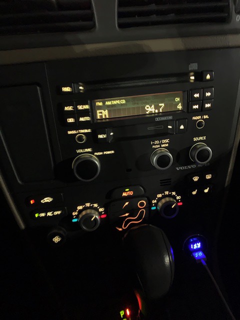

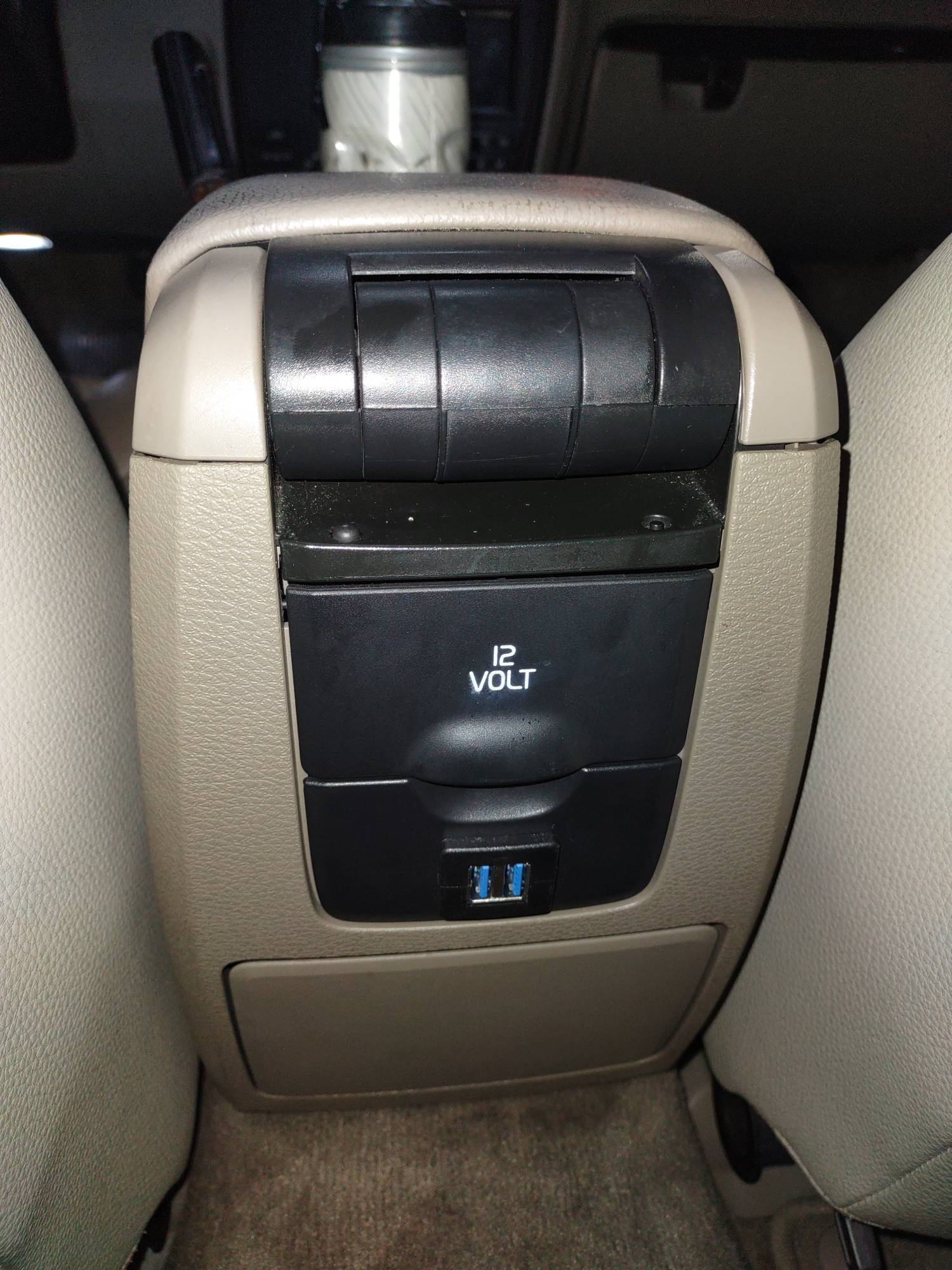

I got tired of the 12v cigarette charger falling out so I installed a USB dual port charger. I looked into installing under the HVAC controller, but there is not much room there. I also think having the cable coming from the rear is less messy up front and in the rare case I have someone in the back, they have easy access to the USB port also.
