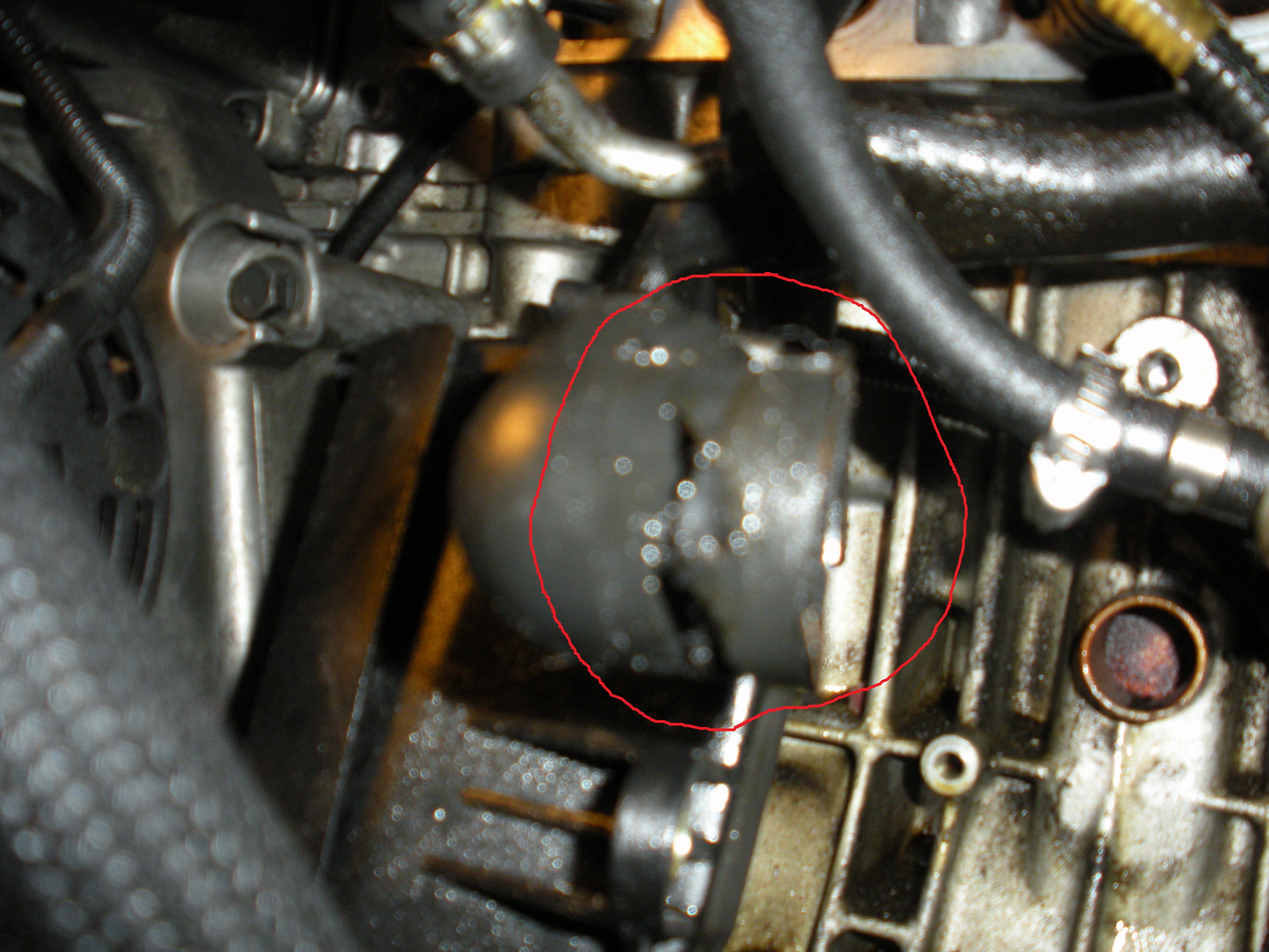

I replaced my PCV system about 5 months ago or so....Then I put in a heavy duty IPD CBV and solenoid for the turbo.....then I put in a new dipstick o ring + turbo drain seal+o ring, no leaks from either. Then I took the car for a ride....wooo....hoooooo...
Now I have oil all over the front of the motor...I pulled the fuel injector rail out and ther is oil sprayed all over the the underside around injector #3 counting form the timing belt side....and runs down the block and all over the oil pan...grrrrrrrr!!@&*@%
Any ideas? In am thinking it could be a bad connector on the PCV or blown hose ?? Maybe a connector I tightened too much?

Just curious, do you recall what brand that hose was?
