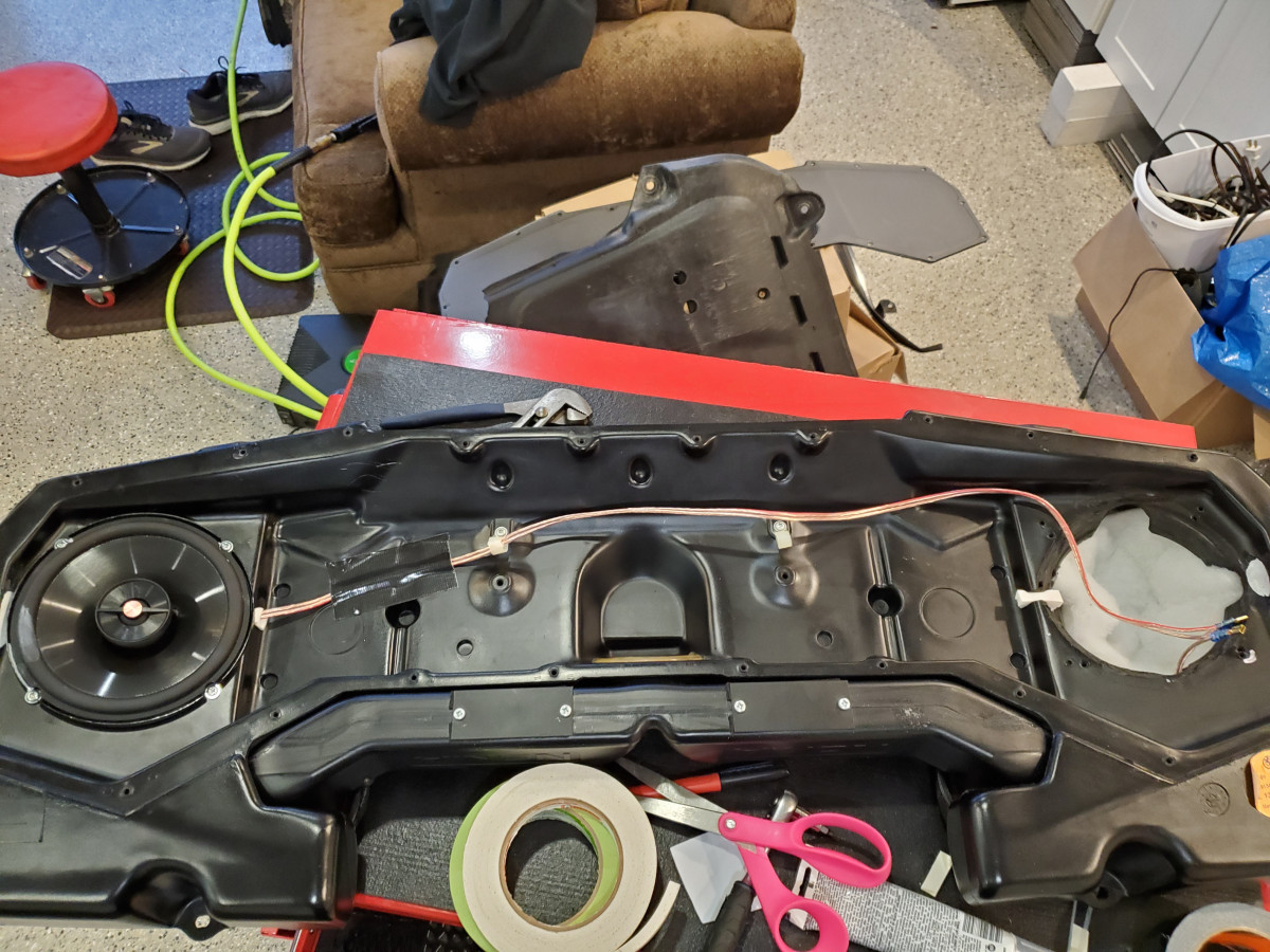

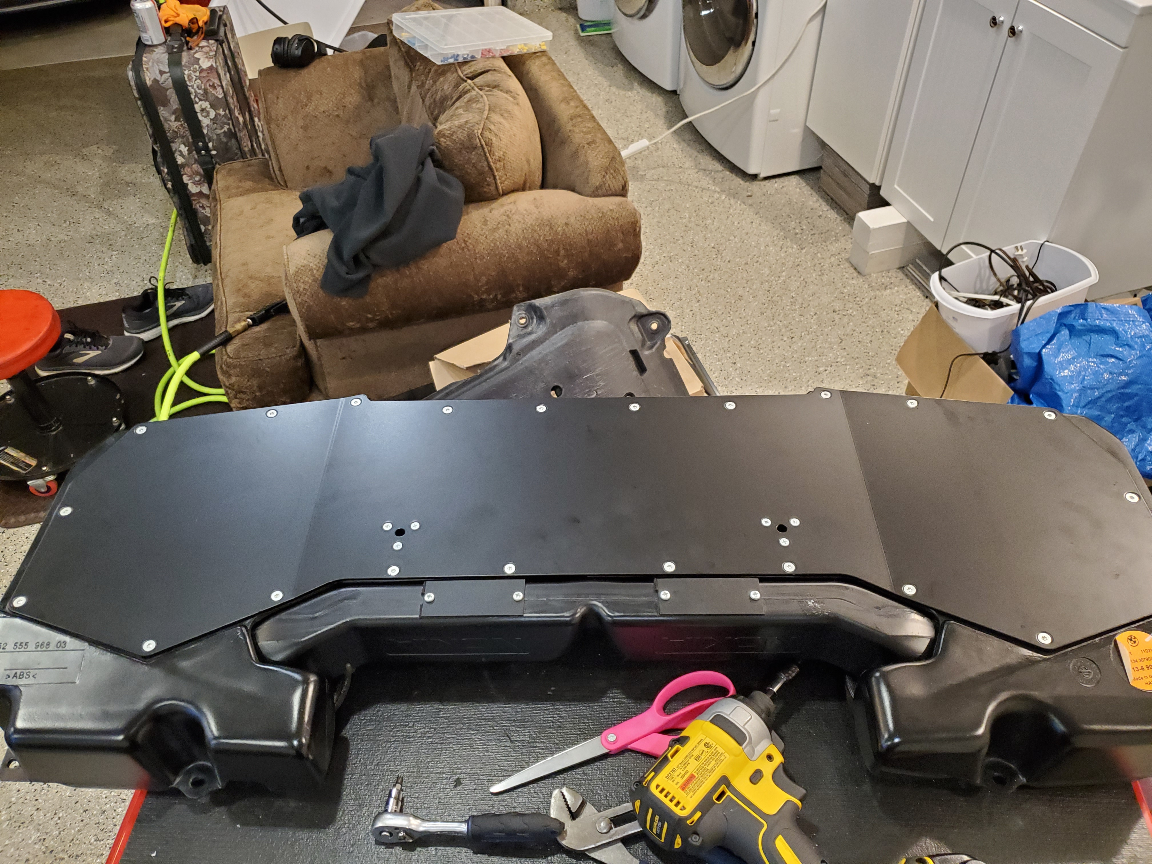

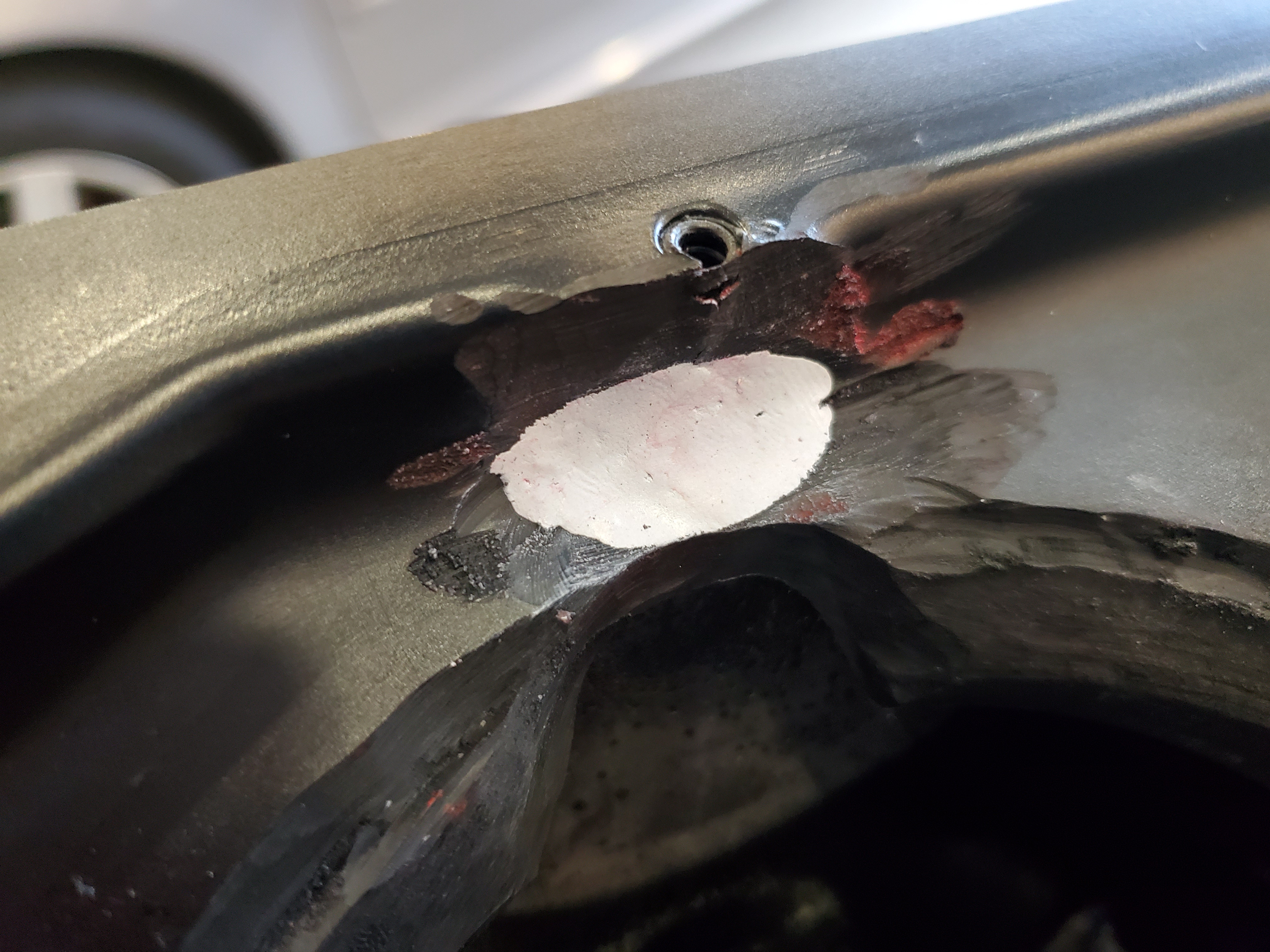

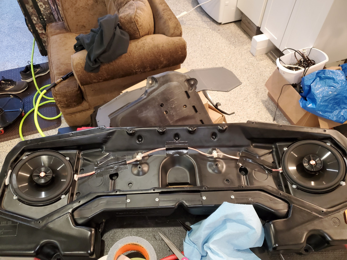

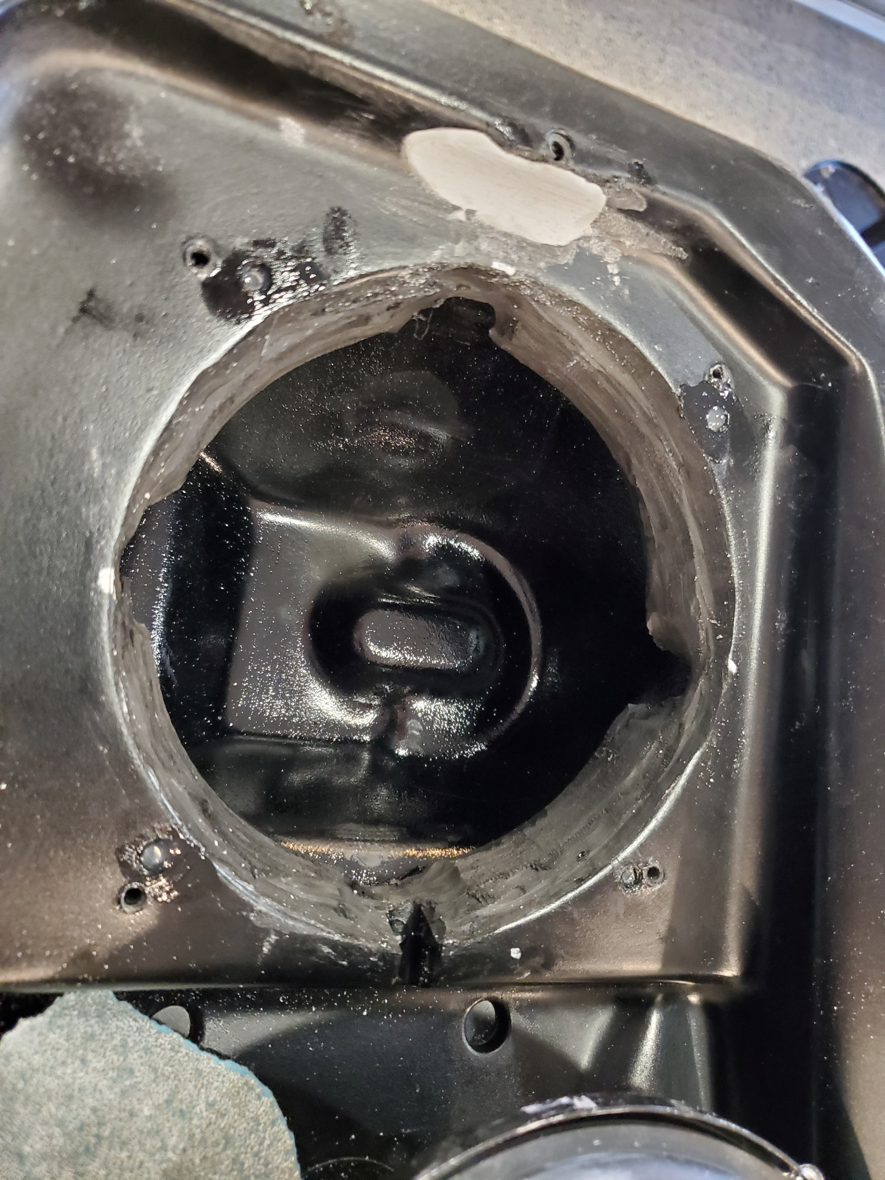

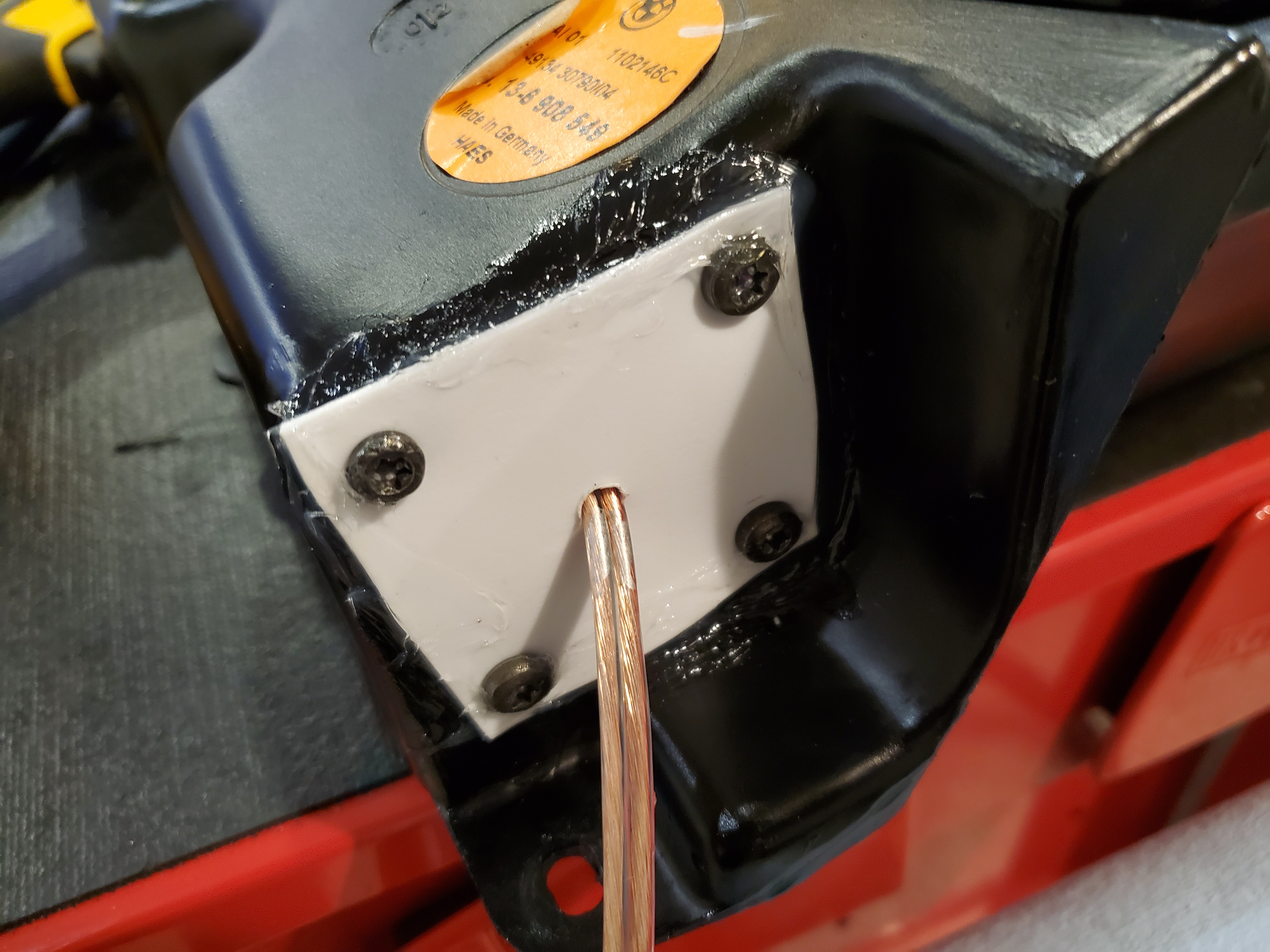

I reconnected and resealed my mysterious nokia/bmw bandpass box or whatever it is that i have. Patched up some holes i accidentally did when i Dremeled the crap out of it to make the 6.5s fit. Used jb weld plastic putty. Silicone and window sill foam tape has now made it airtight. I have really no clue what its gonna sound like. One internal 3" port leads air out to two 3" ports in the rear shelf. I parallel coupled the speakers so input imp is now 2ohm. At that imp my amp gives 150w. Like i said, no idea what the heck this will sound like.

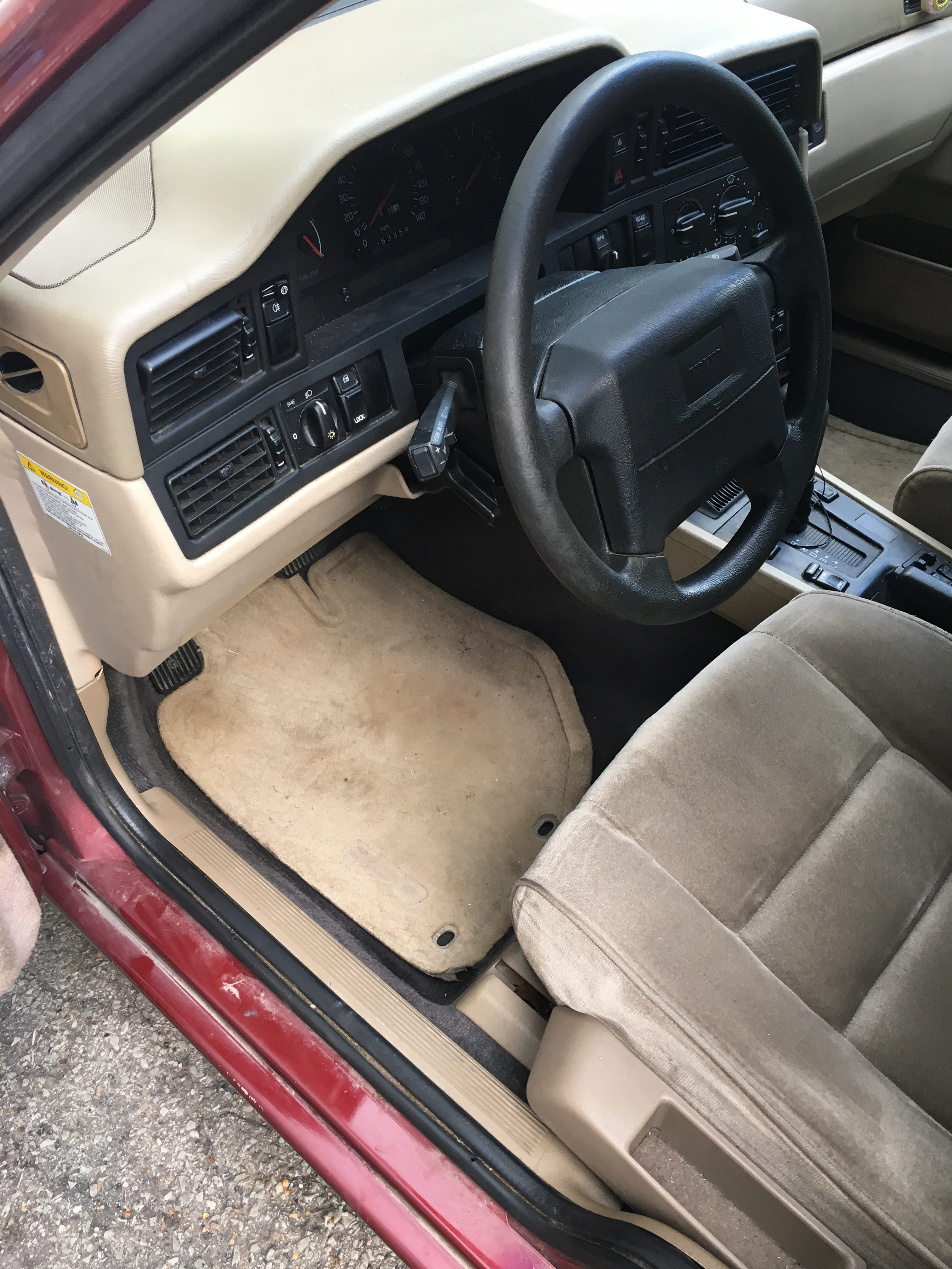

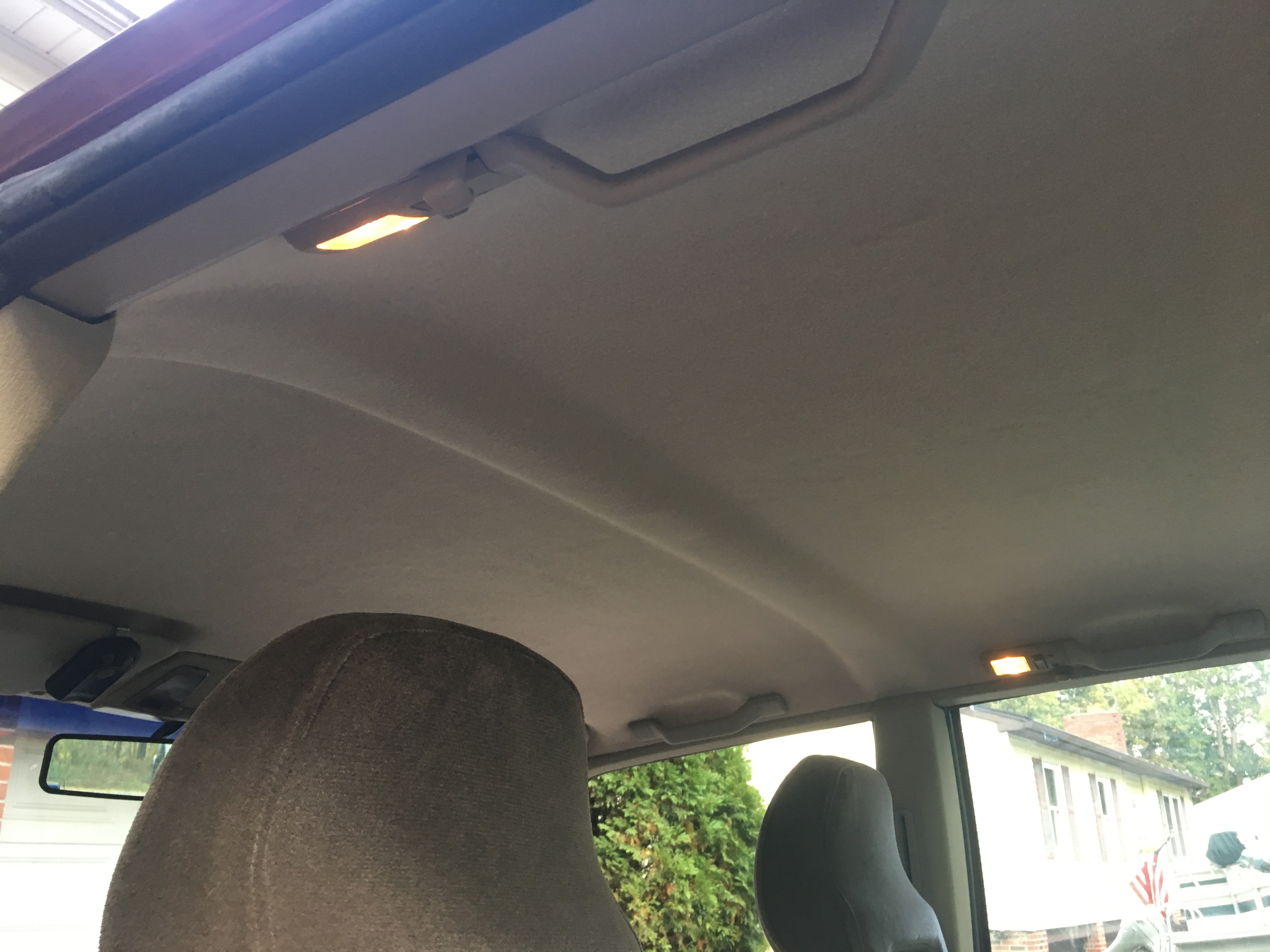

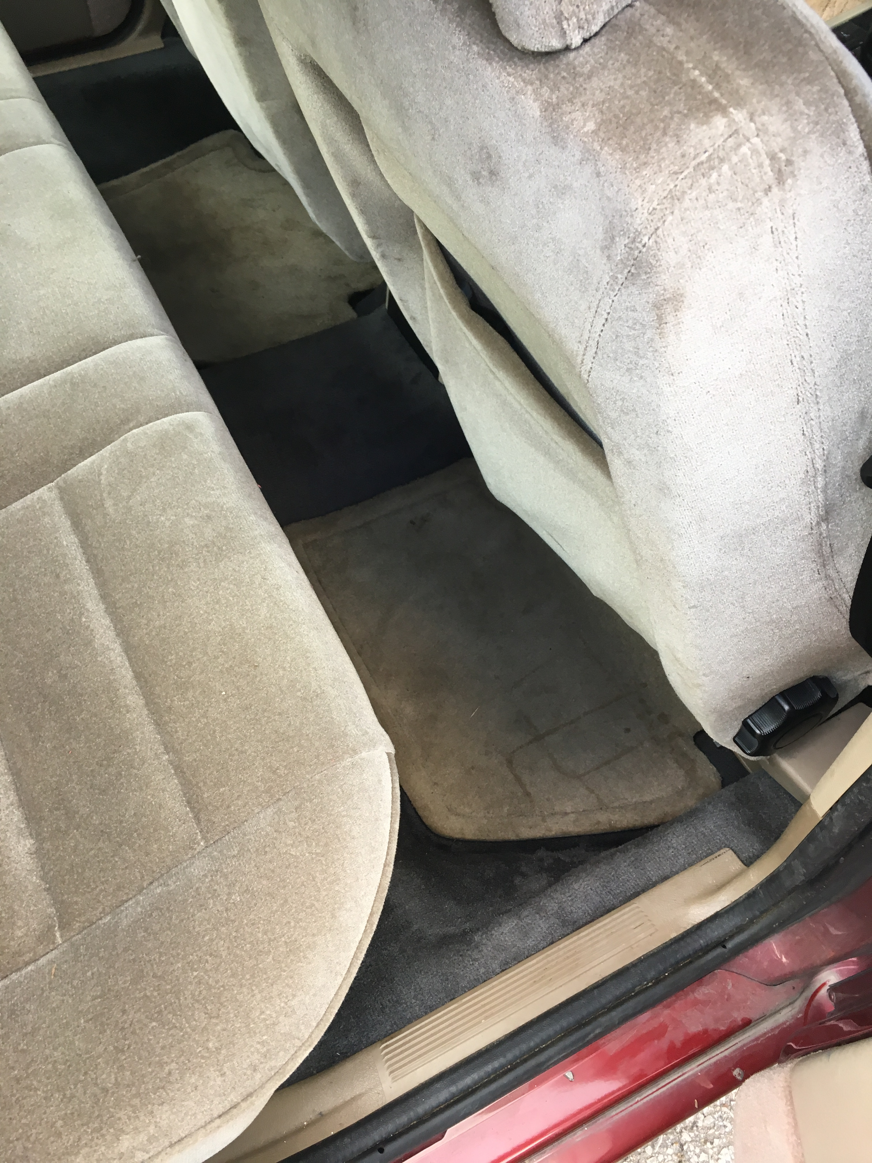

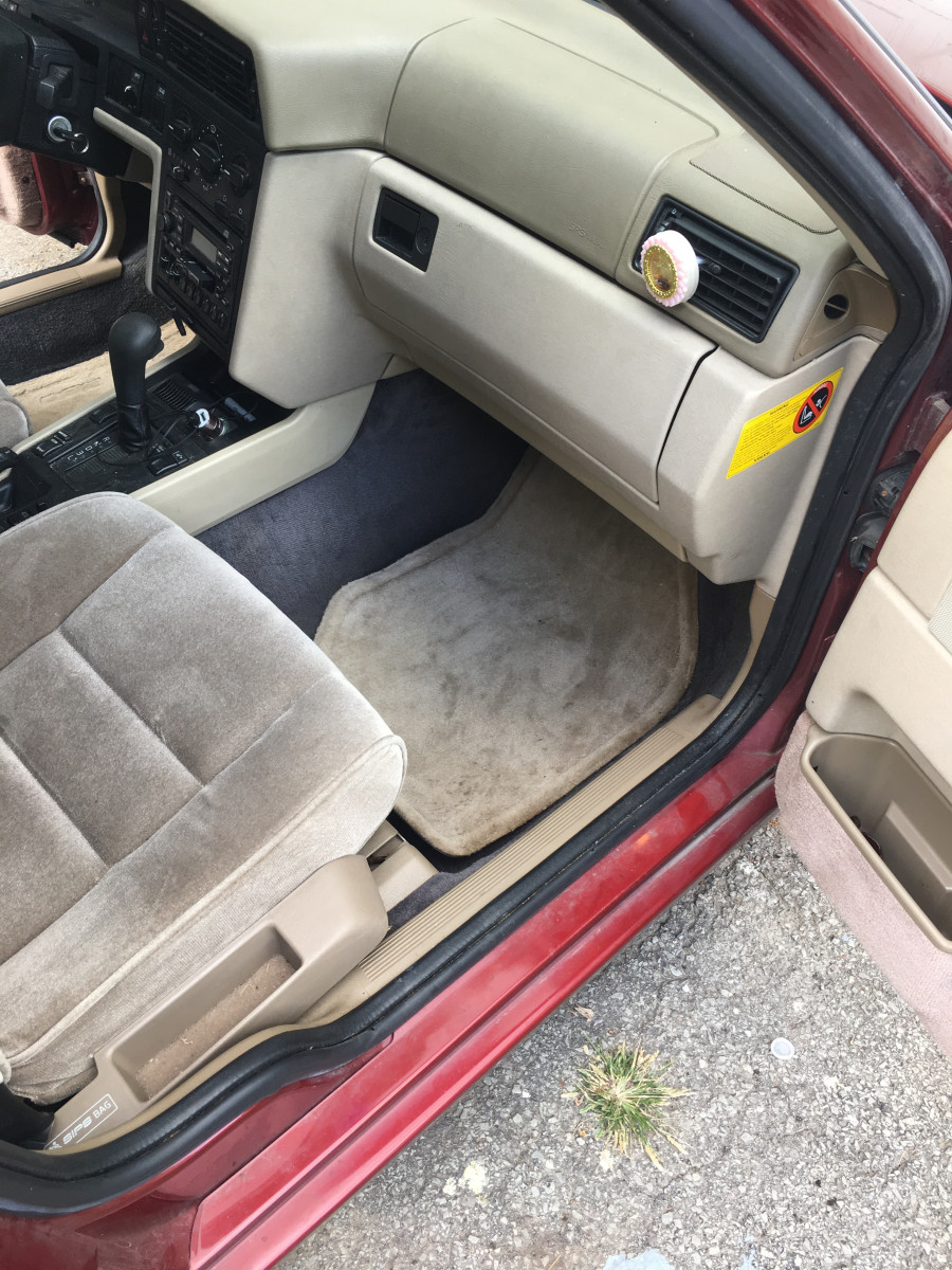

Pick a part yard near me finally got an 850 in so I went pickin’ over the weekend!

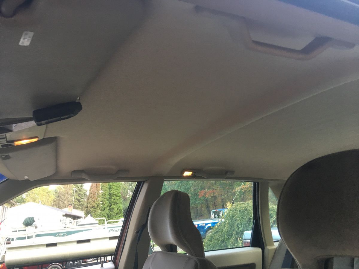

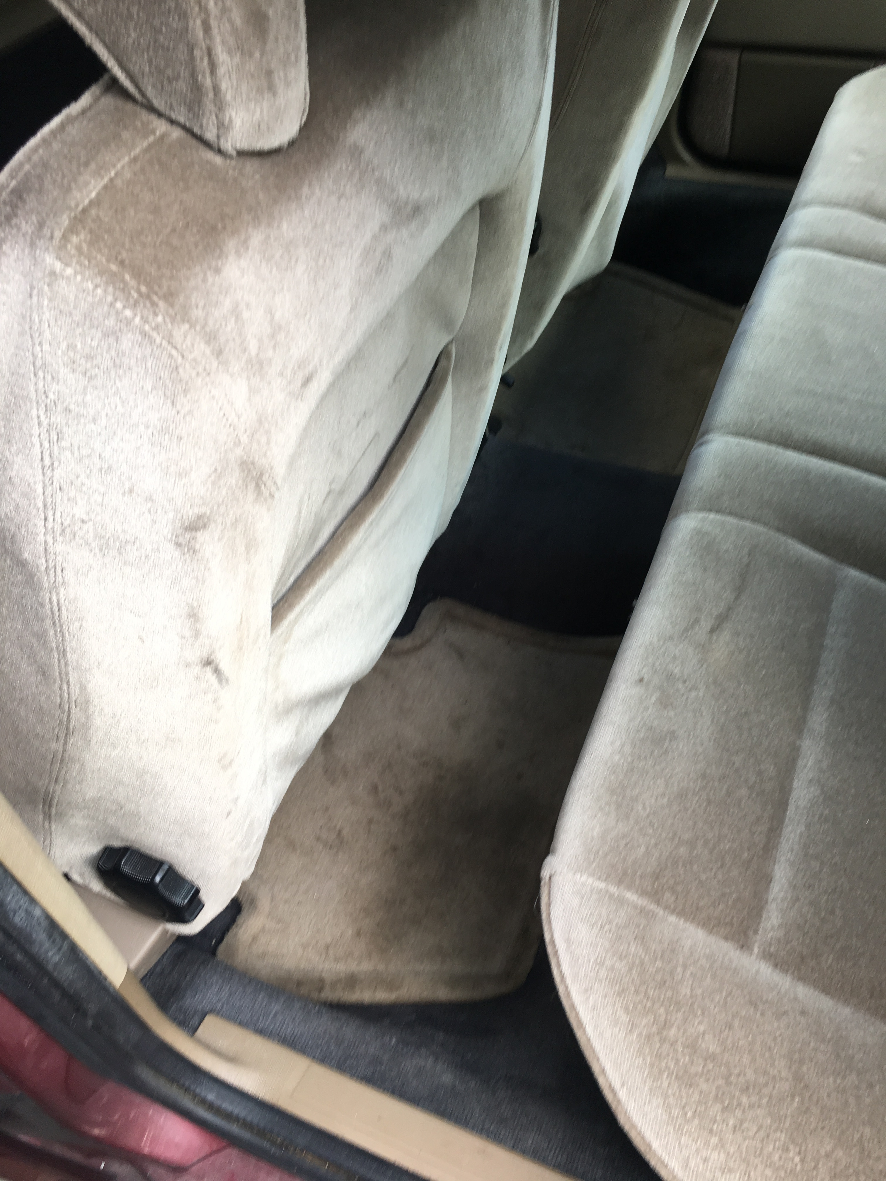

Got a nice set of gray carpet and parts to fix the cruise control (module and vacuum pump). While I had the seats out of my ‘96 850 GLT to replace the carpet I redid the headliner too. Gray carpet actually looks really good even though the original was beige. Ties in nice with the black in the dash. Cruise now works when I lift up on the brake pedal. Had nothing before. Tried adjusting the brake switch but still have the same issue. Going to head back this weekend and pull that switch also.
Put a lot of work into this car over the last year and a half I’ve owned it but it has been one of the easiest cars I’ve ever worked on. Been a joy to bring her back to life after being neglected for years before I got her. Luckily she was low miles at around 55,000. Now she has 63,000 and climbing.
Added photos

How is it?

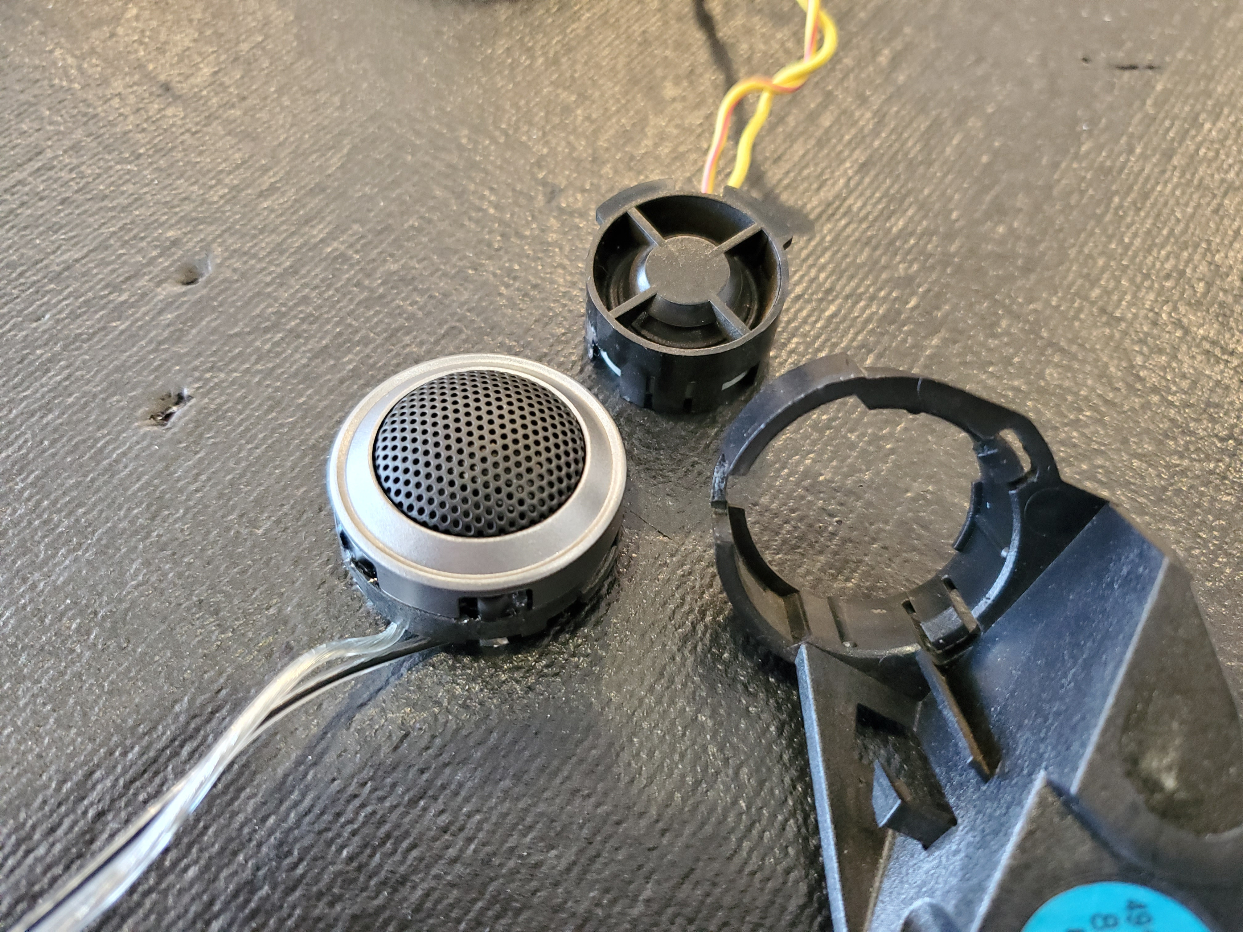

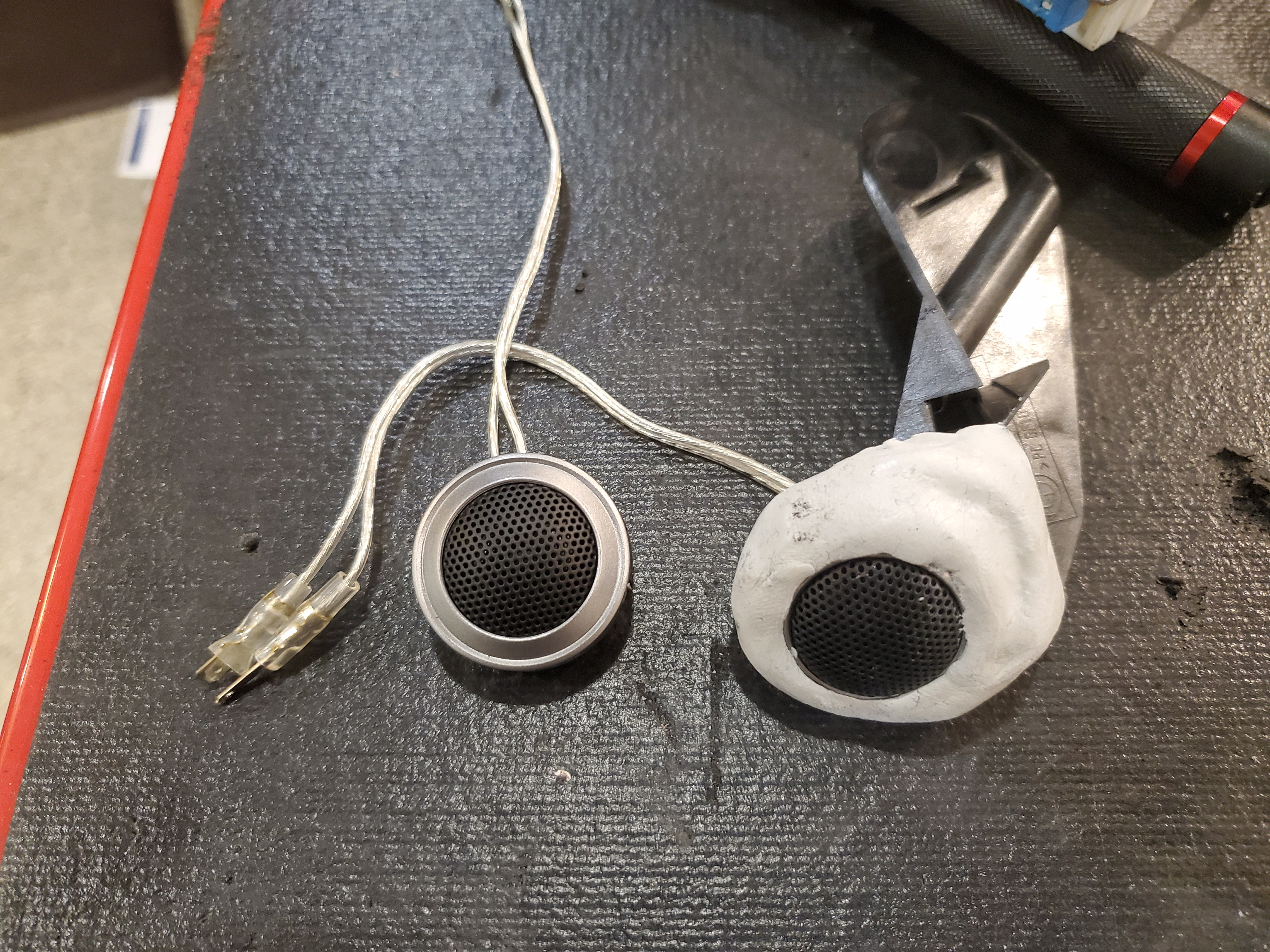

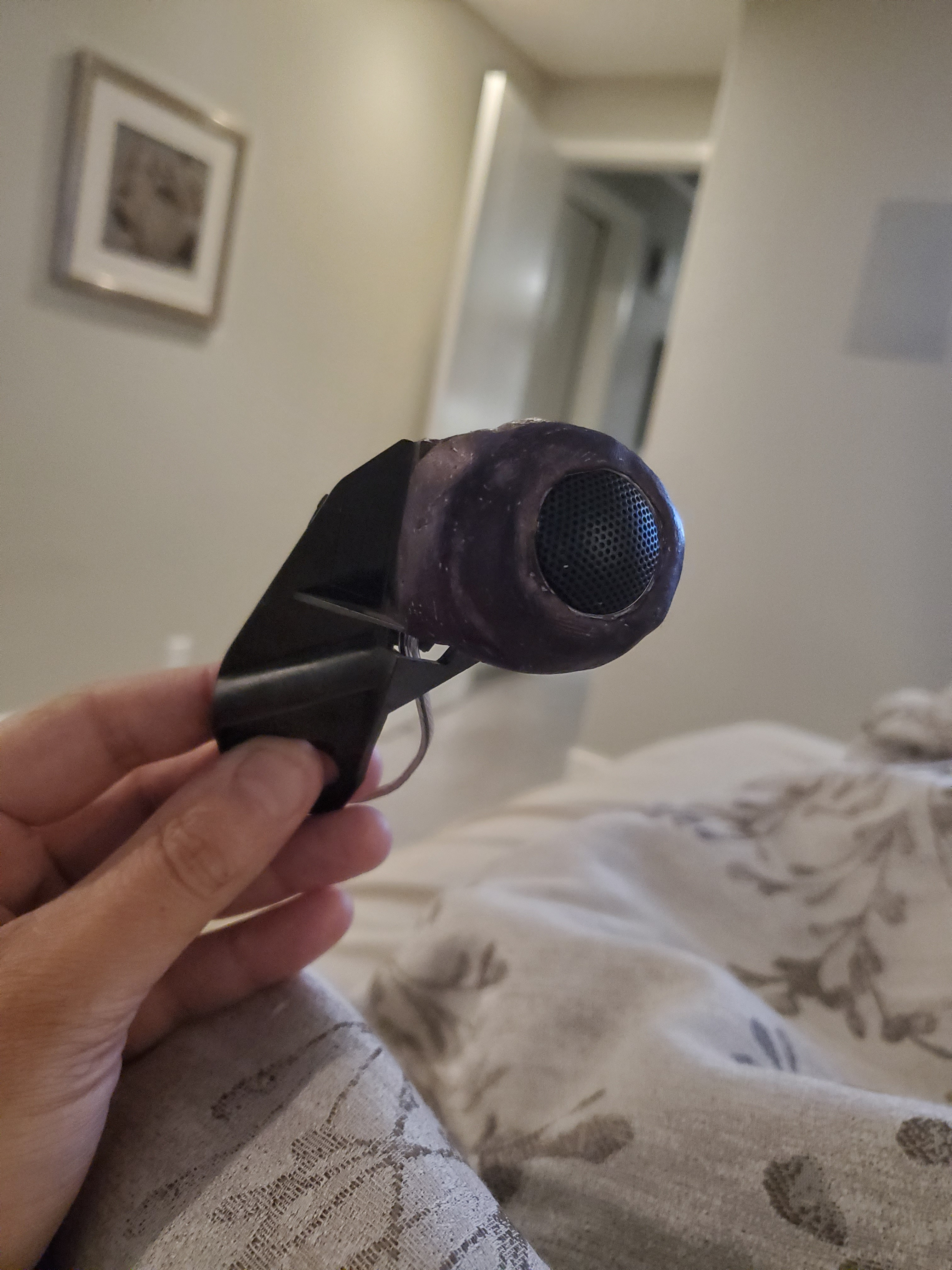

No idea yet. Its going really slow this stereo build. Yesterday i modified a tweeter bracket... it takes time...
