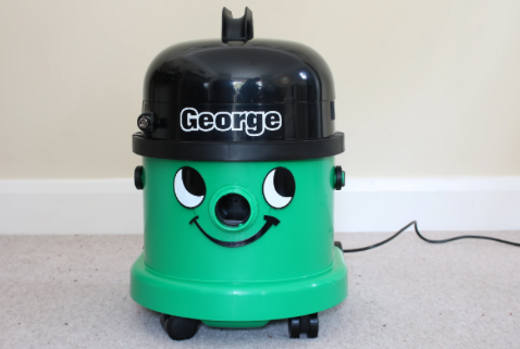

The interior of the V70 looked reasonably clean but there were a few marks on the carpets I needed to address so George was pressed into action
I had to get creative when drying the carpets

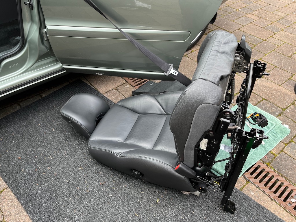

Passenger seat had to come out to allow access to the spilled substance that was lurking under the rails
Doesn't look bad in the pictures but it was rather disgusting
The carpet snail had it dried in 15 minutes

Very nice. Is George the little green robot vac?

BlackBart wrote: 04 May 2023, 08:52 Very nice. Is George the little green robot vac?
Yes George is a Wet & Dry Vacuum cleaner

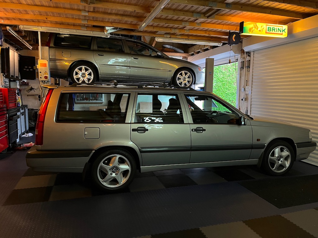

Wherever did you find a 2/3 scale model that fits perfectly on your roof rack?

Post by P80GLT »
@ Blackbart
The 850 is tougher than it looks
Maybe next time I'll park the 850 under the ramp with the V70 above and photoshop the ramp out :shock: :D

Post by vtl »
P80GLT wrote: 04 May 2023, 11:31 The 850 is tougher than it looks
This is a manufacturer recommended way of parking Volvos!

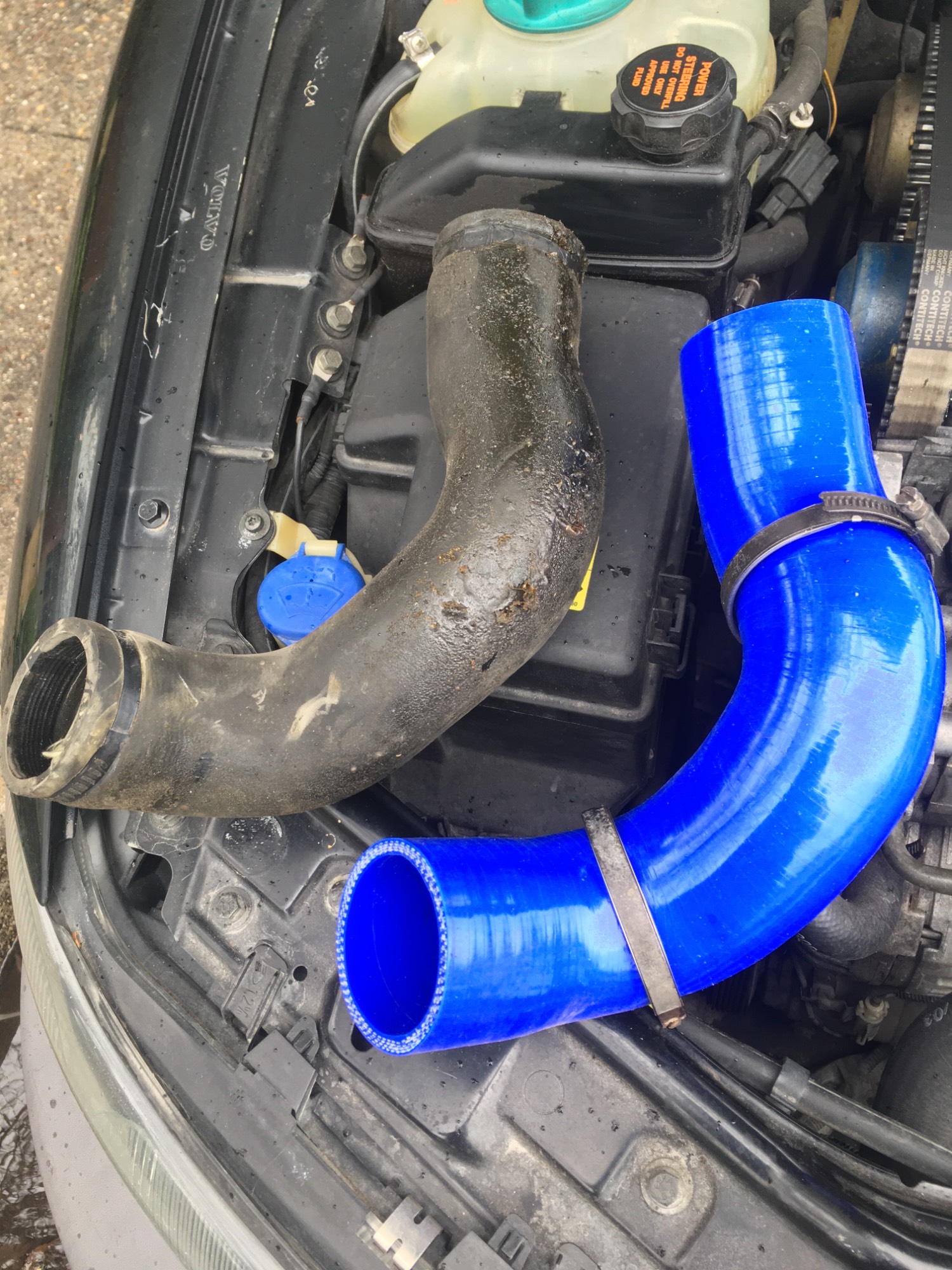

I replaced an intercooler hose with a new I had in the box - must have been on sale, not sure why I bought it. But the old one was rough and very soft.

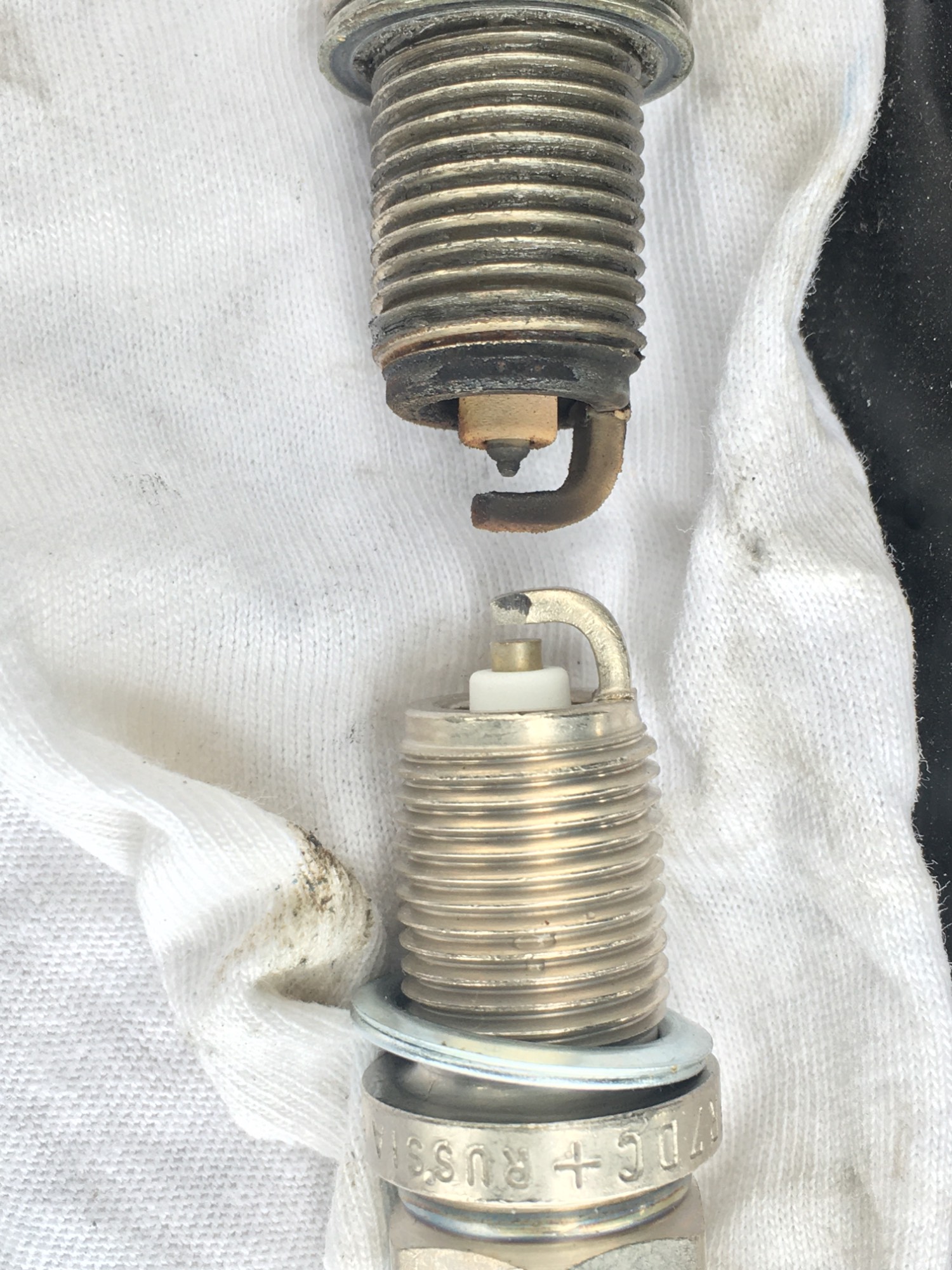

Swapping in new Bosch coil packs.
Found new spark plugs in the box, so I’m doing that now. But I have a very basic question -
The olds coming out are BERU (France) 14-FR 7 DPPUS2. They are platinum with the tiny electrode.
New Bosch (from FCP) are FR7DC+ (from Russia??), traditional electrode.
My handy Hanes book tells me an
FR7DPP gets a .7mm gap. (This a platinum) https://www.ipdusa.com/products/8273/Pl ... 661-109207
An FGR7 DQE 0 gets a 1.2mm gap. Isn’t this a 4 electrode design?
Should I use .7mm with the standard new ones?
