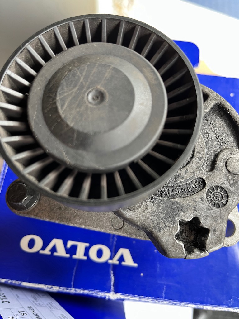

When doing the power steering fluid flush a couple of days ago I removed the serpentine belt to check the tensioner and when spun it sounded rough therefore needed changing sooner rather than later.
I'm glad I did decide to change it as there was only the one bolt at the bottom of the tensioner holding it on, the top bolt was missing which I can only assume was from when the cam-belt was changed. It was the original tensioner dated 2005 and I suspect the original belt so at least I know they are now good for another few years

Looking at the old tensioner the T60 Torx fitting has cracked, I'm glad I managed to get to off before it split wide open

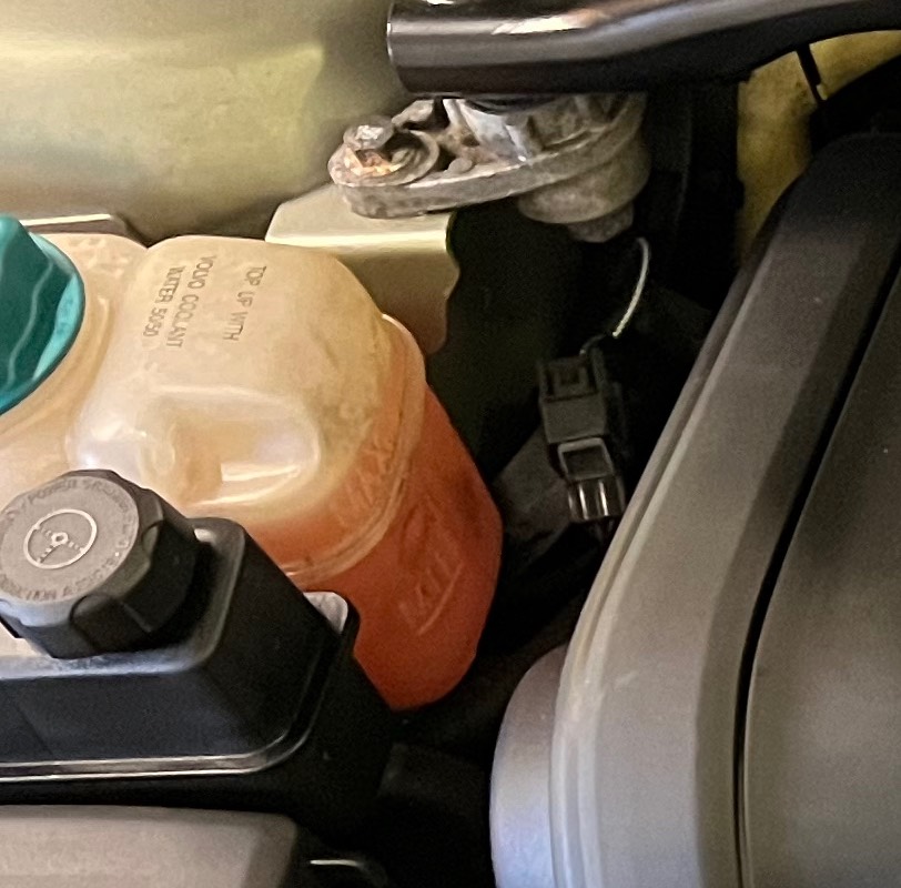

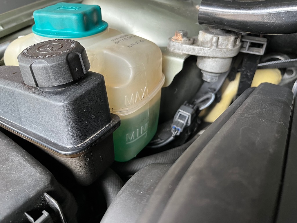

Never a good sign when it's a red/pink colour in a Volvo
System flushed 5 times with soft Scottish water, (if it's good enough for whisky manufacturing it's good enough to flush the Volvo) 2 times with de-ionized water then filled with 4.5 litres of Volvo concentrated coolant
