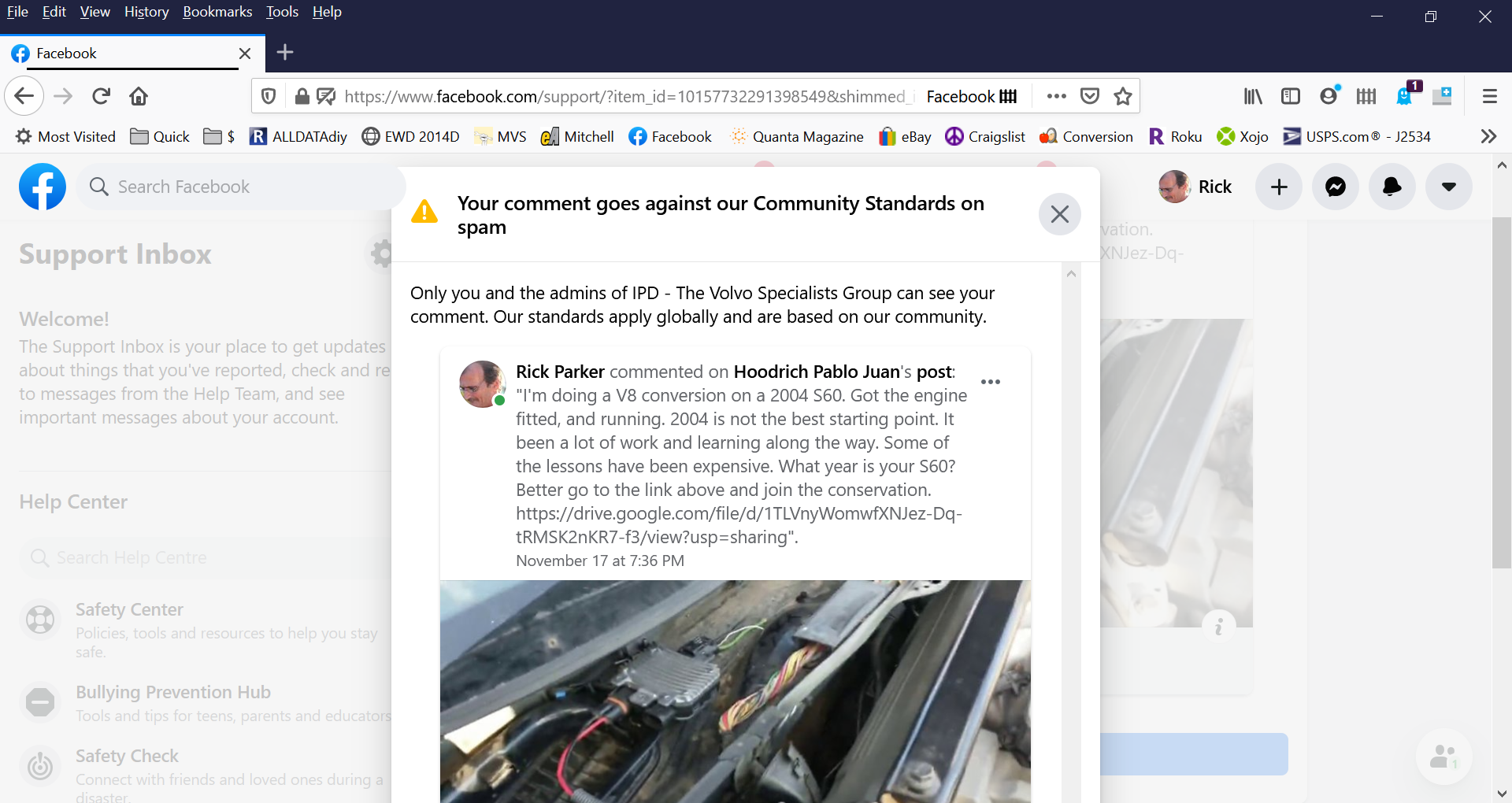

What got up the IPD+ Facebook manger's rear? They block this post. No statement on why they consider it as spam.
With an attitude like this FCP euro's ranking goes up. This is not the first time I got a shitty response from one of the IPD staff members.
