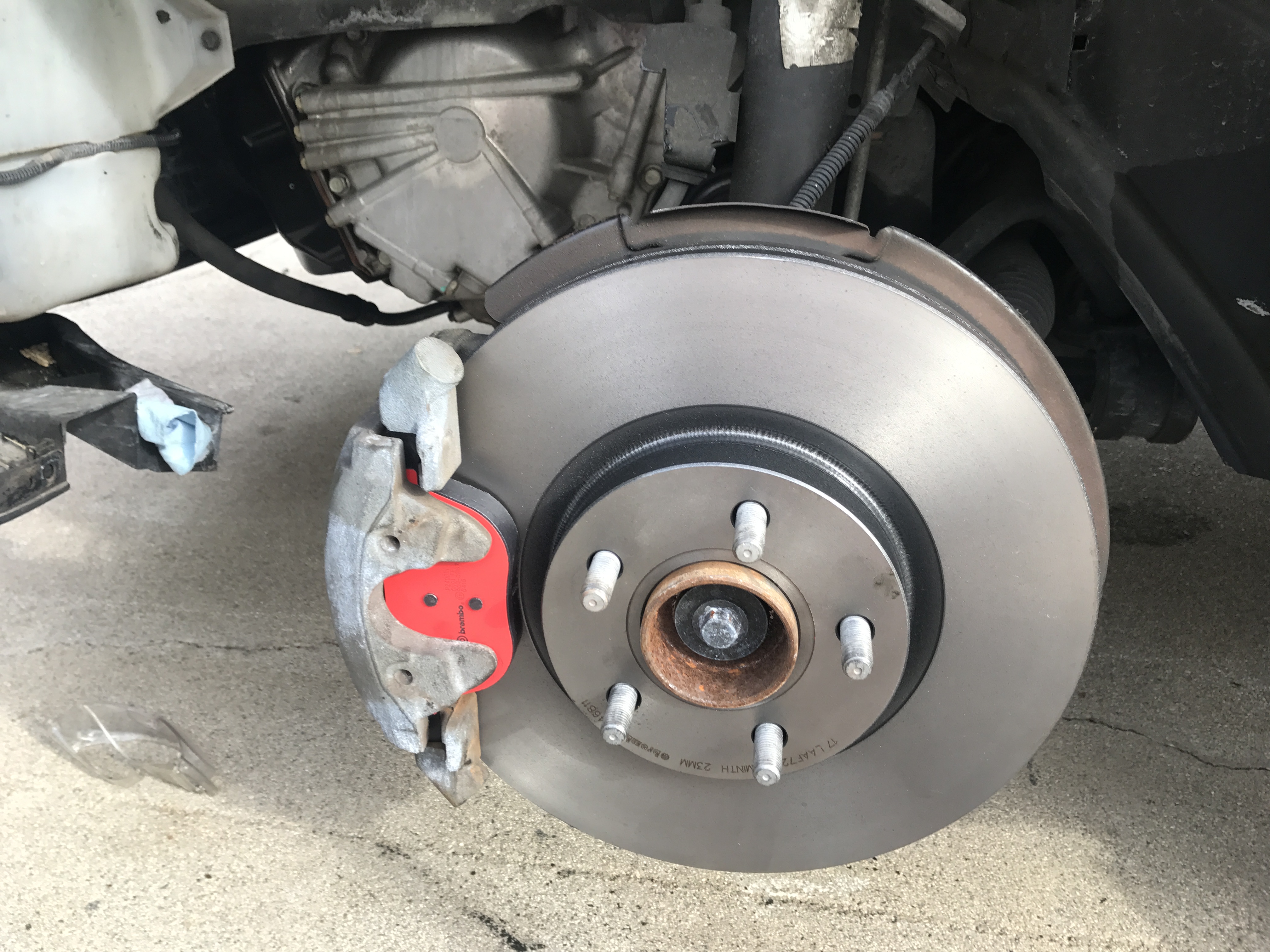

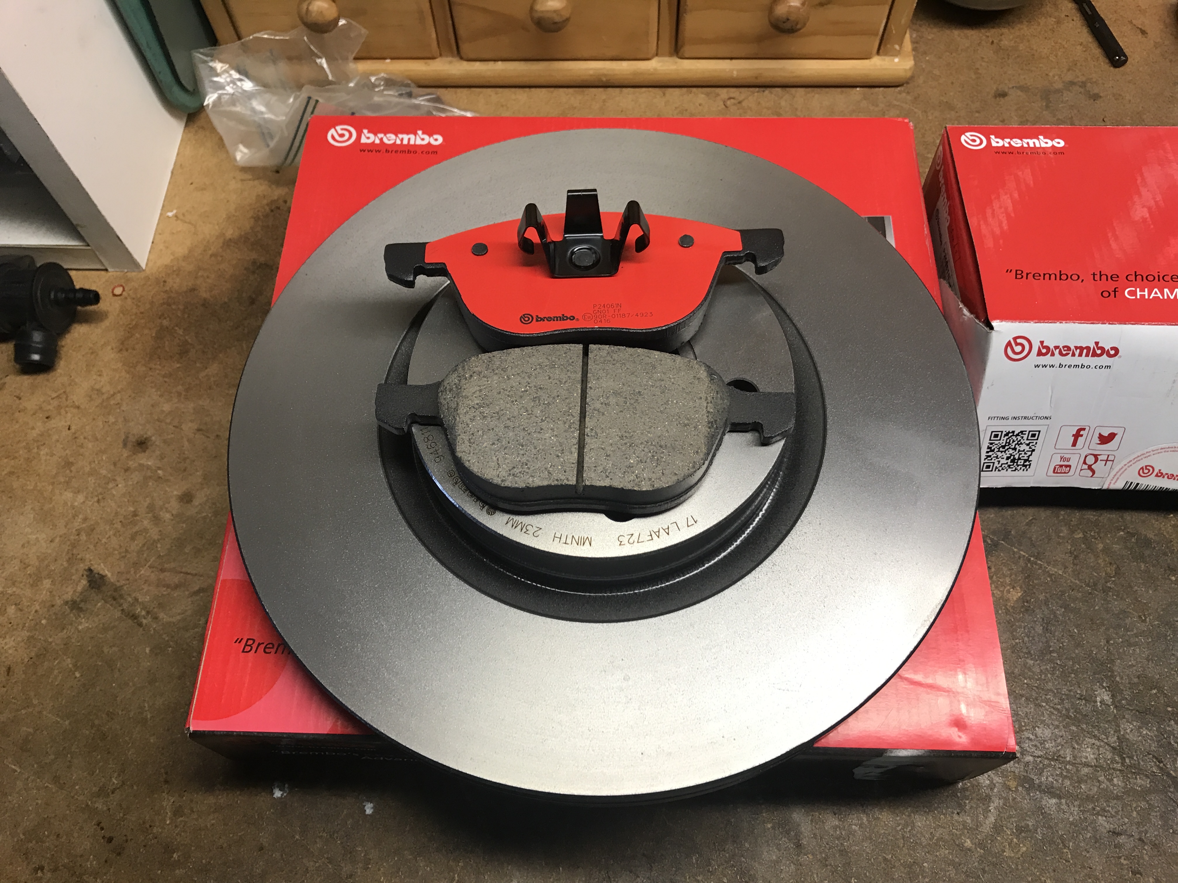

I love the look of new rotors!

Yeah they are cool looking. I have one spare here but it got a little rusty. Boo hoo

Where is the protective brown coating on your suspension system?
