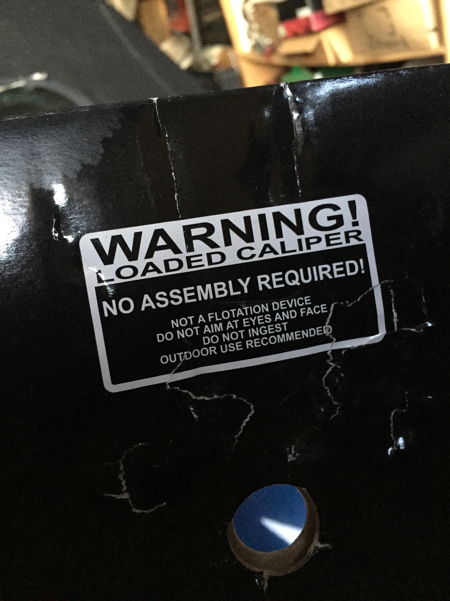

Wow, those are really important warnings... I don't know what you would do without them! Brave soul taking on that job!
