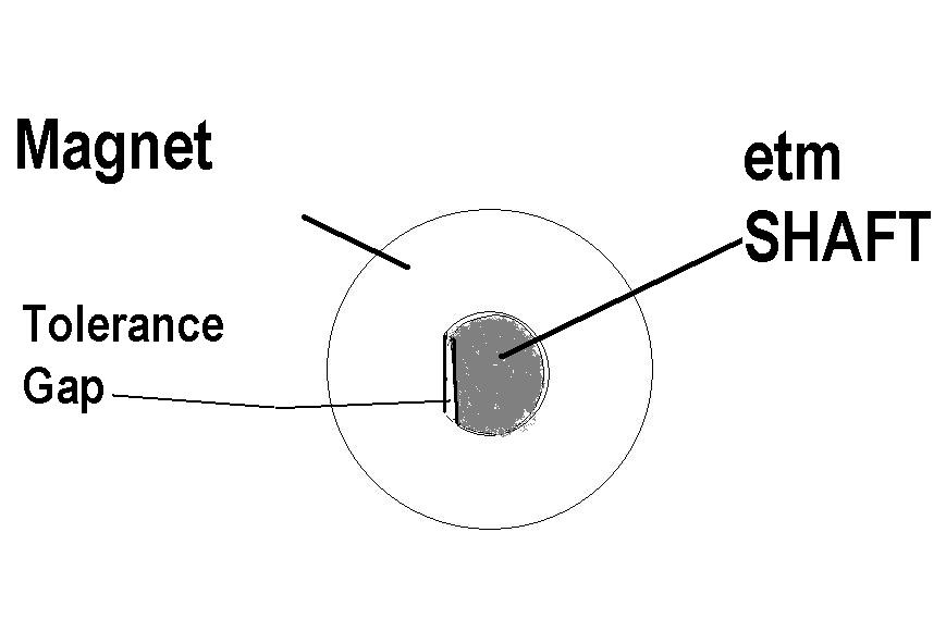

Pic shows a magnet turned clockwise in relation to the shaft. This would result in a very low voltage such as your 1.18V Notice the flat sides are not parallel.
There is around 0.3V adjustment either way; enough to stop the throttle from working at all.
